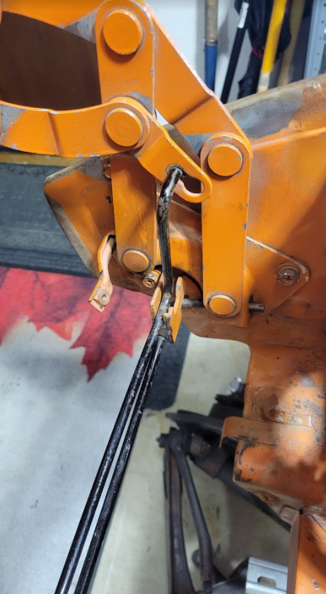

The hood hinge torsion rods should be black, so I would assume they were off, when originally painted. Here is a pic of my 7/70 car, there is no evidence of overspray on them, not even the ends. Never been painted under the hood.

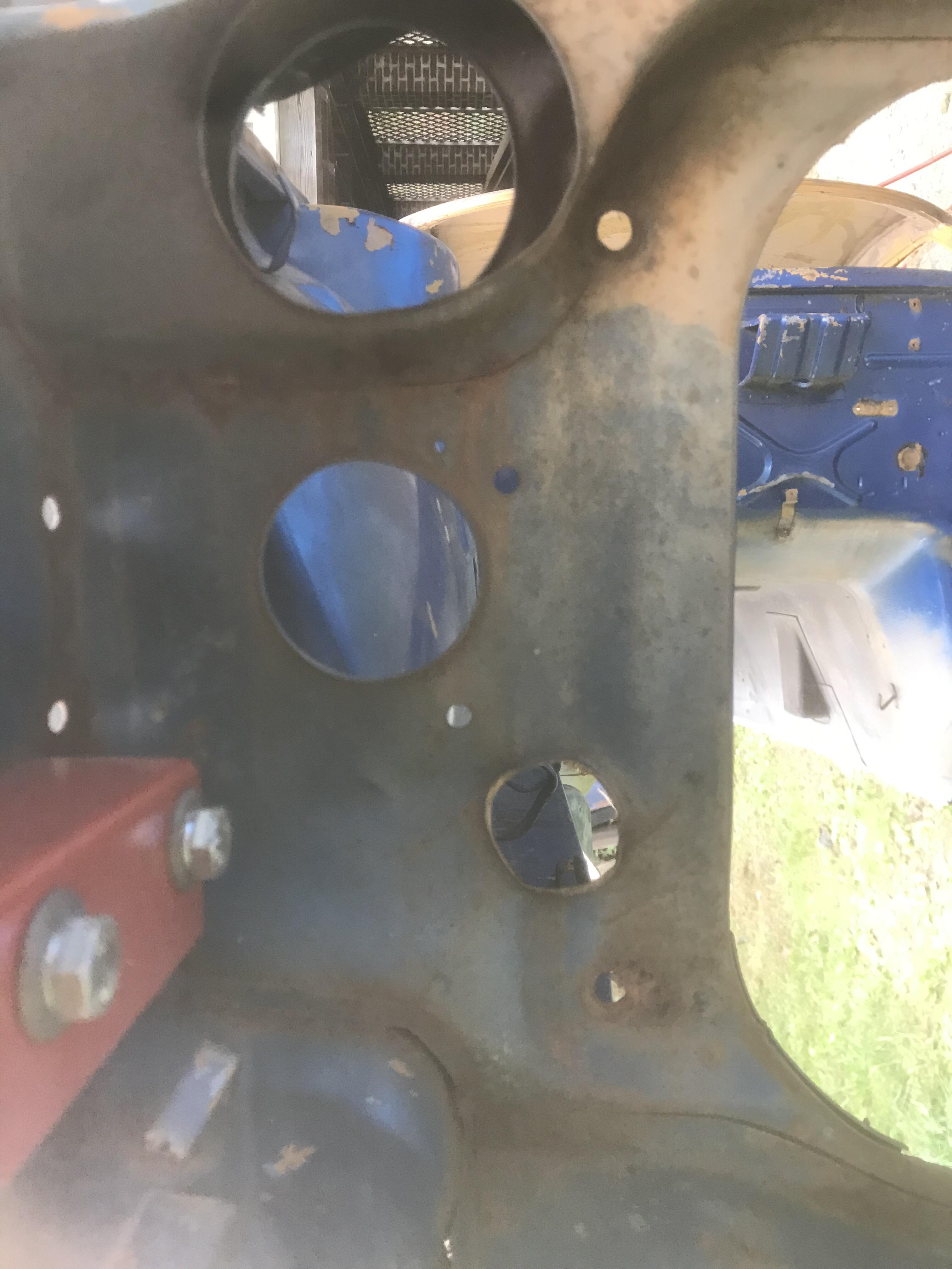

I am no expert on this at all, but I remember seeing a post about parts of the front of the radiator core are black in some areas. Might only be on early cars.
Something like this pic I stole from the web.
This is what I have on my Z, and I have seen many other similar patterns.  They seem to just blackout the area directly behind the grille.

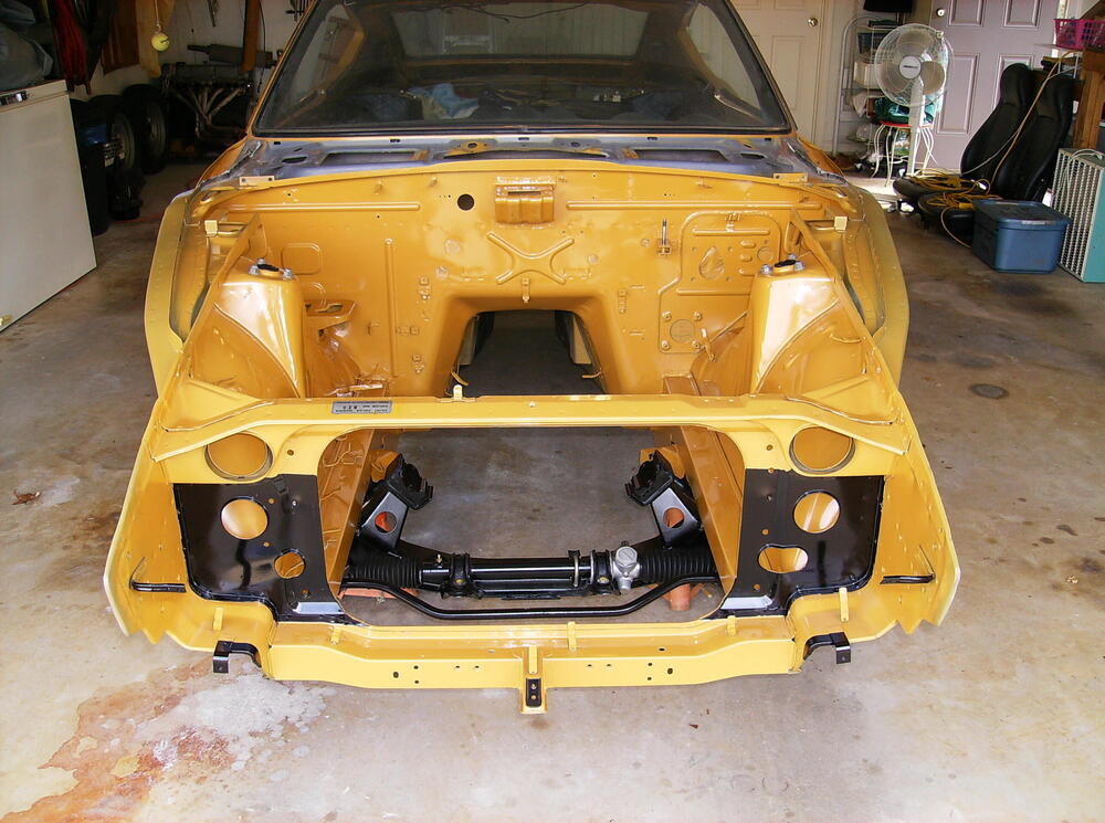

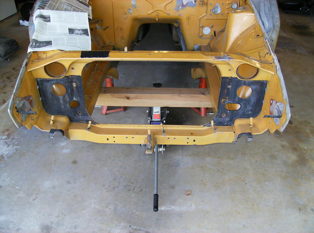

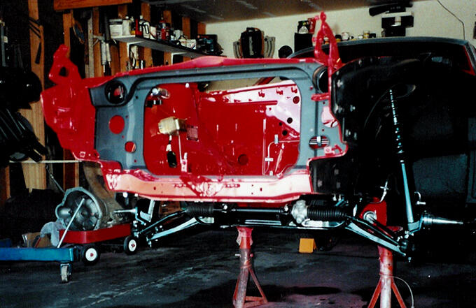

Nissan brushed on some almost flat black paint on the front of the radiator core support so that color would not show thru the grill. Here is my car before paint and after. Note that the five mount points for the grill are also blacked out. I used gloss black to make it easier to clean.

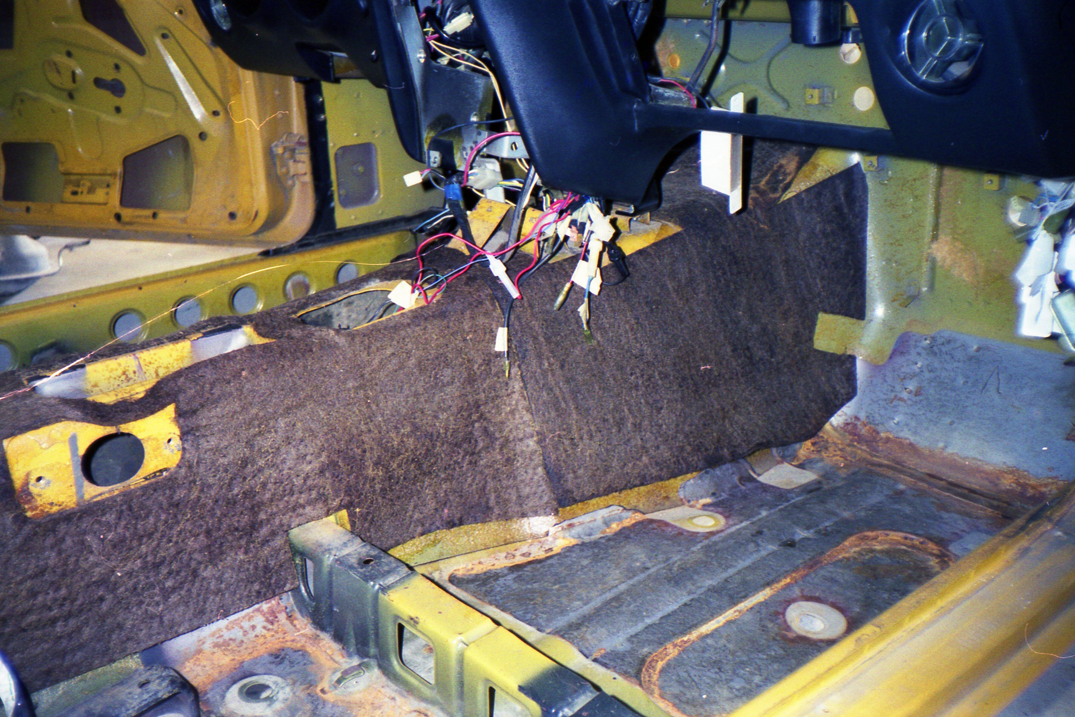

BTW - Nissan also did the black-out treatment on the interior at three locations: (1) along the A-pillar and inner rocker so color would not show along the edges of the kickpanel; (2) along the B-pillar and inner rocker for the dogleg panel; (3) tops of the seat support brackets.
Have you also got pix of those areas?

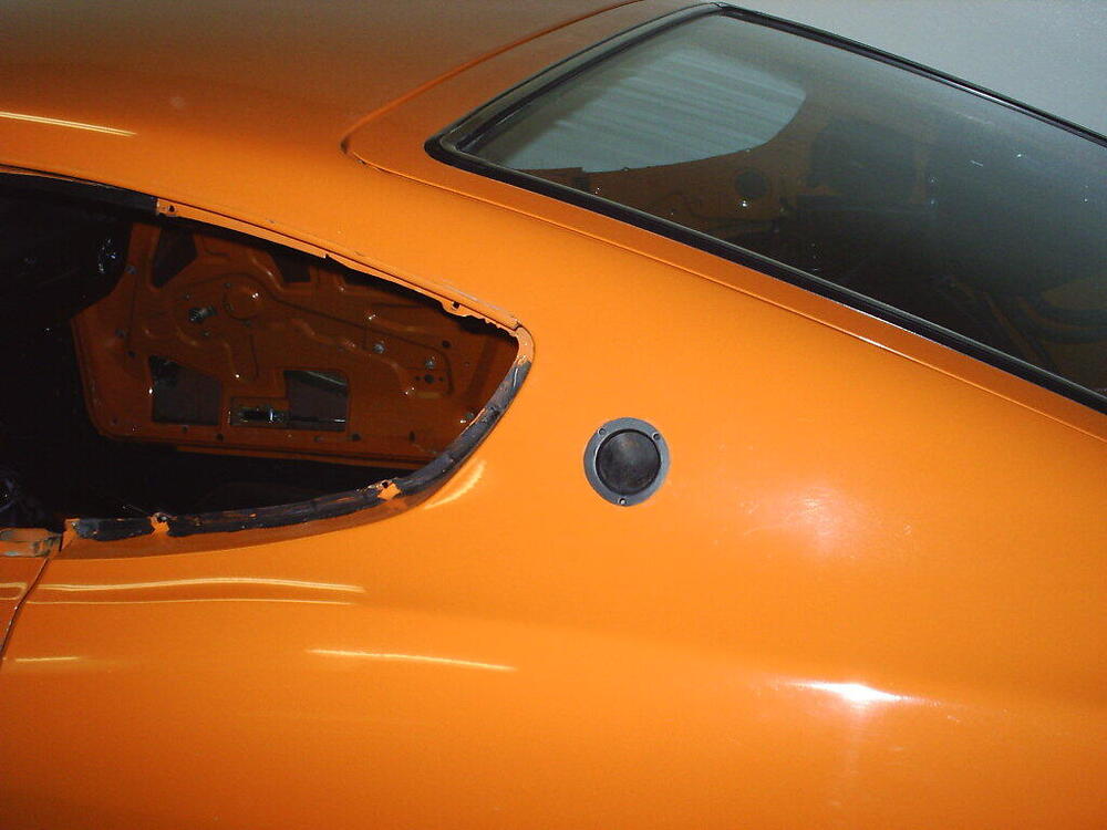

When restoring my original 11/71, I discovered some black paint was applied on the lower edge of the rear quarter  window body panel.  Of course, later series cars received paint behind the "Z" emblem as well.
