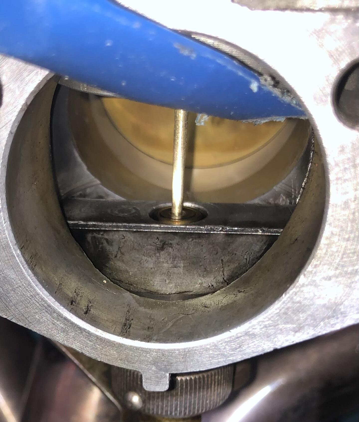

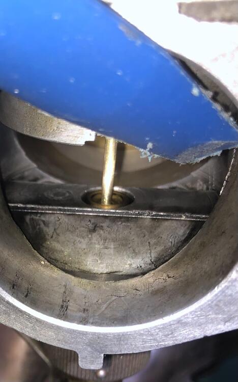

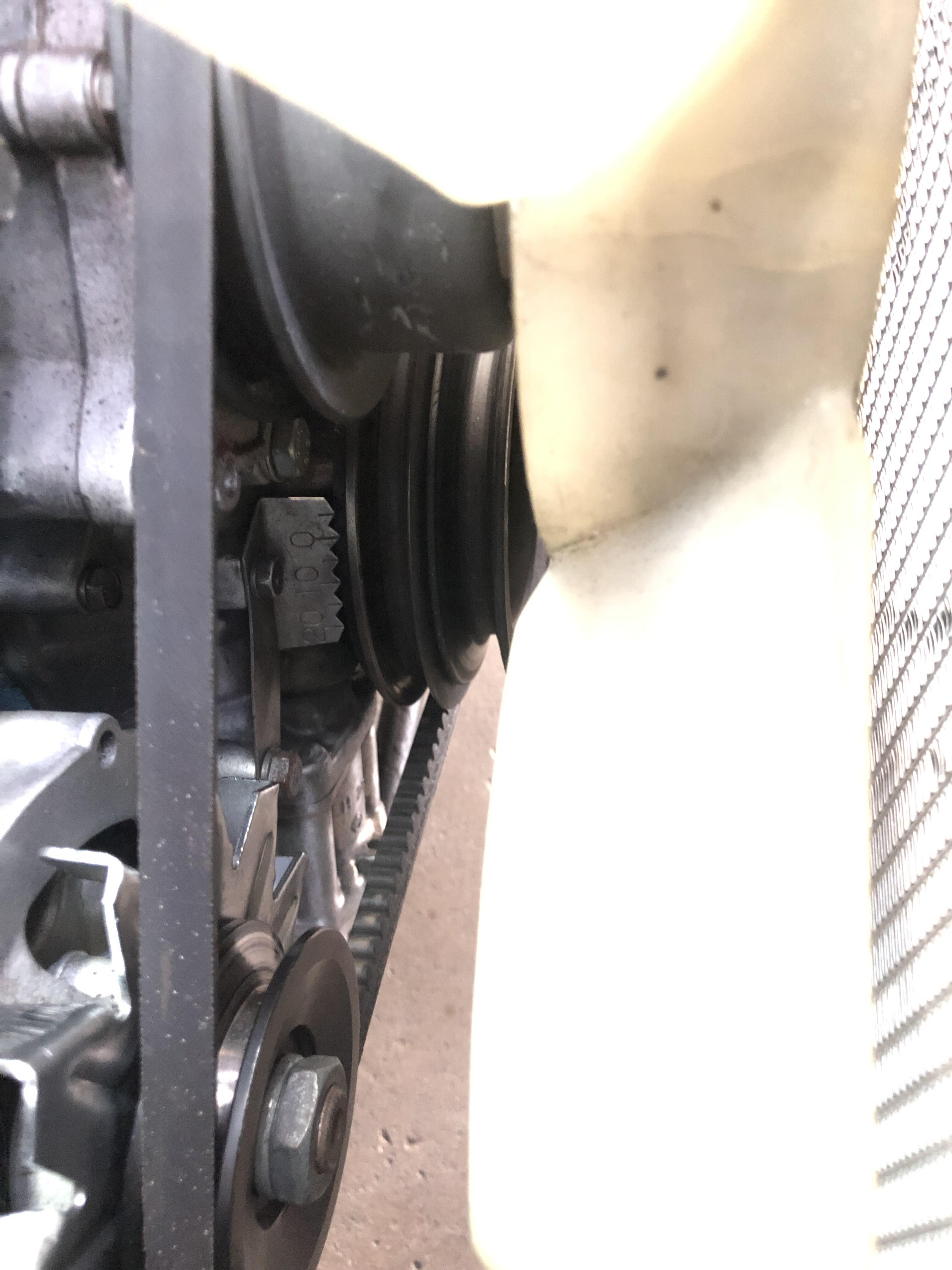

I have an L28 in my 71 240Z.  It's carbureted and using points ignition.  I attached photos of the the jet all the way up and all the way down.  Also a pic of the timing scale.

 There's a few possibilities. The nozzles could be partially down due to misadjusted choke cables, misaligned choke linkage or sticking nozzles. The next possibility is the float levels are too high. The easiest method for checking the float levels I've found is to remove the domes and pistons. raise the nozzles to their top position (0 turns) and lower the nozzles 9 1/2 to 10 turns. If you want to be precise 9 5/8 turns down, that puts the fuel level 3/8" below the carb bridge. The fuel level should be close to the top of the nozzles but it doesn't have to be exact. Raise the nozzles back to 2 1/2 turns down for a near stock engine at near sea level.

 The choke cables can remain disconnected unless you need the choke for starting the engine. There's a flat bar linkage that attaches to the nozzles that pulls them down into the choke position. Pull the nozzles down using the choke linkage and then raise them back up using the linkage. If the nozzles don't go back up, lube the nozzles and try it again. If they work fine and aren't sticking check the float levels. If the nozzles still don't return, check the mating surfaces of the flat bar linkage. Often times the linkage piece need to be twisted to align the ends with their mating surfaces. Unfortunately, I've not been able to check the alignment of the linkage piece or straighten it without removing the carbs.

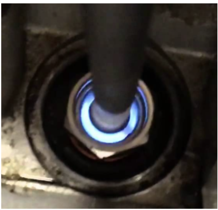

I'll mention this too. If you rebuilt them with the newer needle valves and adjusted the height like the DVD shows, upside down at 5/8", your floats are off and starving the carbs of fuel. There's a bunch on here about that and I'll help find the threads but 1st off what does yellow mean on colortune?
For the Colortune I can only get to Yellow no matter how far I turn the knob:
Yellow    Indicates a fuel / air mixture which have excessive petrol content (rich). Like a candle flame - producing more light but less heat.
Bunsen Blue    Indicates a mixture which is correctly proportioned.
Whitish Blue    Indicates a mixture which has less petrol content (lean)
The Pic below is what it should look like (bunsen blue).
