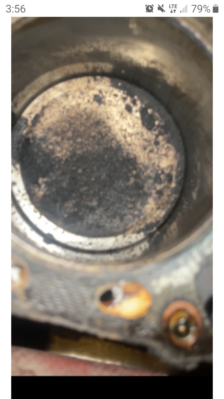

soo my 77 280z has a glossy finish in the cylinder walls. Is this normal on a stock car or should there be cross hatching.
I don’t want to build the bottom end.

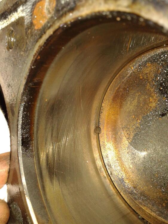

Here i have a pic of a wall with 120000km on it or 74,500 Miles..  (From my 280zx, just a clean up and new seals needed.)
Maybe you can restore these with special tools and new rings?  somebody chime in with experience?  Some pics of your walls would be nice!

Well it’s a little too late I already pulled it. What can I do now
They're not a shiny as I remember mine being. How long since the car has been run? Nissan used chrome moly from the factory so it should be slick and more shiny in my opinion.
Take your thumbnail and go up down all the holes and see if you find any scractes, gouges. Your fingernails shouldn't get caught on anything. You can get some rags and lacquer thinner and clean those holes of the carbon. Be sure and take the oil pan off or drain it for sure before cleaning.
This pic looks odd, the carbon build up on that one side. The scraper ring should keep them clean. I'm guessing that engine hasn't been run lately ?????
Can it be a reflection? some spots are a copy of the spots on the top of the piston..
Anyway.. i do see some hone stripes.. not so bad.. give it a good clean.
Im 100% with dutchzcarguy. It looks a lot like reflection and hone cross hatch and that is a good sign. If you can't see any vertical scores in the bores, it shouls be ok.
Nissan had a good reputation with the iron they used in the blocks.
Okok I’ve never seen an inside of a engine this up close and personal. The reflection threw me off. In pictures and videos it look like a stain ish reflex due to the cross hatches.
thanks guys!
The car only has 58k miles on it so I was really concerned haha
