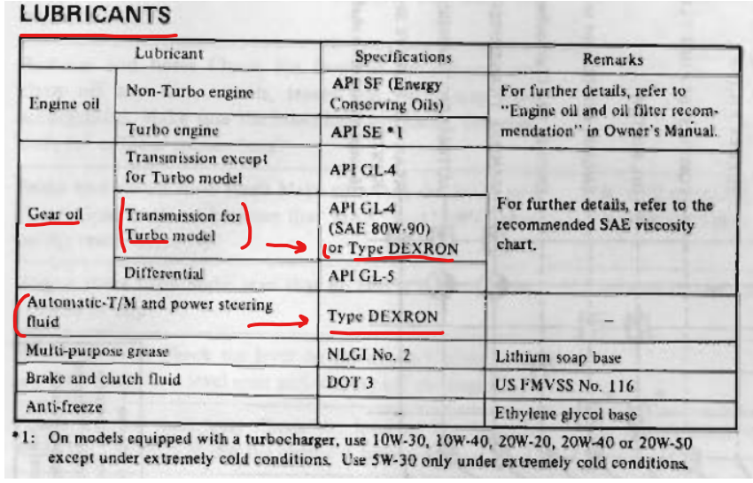

We're talking about the 280ZX Turbo transmissions.  1981 - 1983.  Not brand name changes decades later.  Not what AC Delco did in 2016.
https://en.wikipedia.org/wiki/DEXRON
Here's the 1983 FSM info again.  That is what the conversation is about.  1983.  The stuff about 2016 is interesting but not really relevant.

It's professional blindness from NISSAN  to say: OR type dexron.. (still meaning the 80w oil..  for the transmission 5 speed   and dexron (atf)  for the auto transmission..
Also: the servicemanuals of Nissan are more than once wrong.. they make mistakes..  but i always say that just shows your human ..
