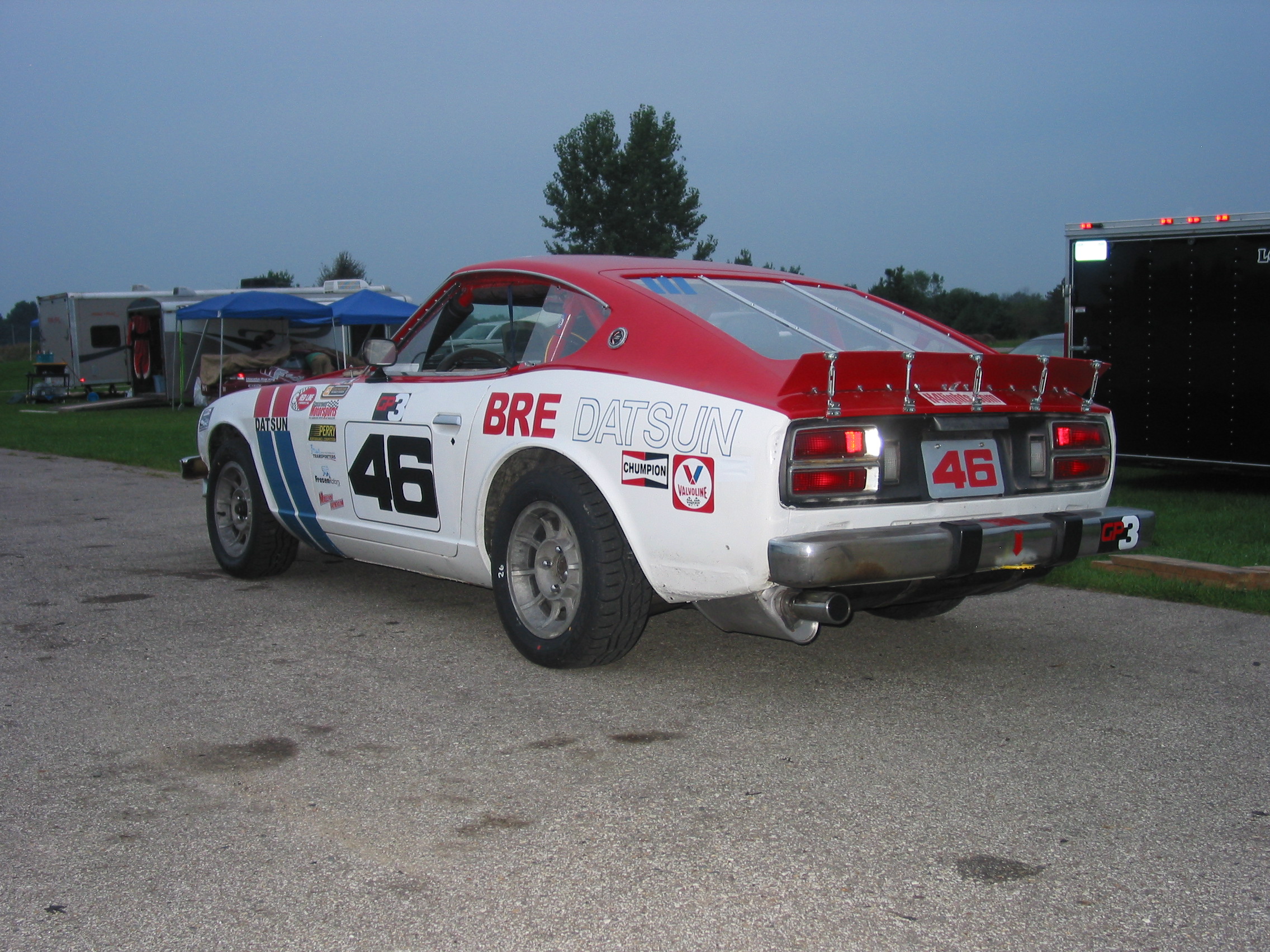

2 minutes ago, SteveJ said:
That's what I raced on for years.  They are really small for street use, but were the only good performance tire in a 14"

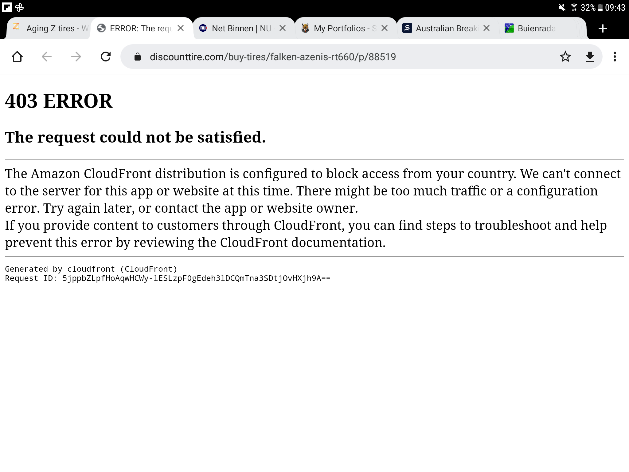

9 hours ago, SteveJ said:
My Zed has 14" wheels running 185/70R14 tyres and getting older. I have been looking for alternatives, but a lot of the info is blocked here.
Very unsatisfying🤐
Steve, can you post more info on the tyres?
