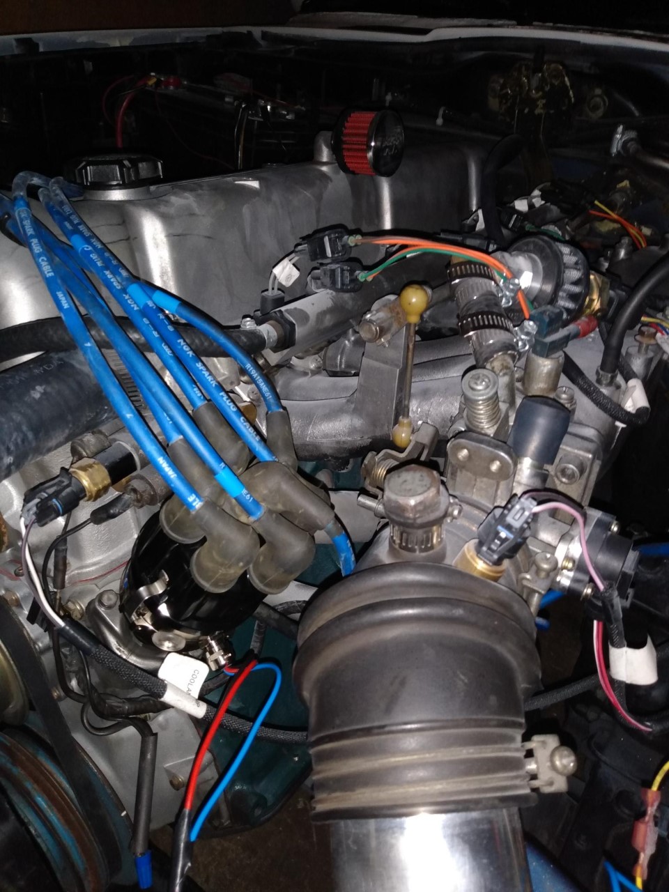

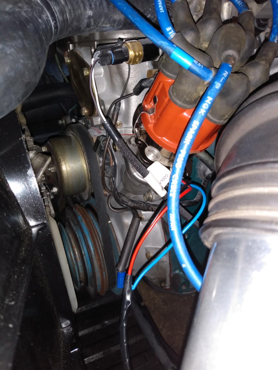

So my patience isn't as solid as I had hoped it would be.  I went ahead and ordered the 123. It came today, and within an hour and a half, it was installed and the car was running again.
There are several resources regarding installation, so I won't babble on about it, suffice it to say that it was easy, and the video and write up supplied by @AK260 was indeed a big help.  Many thanks to all who have replied and helped here on this subject.
That being said, I put a conservative tune on it and drove it around a bit, roughly 15 miles.  I didn't want to chance the Beru cap exploding.  I have ordered a BREMI cap and should be here Monday.

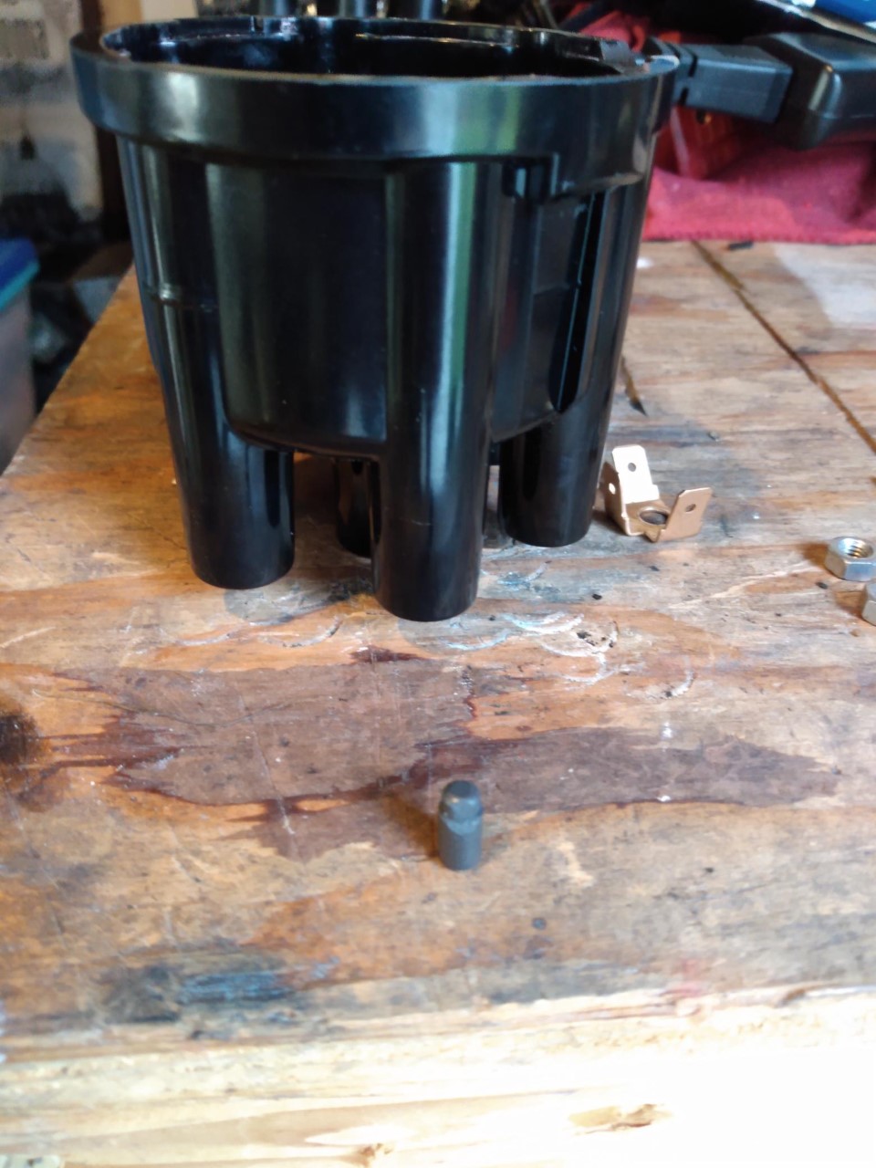

The Beru cap that came with the distributor lasted almost 2 days without losing the center diode.  Luckily for me, the car wasn't running when it happened.
I was re-installing it after cleaning up the install when it popped out while attaching the coil lead.
The Bremi cap arrived later in the day(a whole 2 days early).  I installed it and went for a 30 mile drive.  No problems.  Smooth as butter.
