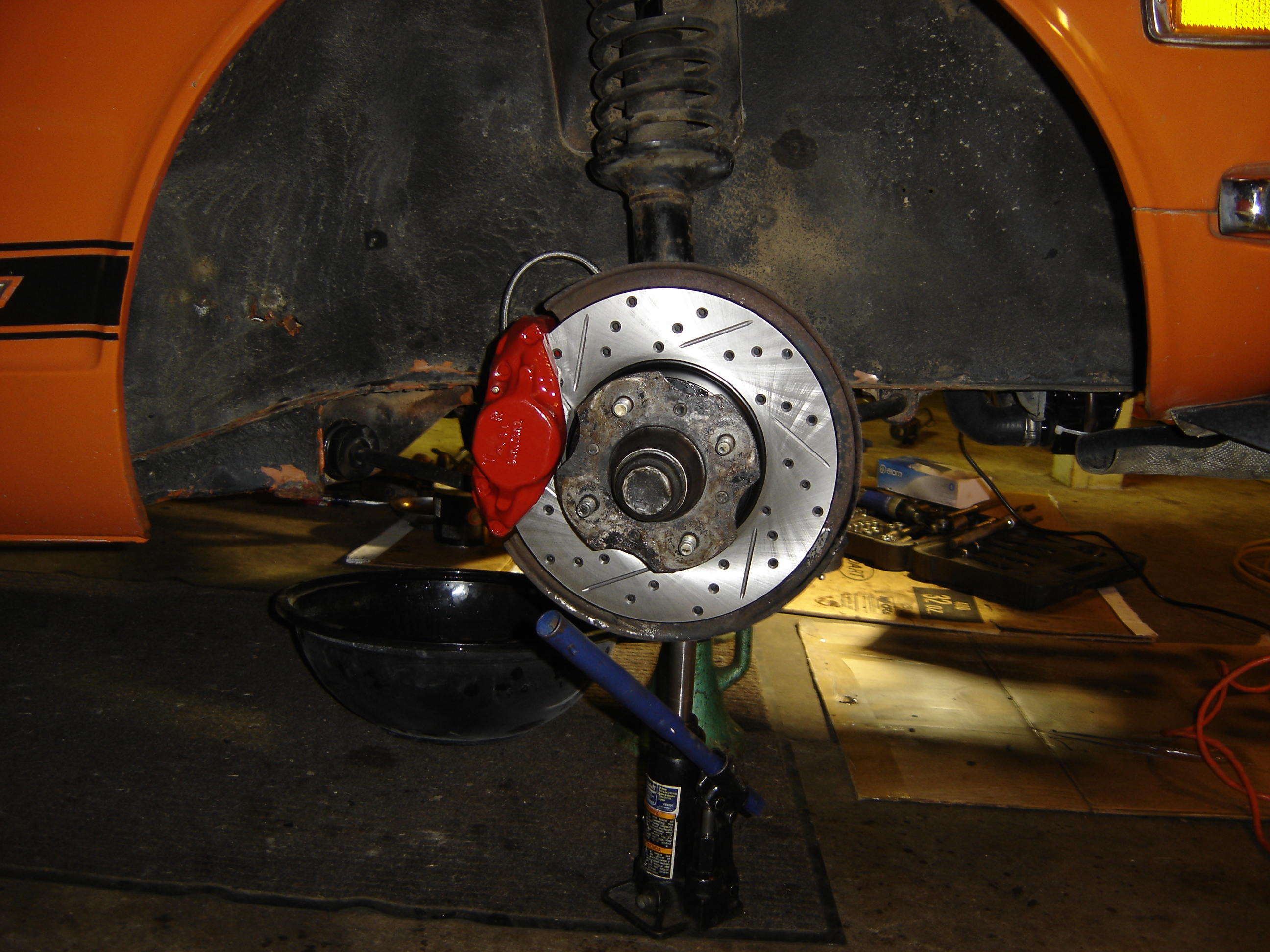

Mine is a once monthly driven car too so I didn't replace the inners. I think you can spend money elsewhere like new rotors, calipers and SS short lines on all 4 corners. I went with drilled and slotted rotors plus ceramic pads, new bearings and all that stuff. Very happy with the results too.

Thank you, my car only has 75k miles or so but the outer tie rods are shot for sure. I'll be replacing just the outer tie rods tomorrow and redo my alignment aswell at work after that. Nice, I actually just upgraded to 4 piston front, SS lines and all that a week ago. I should've replaced my bearings but they seemed okay so I just repacked them. Just need a bigger master for the brakes.
