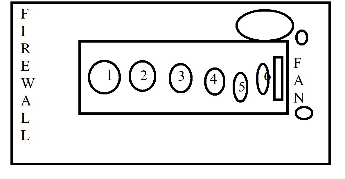

Is hooked up with plugs being wired to distributor as follows..  1 near firewall and 6 near fan...  is this totally backwards???? all the wires are numbered with little number tags and go in that order?? what is going on here?? can it be reversed somehow? or do i have to fix all wires to have 6 by firewall and 1 by fan???

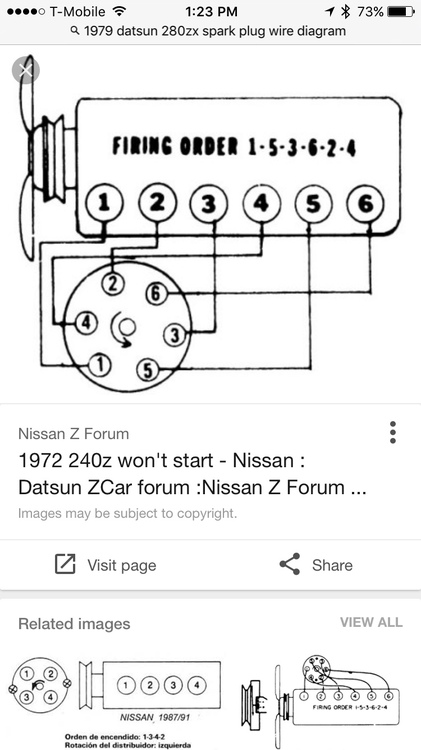

Lifted this from another thread. 260 is the same.
so  mine is wired all backwards???  could the order ever have been changed???  what happened here???

The distributor cap normally has a raised "line" in the plastic along the number one spark wire plug. None of the other plugs in the cap are marked that way so just find the one with the bump... The rotor at TDC faces nearly forward - toward the radiator - slightly offset to the left side of the car. There are pictures of all this stuff in the Factory Service Manual - Download it. xenons30.com or nicoclub.com

Is 1 spot always at front of engine? Could it ever be 6 at front ?
No. Nearly every inline 6 cylinder engine uses the same scheme not just the L-series engines. Cylinder one is at the front and numbers in order to the rear of the engine - six is the cylinder near the firewall. The firing order is 1-5-3-6-2-4. All of this is determined by the mechanical build of the engine (crankshaft, camshaft, timing gears and chain). You need to be able to verify that the mechanical timing of your engine is correct. That is the position of the mechanical parts are as they should be - including crank shaft position relative to camshaft position and distributor (rotor) position. That's the very basis of your engine mechanics.

But, using the normal procedure is best, because then everyone else will understand it.  w3wilkes post is the one you want, but you need to set your timing mark at zero on the damper pulley and confirm that you're on the compression stroke, then make sure that the rotor under the cap is pointing at the #1 terminal.
Making sure the rotor is pointed at #1 is very important.  It tells you if the oil pump shaft and distributor is installed correctly, like Mike described.
