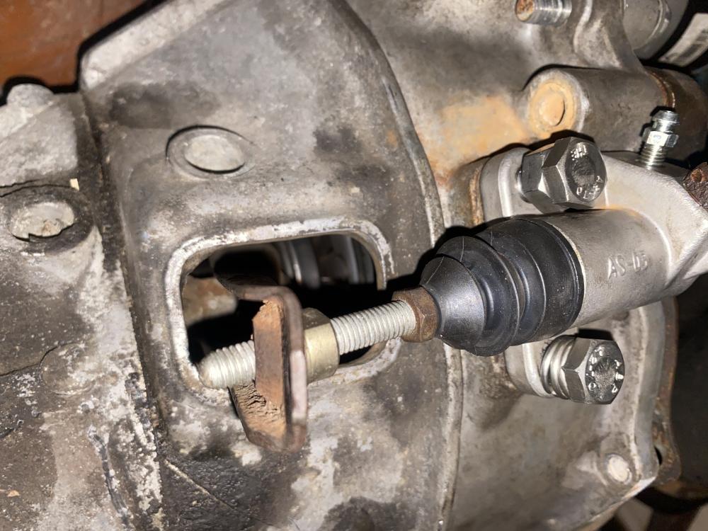

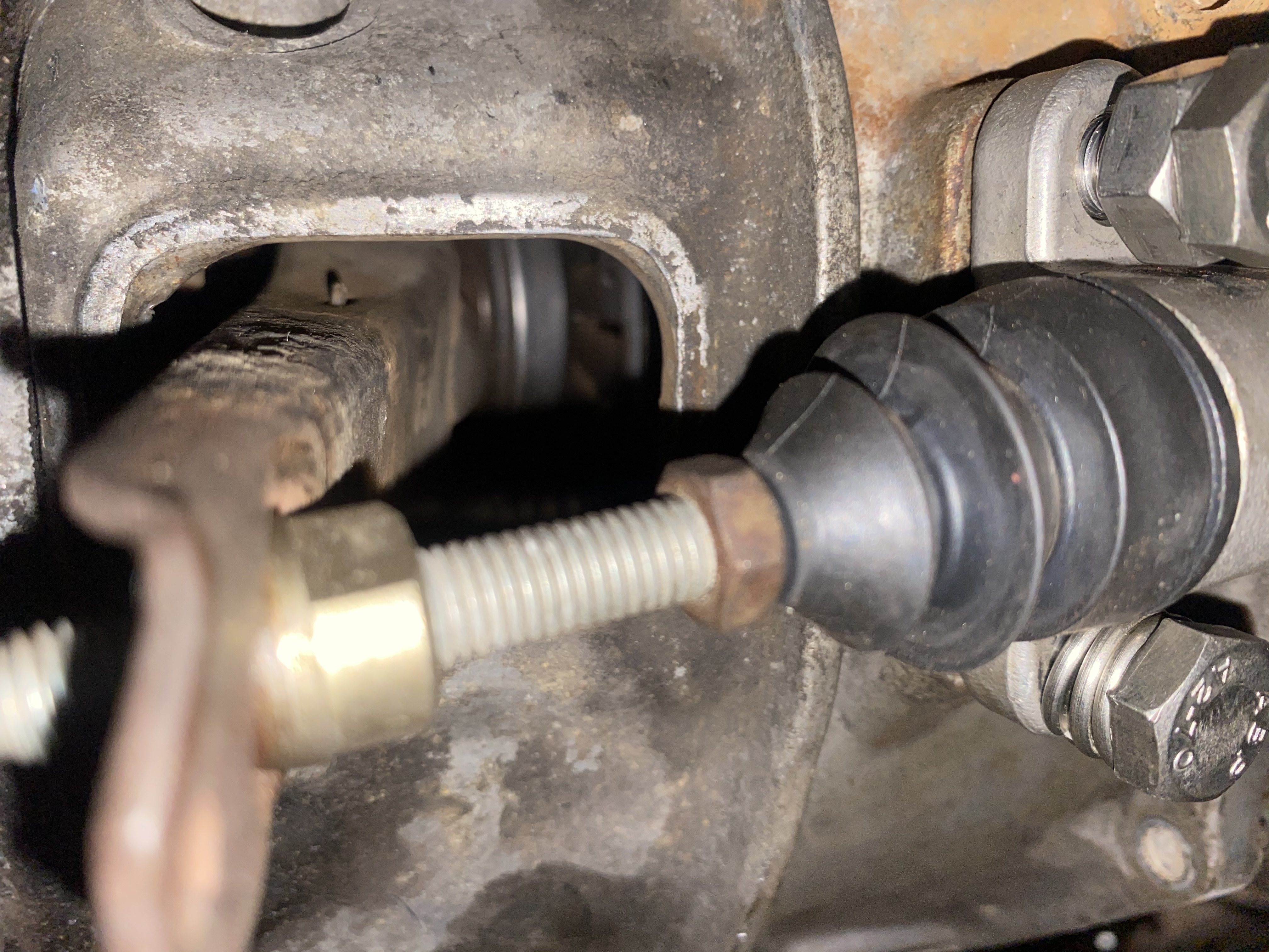

So I’m back after long work on my car. I changed the needles and cleaned out the carbs. Finally worked! (Not really) car reeved at 2000 and increased over time at idle. Used starter fluid to check for leaks and guess that my intake wasn’t fully flat had to tighten it a little more. Also PCV was bad. Finally got the carbs to idle and got the correct fuel mixture! Onto the second issues the clutch. Haven’t figured out what the issue is with the clutch. The gears just will not engage at all when I push the clutch all the way down. It looks like it is engaging when I looked under the car. Not sure what the issue is. I have a new slave and master but no dice. Note that the fork looks weird. The pin was bad but I replaced it so it holds the fork properly.

3 hours ago, Patcon said:
Are those pictures of the clutch fork with the clutch pedal NOT being pushed?
If so the problem is inside the bellhousing
The pictures are old but they are with the clutch pedal down. I’ll take another photo today because I had to replace the clutch fork retaining spring because it went bad.
