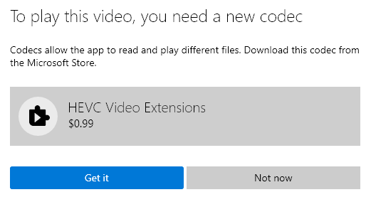

could not get the .mov to work, but generally speaking you should start by reading the plugs. running rich or lean will be a data point. Something to always look into is simple stuff like firing order and timing. don't know why they would change but once its out of your hands you can't be sure of anything. I see you changed the water temp sensor, did you check the resistance values at the ECU connector? This is important to make sure the wiring from the sensor to the ecu is correct and the values the ECU are correct for the given water temps. You mentioned fuel filter, have you checked the fuel pressure?
