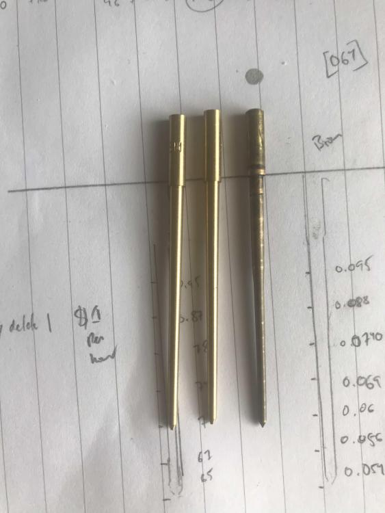

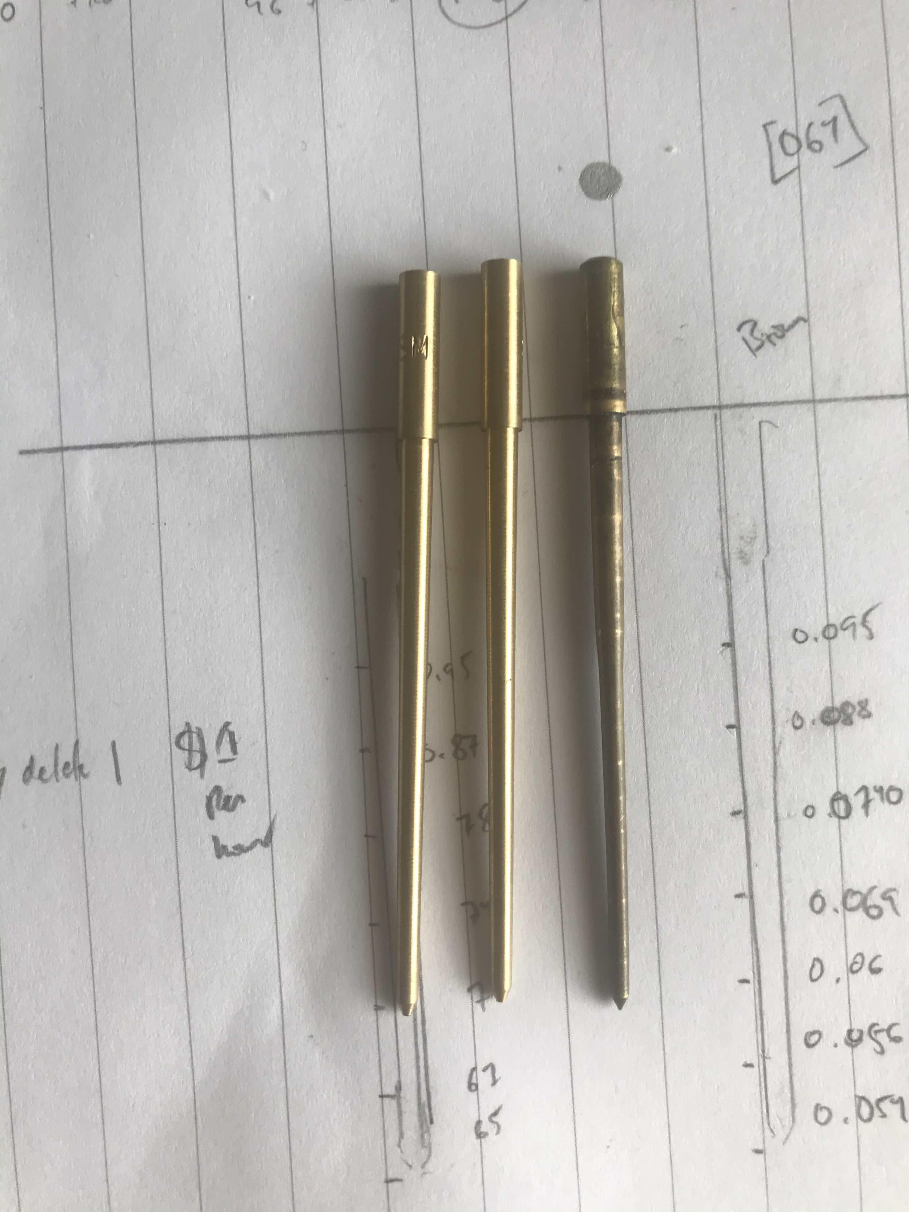

Before I tuned my carbs down really well I had gray/black smoke on idle, and my buddy said when I took off it also let out a lot of smoke (black). Turned out to be the needles all along.
