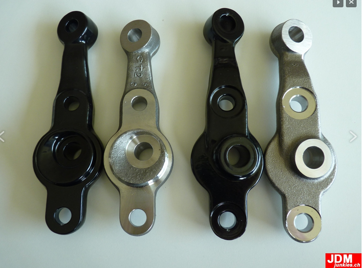

The length of "steering knuckles" also factor in the amount of steering wheel turn to the amount of wheel rotation.
@JDMjunkies.ch documented this:
I don't know the geometrical details between the various Nissan parts but I would think that new parts would remove slop. This would seem to be the biggest, and most welcome benefit.
