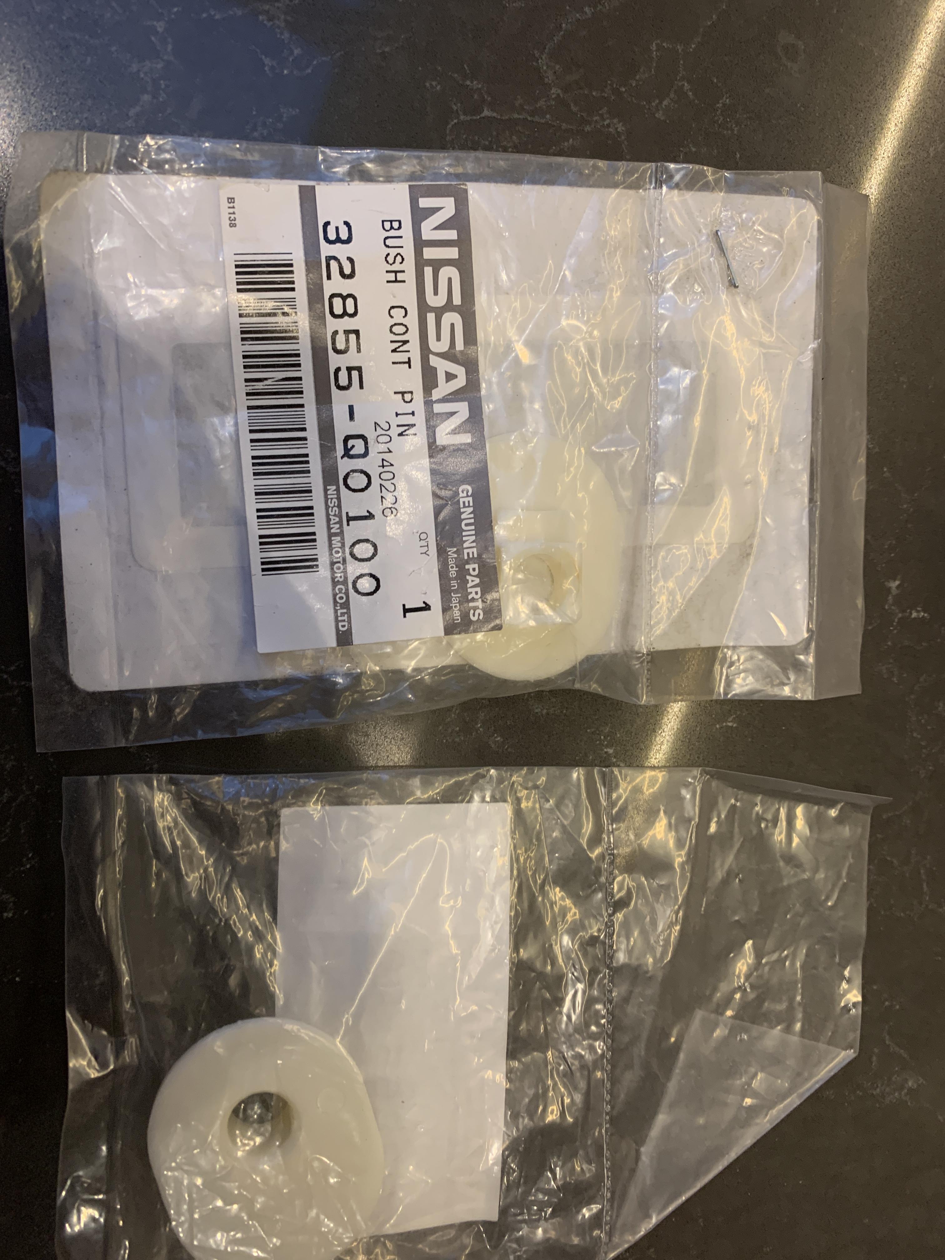

Trying to locate the Nissan p/n for this shifter bushing. E83F6A8D-B804-4E23-B6ED-7EF21DB58EF1.jpegAll I can find is the older style bushings for 70-78 transmissions. I have a FS5W71B close ratio from a ZX. Courtesy gave me a couple of p/n’s but we’re the older type bushings. I’ve got another order going to them and want to add the bushings. Appreciate the help!

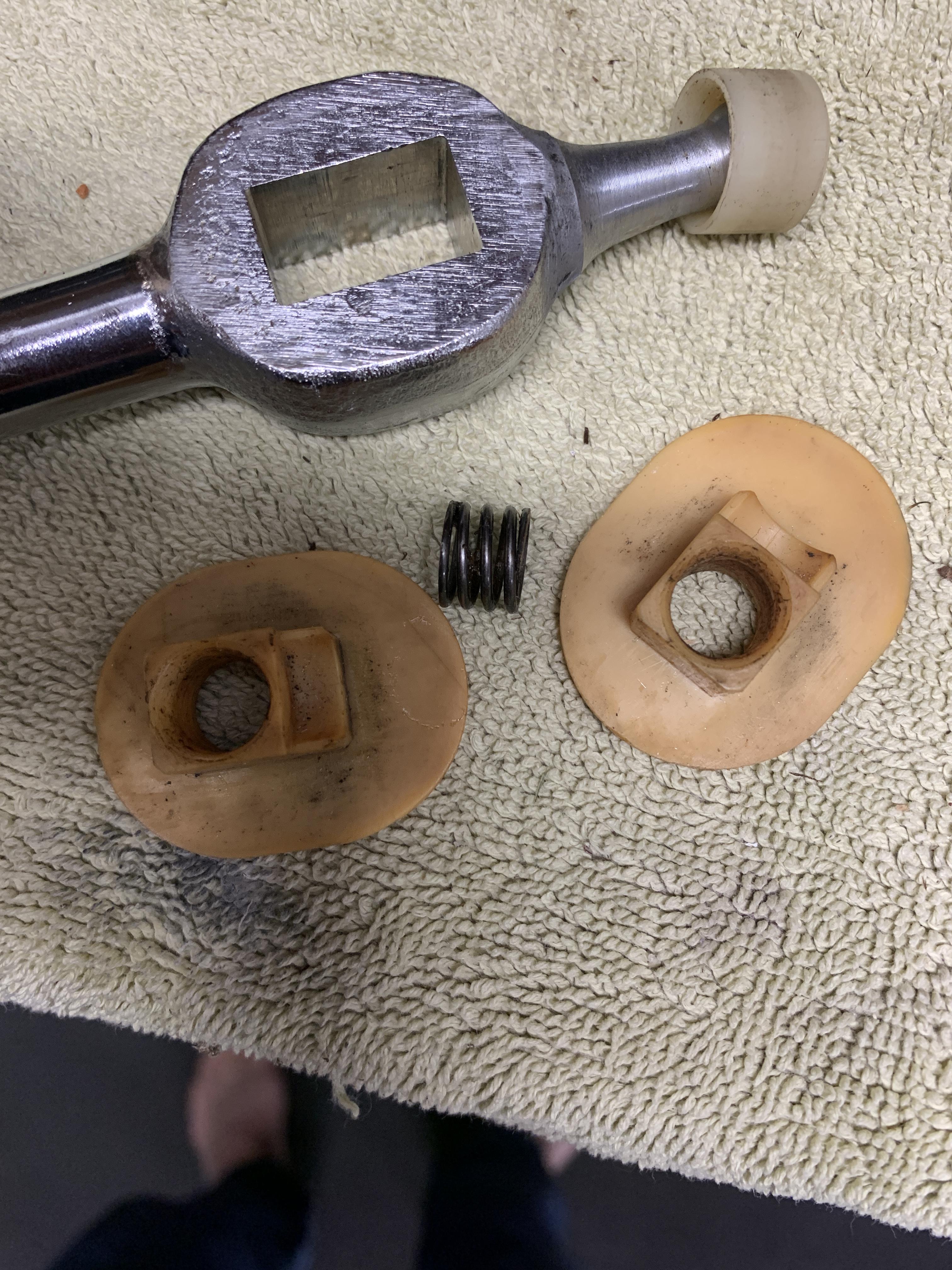

I used the older style rod on my ZX transmission. The longer one that bends back more toward the seat. That short straight up one was too much knuckles into my radio. From what I read the one like in your picture with the spring is for popping to the middle on it's own when out of gear. FWIW only, if you like it that's all that matters. B)
Hmmm, saw a post on AtlanticZ talking about that. Now where to find an older shift rod......
Hi Siteunseen,
I have read that information as well, but it is not the reason for the design change/improvement.

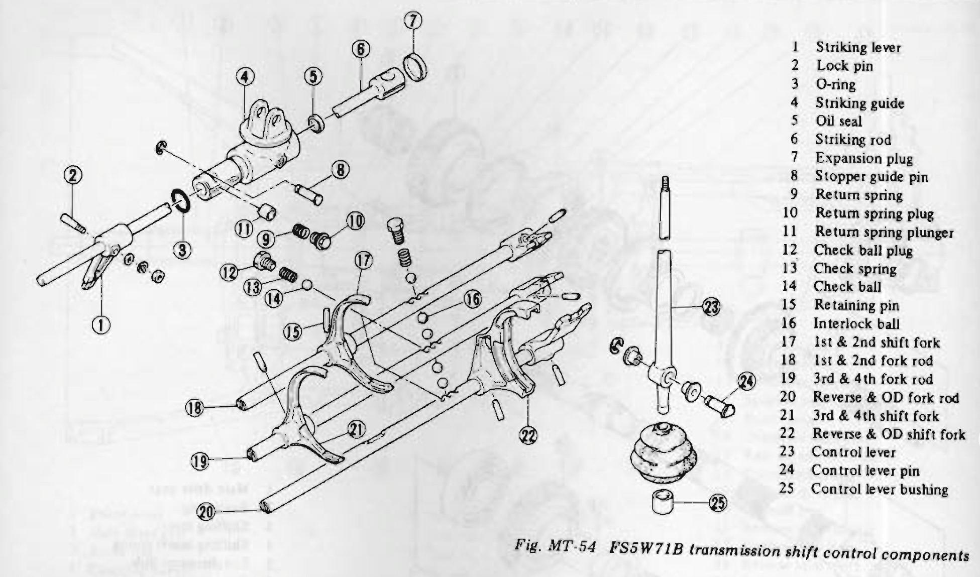

I have alsl read the the control lever bush Pos#25 moves through an arc when you go from 1st, 3rd or 5th back to 2nd, 4th or reverse. That means the bush would normally lift up out of the striking rod Pos#6. You would expect the spring to be on the bottom side to prevent this.
Another thing I heard was to reduce vibrations transfering to your hand when changing gear. The theory is you press it in slightly and the lever floats on the spring. It's a theory. Creature comfort in the 280ZX.

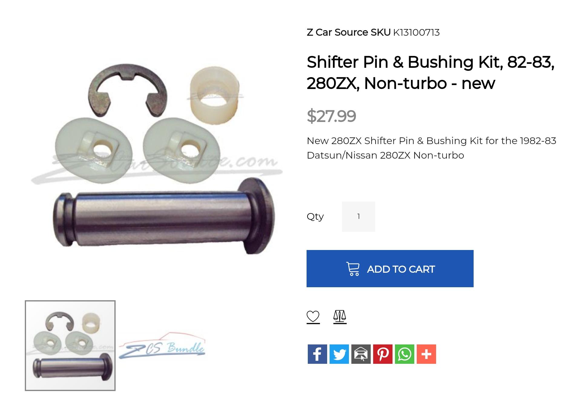

Is this what you are looking for
Edited by 7tooZ
Added photo
Perfect, I’ve searched everywhere I know of with no luck. Is there a Carpartsmanul for ZX’s out there somewhere? Thanks for the information!
