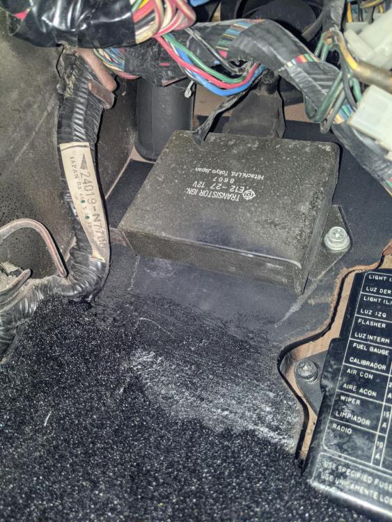

Okay so I traced out this TIU and found this
Going to assume this is the TIU as it had six pins on it. I disconnected it, went for a drive and same results. I can confirm that with this box plugged in or unplugged my rpms only work above 2000rpms. Anything below that my Tach is dead.
