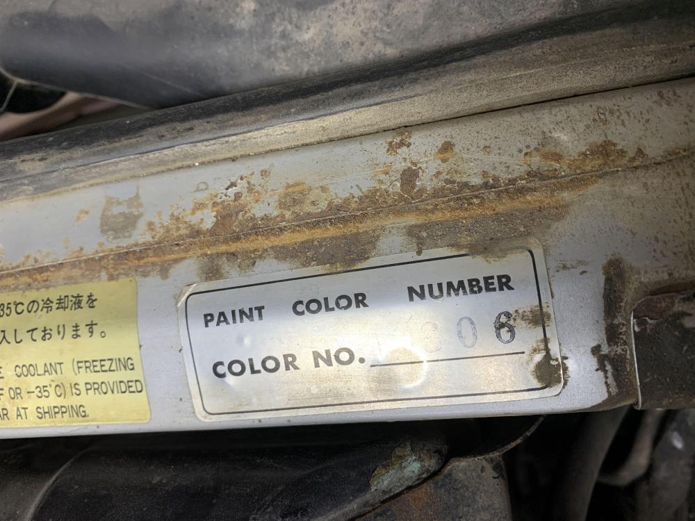

Getting setup for some winter projects for my 1977 280z including a deep clean on the engine bay since the last owner left a lot of grease build up and cosmoline. I have a number of places, usually near welds and seams, where I have small pockets of surface rust like shown in the picture (usual Datsun rust issues 😕 ) . Anyone have any advice for the best way to remove this and stop it from coming back?
I am planning to repaint the car between 2021 and  2022 which will include engine bay paint, but want to at least stop the progress of the rust between now and when I can give it a more thorough blasting.  I have used naval jelly before on parts outside of the vehicle, but not sure if that is the best approach here since there is a lot of intact paint I would prefer not to disturb before repainting.

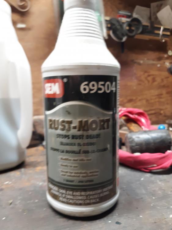

20 minutes ago, Yarb said:
@siteunseen, Does that product need to be neutralized after the application?
I didn't apply anything. After I posted that I sort of recall reading it was some type of acid in the mix that caused it to blacken. Google it and get a quick read on it. It was given to me by a car painter for the rust on a 240 I bought and sold without repainting. He said use that and let the next buyer decide on paint. I just drove it for a few years.
That is another phosphoric acid product. After it has done it's thing it has to be washed off with water, if it dries on the metal it has to be reactivated and then washed off.  There's another thread going right now about the pros/cons of certain acids.
