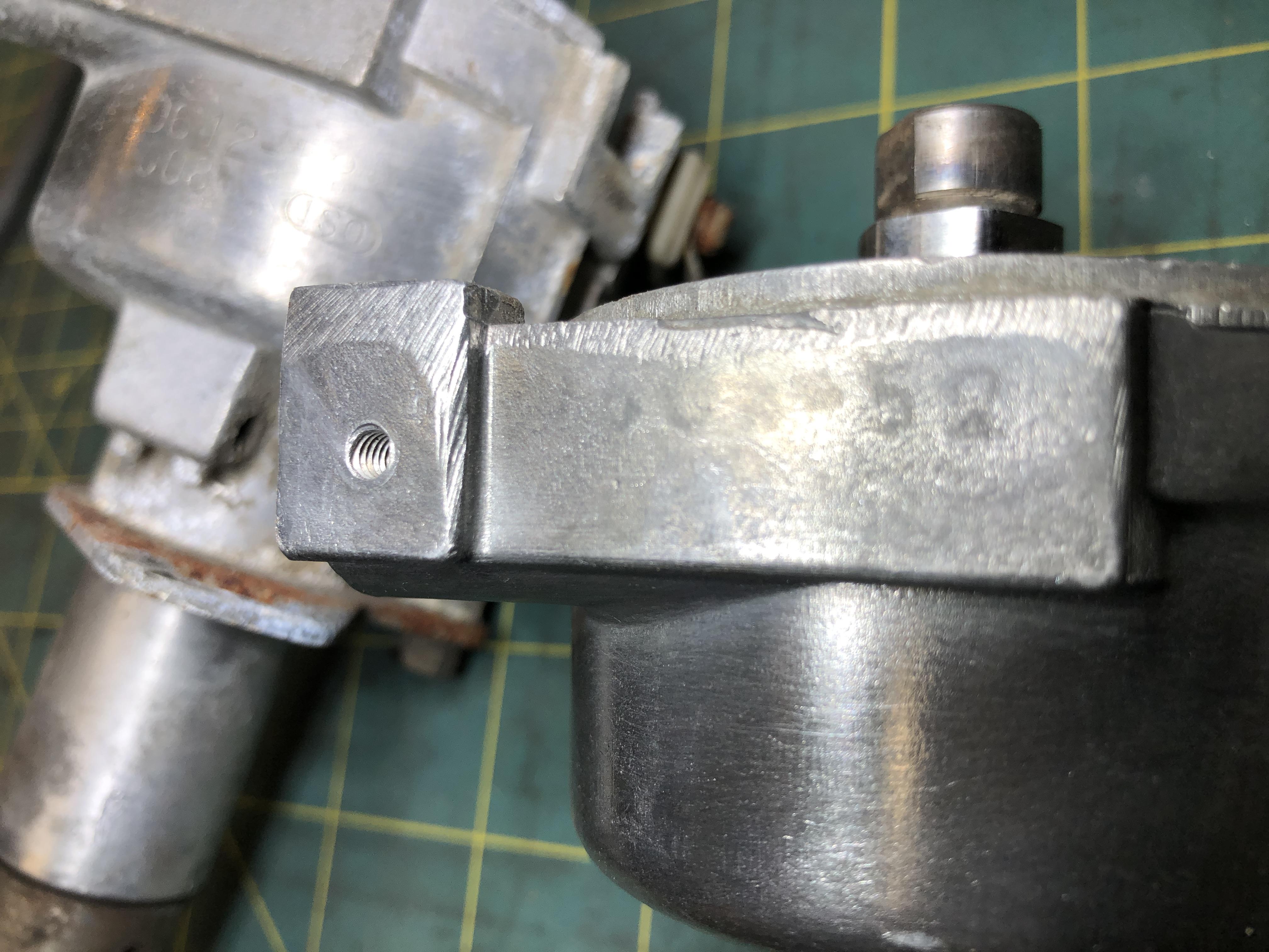

Let me confuse this further. The picture I showed was of my spare dizzy, which is not identical identical apparently to the one from the car. I was not aware of all the little differences, but the one I can share right now is the numbers on the “original” one are painted on the side, not stamped on the body, and are hard to read. It is likely the same as what 606-52, though it is very hard to read. The “60” part is more less there. See the picture.
This car is a UN Canadian car for sure, no air pump or injection tubing, clean balance tube, no evap tank, gas tank with single vent tube etc.
I will see what number is punched on the sloted bar and let you know.
But the overall issue is resolved I believe, it should have the single spring it has.

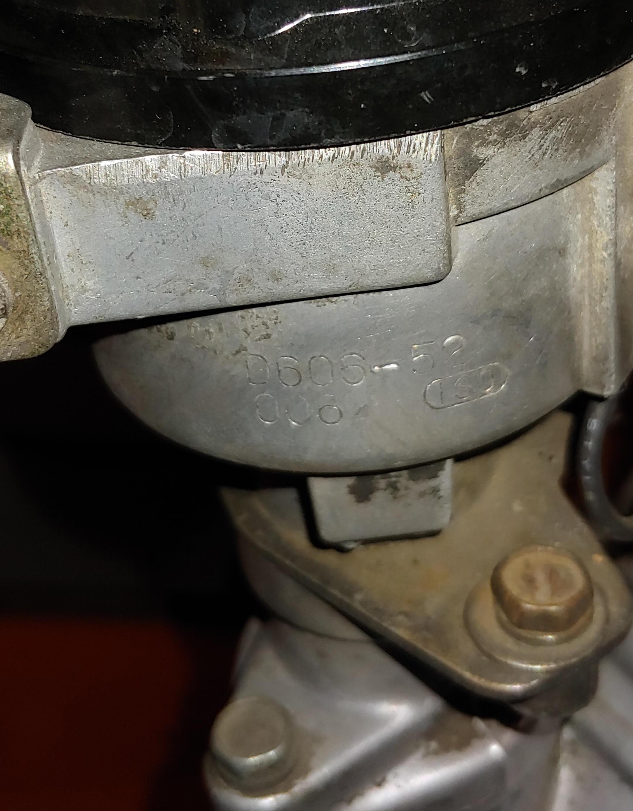

Interesting Jim, with my car being a UN, Only 12 cars older than @240dkw's UN car, I thought I would check my dizzy for a painted on number.  I found that mine is a D606-52, but the number is engraved, not painted. Lot's of small variances with our cars.
Cheers, Mike
