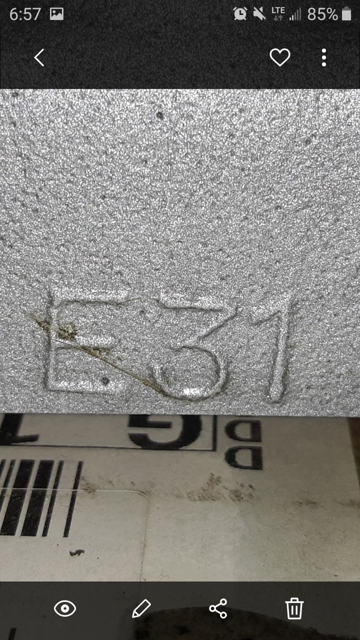

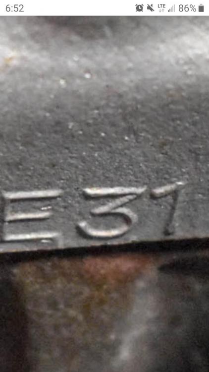

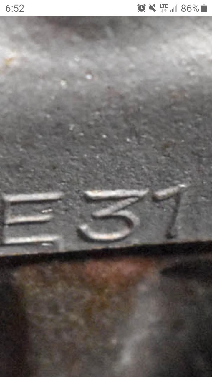

I'm know E31 aficionado but mine has spent some time at a machine shop. Bigger valves were put in and the bottom was skimmed for true flatness.
Mine...
The "31k" cars...

Forgive my ignorance but what do you see? Is it a skimmed head? Comparing yours + the auction one and Zadheads, is a little lip that I can see on Zedhead’s photo. Is that what you are pointing out?
The E31 closeness to the bottom edge makes me think the 31k head has been cut too. Mine doesn't look as close as that one and it definitely had a cut. Could be the angle of the photo though so it's just a guess. Like Zed said "Dog pile on". Everyone is piling on so I thought I would join in too.
I had exactly the same thought about the photo distorting what you can see, but also I spotted a very subtle lip on the zedhead photo. [emoji848]
Either way, I just can’t imagine that there is any chance the true mileage is a mere 31k.
