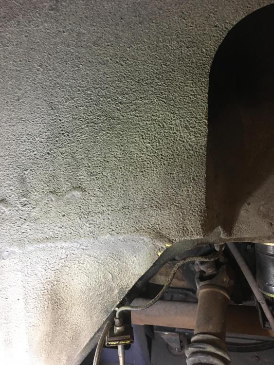

My 72 240Z must have dealer installed undercoating in the wheel wells.  I'm not sure if they did this at the factory.  I am (my Dad) the original owner.  Can this undercoating in the wheel wells be effectively painted?  I don't want to remove it and it makes no sense to put more undercoating or bed liner on top of it.  I'm wondering if paint will adhere and not flake off easily, or would this be a waste of time?  Any suggestions for what to use, or just leave it?

Thanks, have you found it stays on even after even after several miles of dirt and debris kicked up from driving?  I can't decide if I want to paint black or the color of the car (112) under there.

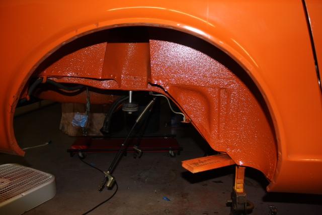

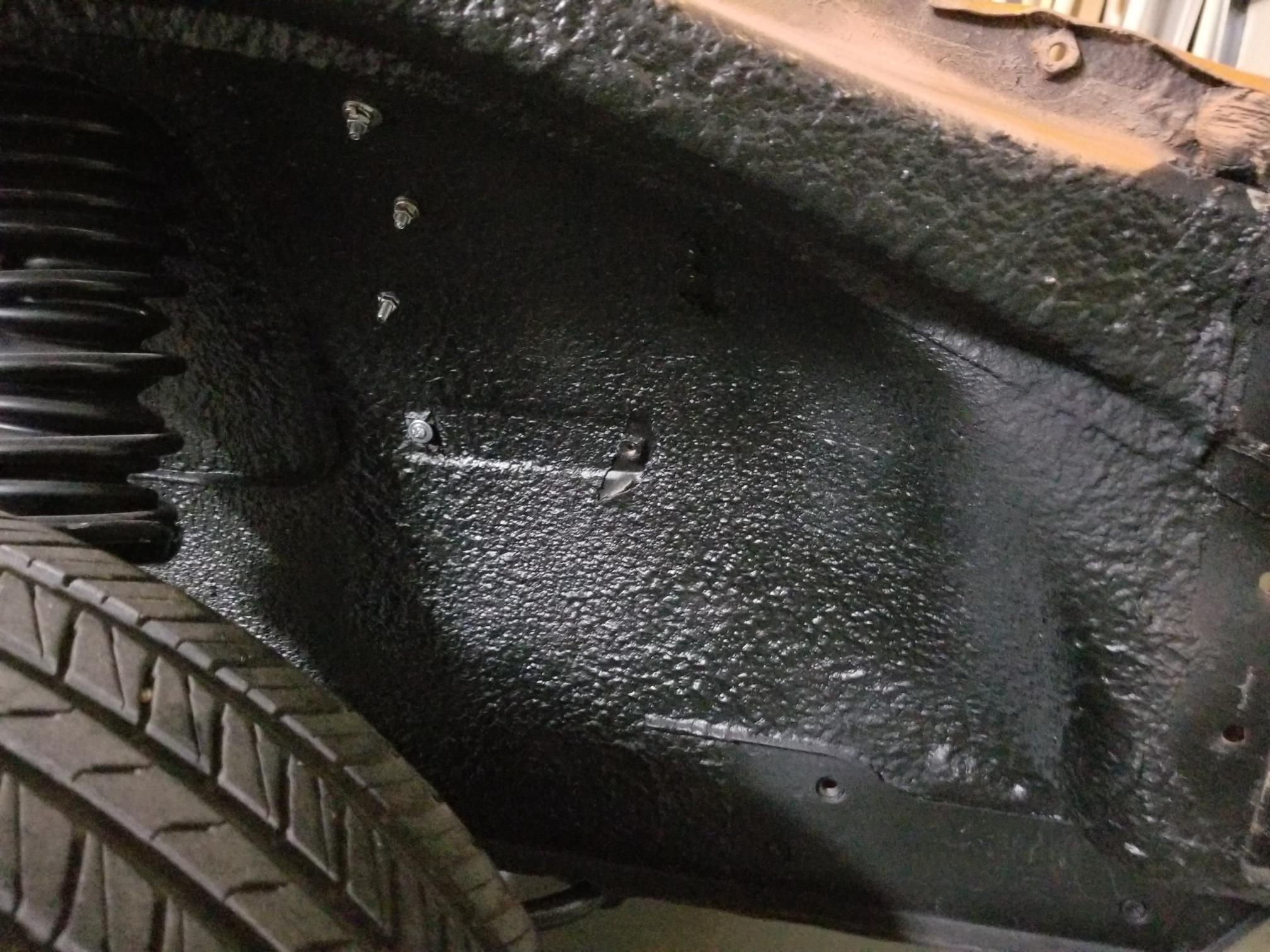

I’m not the most experienced painter, so take that into account when you read this.  I am restoring a 1973 240z, changing colors so everything needed to be painted.  One thing that I learned is that I am not capable of defining where rust is or is not.  I wound up removing undercoating from places that I would have bet would not have rust only to reveal issues that I might have inadvertently covered up if I had not taken the time to remove the original 43 year old covering.  I also learned that I could not get away with covering something unless it was completely free of dirt, oil etc.  In my case I had to remove fenders anyway and once I started chiseling and using a wire wheel I could not stop.  I originally was going to make it body color, but my paint color (orange) is extremely expensive, and I actually liked the blacked out look better.  A friend criticized my flat black approach and he was right.  I sprayed a rustoleum  rubberized undercoating product over the flat black and I like the result.  It actually looks better than the picture.  The bucket has not gotten back on the road yet so I cant tell you how well it will hold up but it is reasonably thick and seems pretty tough.
