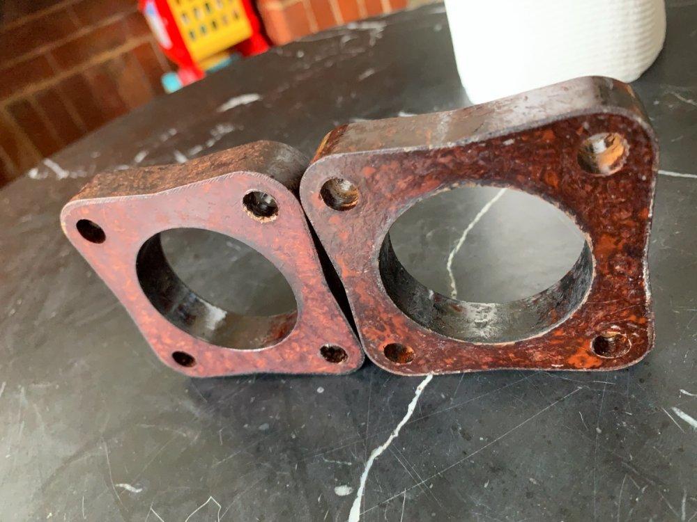

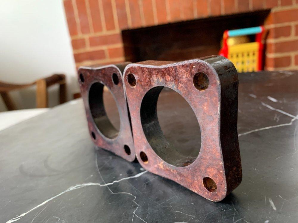

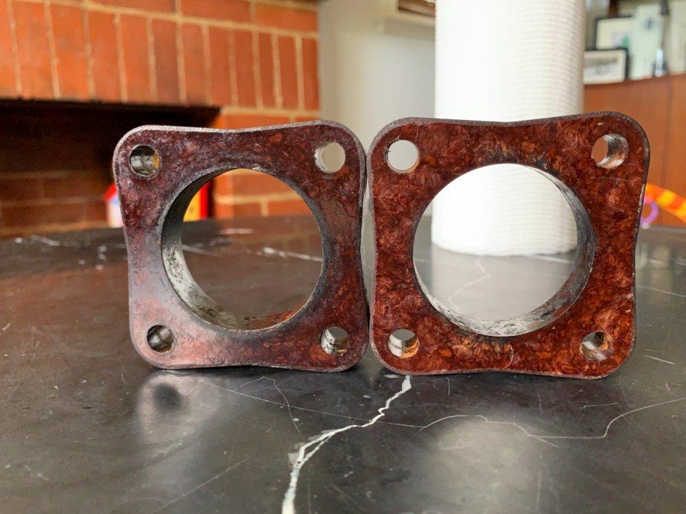

I managed to free my carb insulator blocks from the intake manifold with a razor blade and cleaned them up. The gasket was pretty much glued to one of the blocks, attacked it with the razor blade and was careful not to inflict any damage. cleaned up further with paper towel and sugar soap.  Came out pretty good!
Question: are my blocks ok to reuse and do people normally recoat/varnish these blocks before reusing? If so what product would one use?

Never really considered refinishing them, but they are reusable. You might give them a good coat of beeswax, on the parts that are exposed, then buff to a nice gloss.

The gaskets on mine were practically glued on as well, just make sure they are smooth and flat before installation.  I used some sticky backed 400 grit paper on a granite flat  and worked both sides until smooth, as I remember one had a slight warp that was causing a small vacuum leak.

You can reuse those spacers just fine. As mentioned above, maybe hit them on a sanding surface a little to see if they're badly warped, but other than that, run 'em. If you think they're bad enough to risk not sealing, you could put a little gasket sealer on them as insurance. For those, I'd use a non-silicone type like Permatex Moto-seal. It's MEK based and (in theory) is resistant to gasoline.

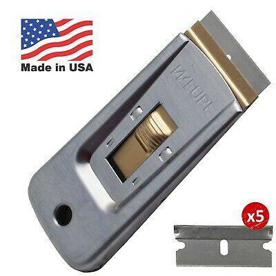

I haven't found any solvents that help on those original gaskets, I have an old Stanley paint scraper like in the pic, not much can resist it.
