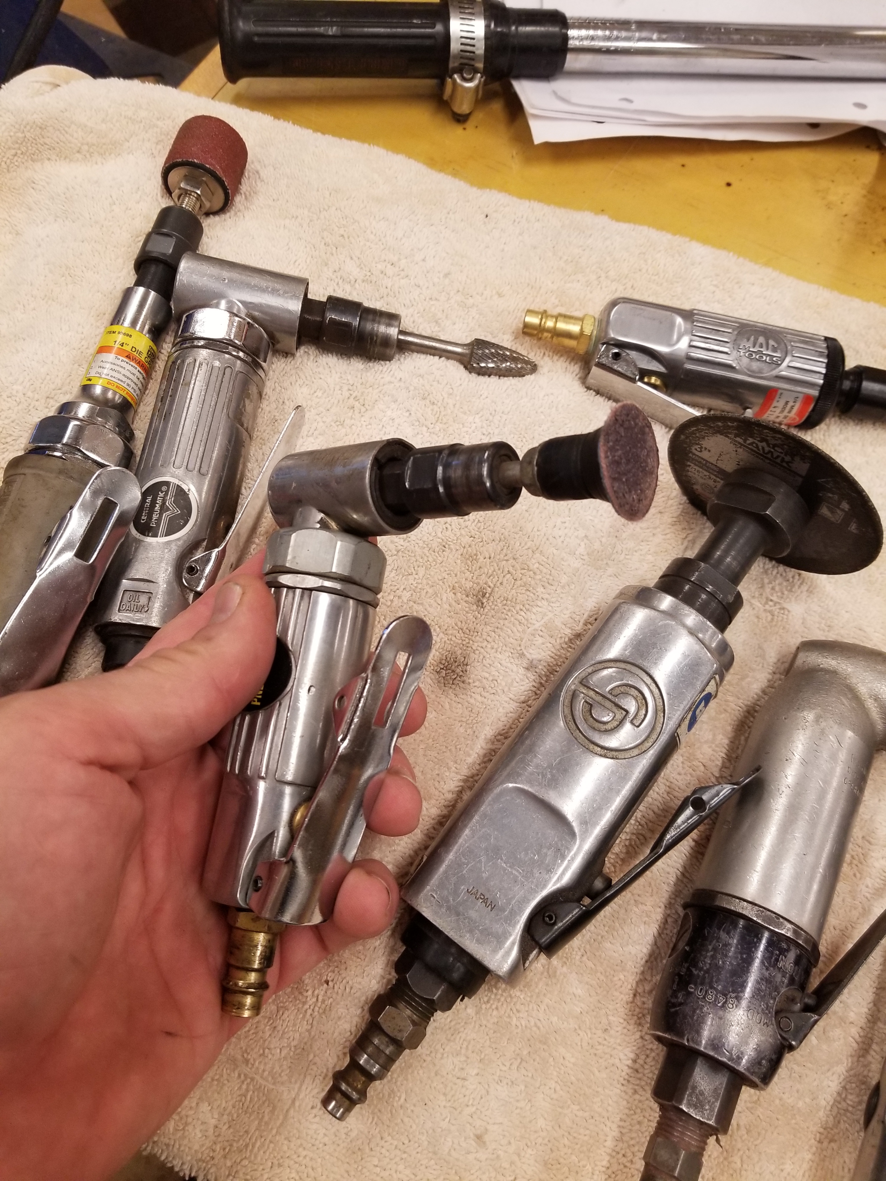

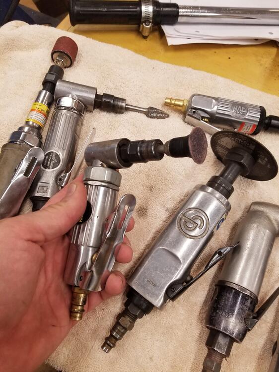

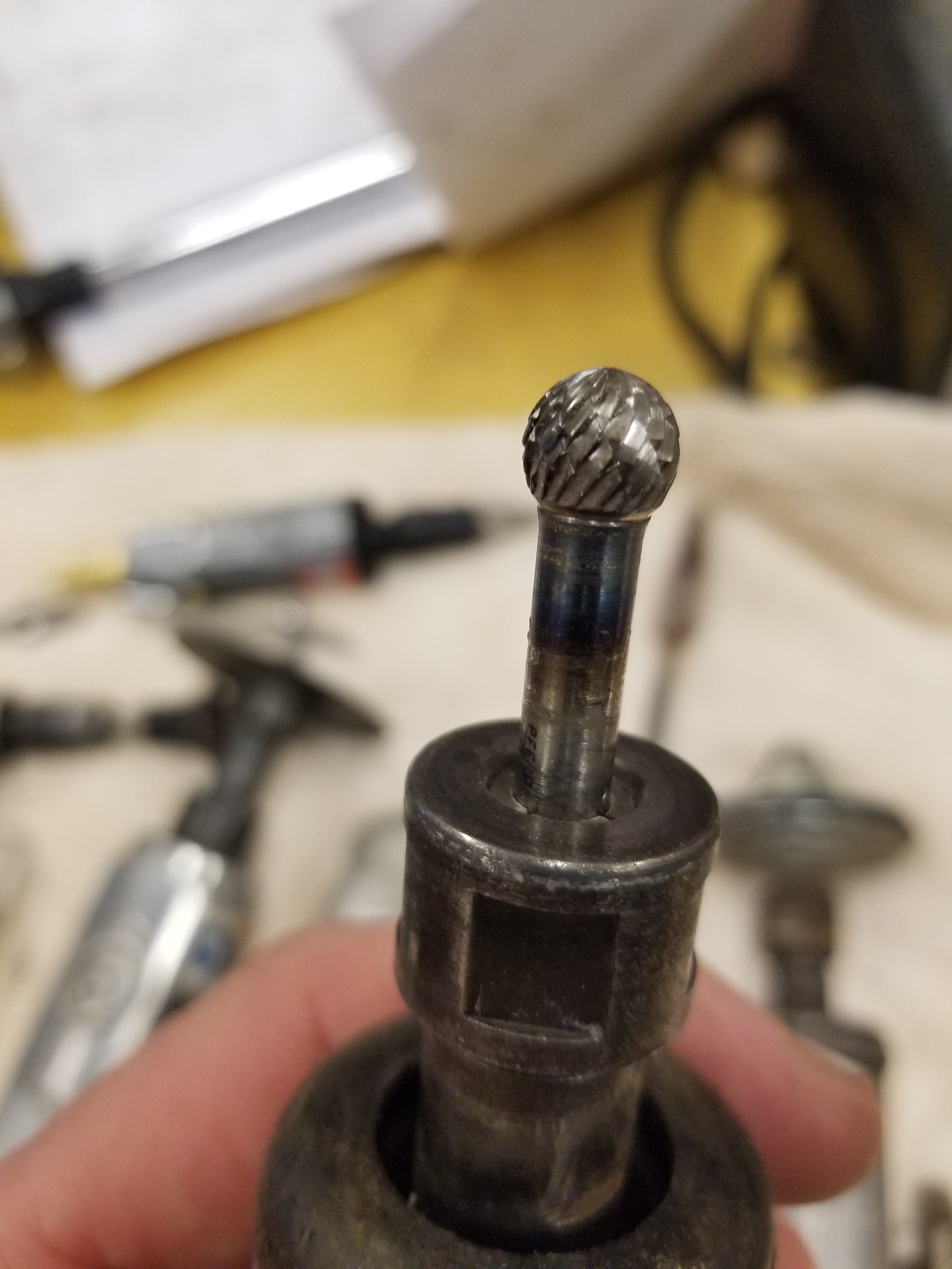

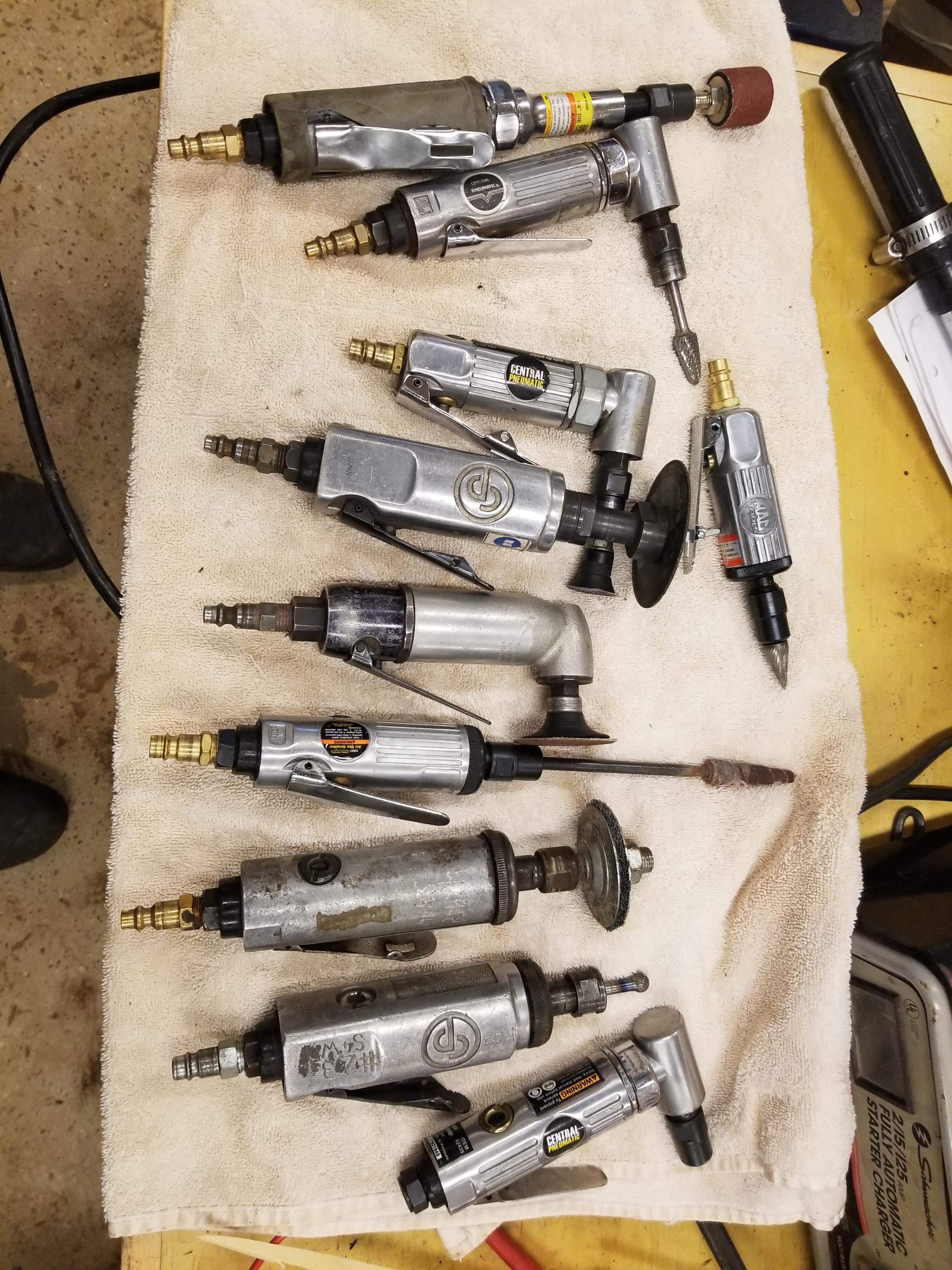

July 17, 20214 yr comment_625214 14 hours ago, Patcon said: I have never used a low noise type. But if it's anything like the low-noise type air ratchet I have; it wont be very quiet. Maybe the low-noise type are intended to be hearing safe I was wrong... I have more than 6 or 7 . This isn't even all of them. Sorry about the rotation. It displays properly on my computer and in an editor... This is my tool of choice for spot welds. You can tell it's been hot. It's done hundreds of welds. I find a straight one is easier to use than the angle grinder because of the better leverage This is also really nice for dressing welds. A 1" Rolok The biggest problem with it is the pads go very quickly!! They are also hard to source and about $0.35 each. I normally dress welds mostly down with the 3" cut off wheel. Then fine tune with the 1" and 2" Roloks At The Big Shed they buy that stuff by the truckload. Link to comment https://www.classiczcars.com/forums/topic/64416-240zbuiltbyme-1971-240z-hs-001063-project-georgia/?&page=19#findComment-625214 Share on other sites More sharing options...

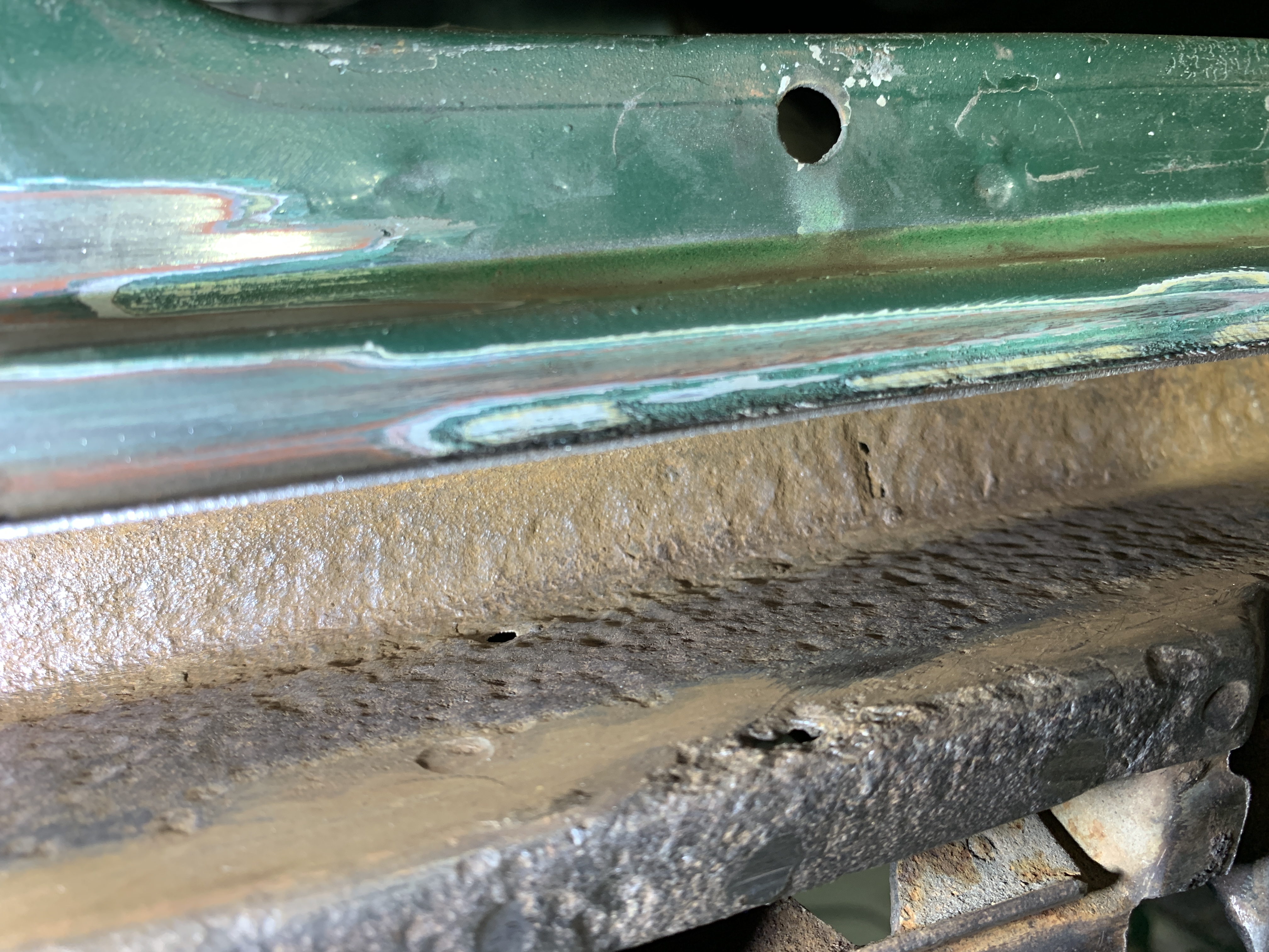

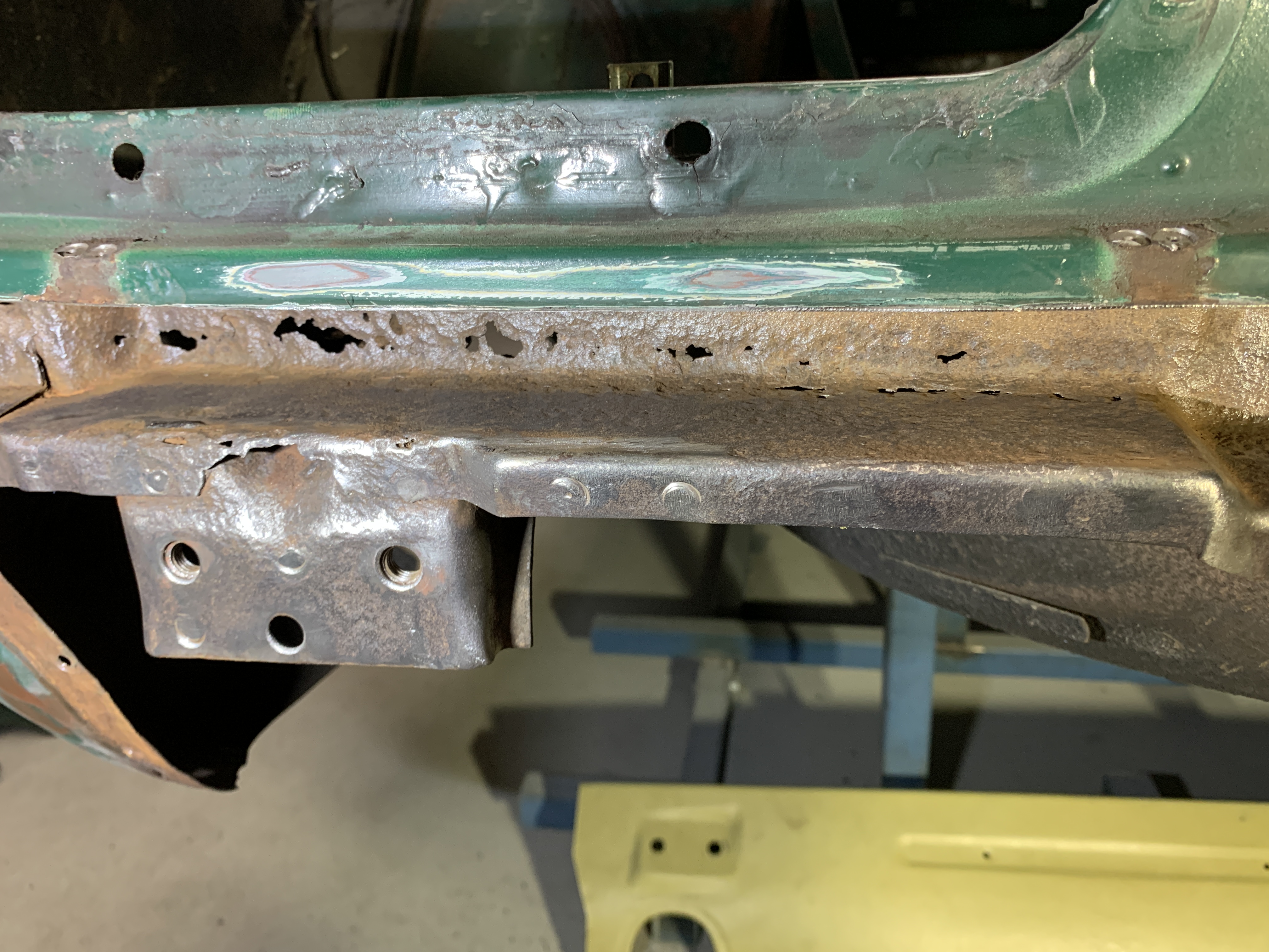

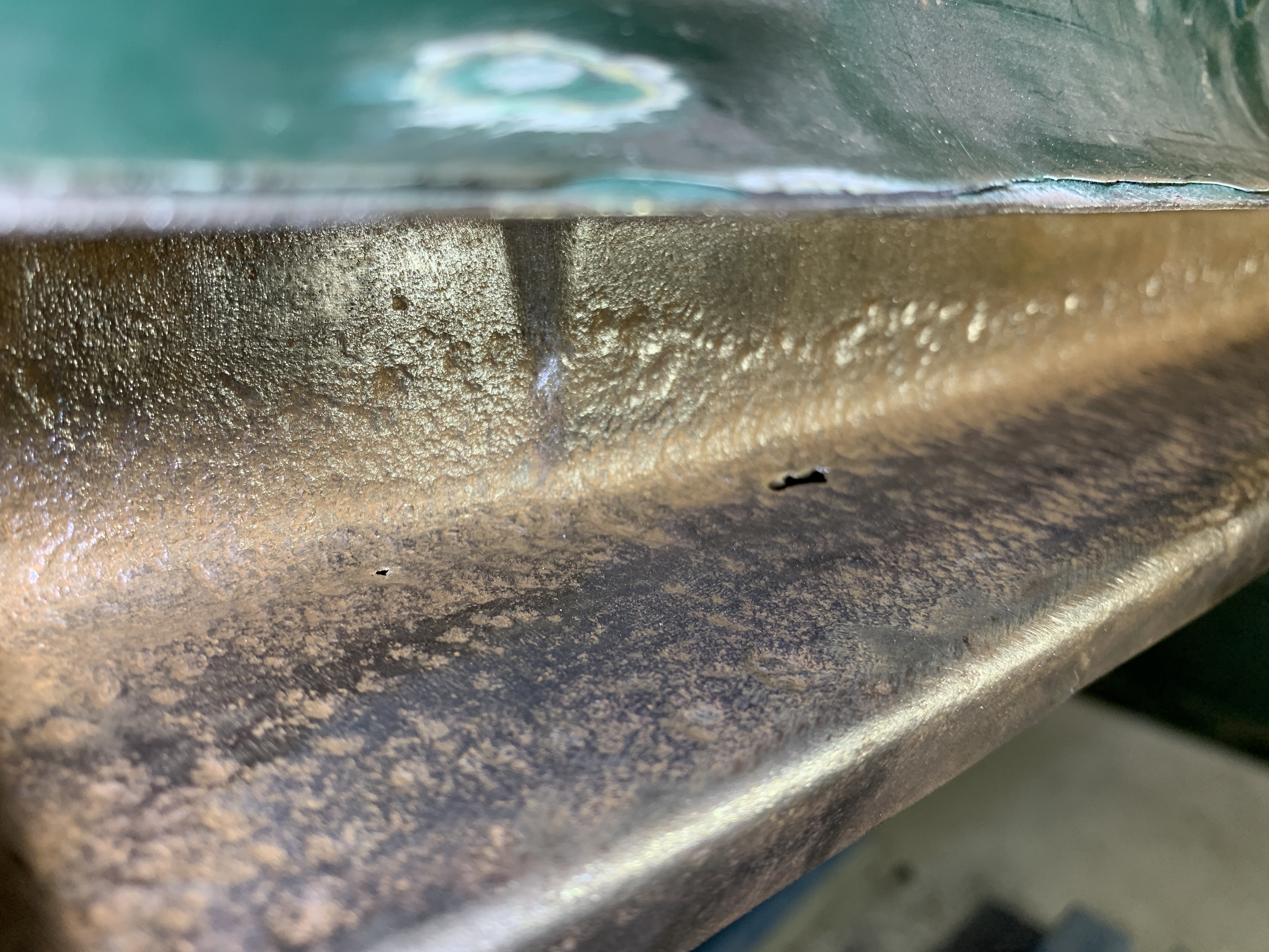

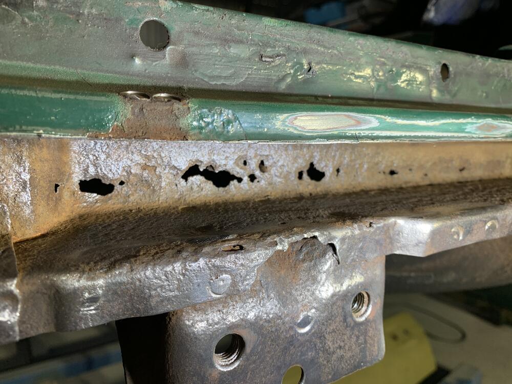

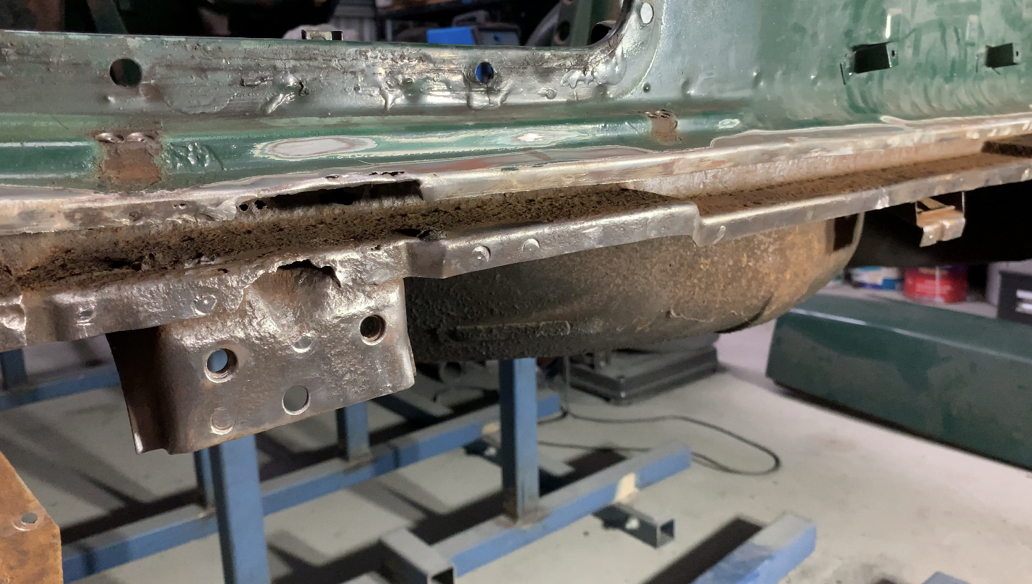

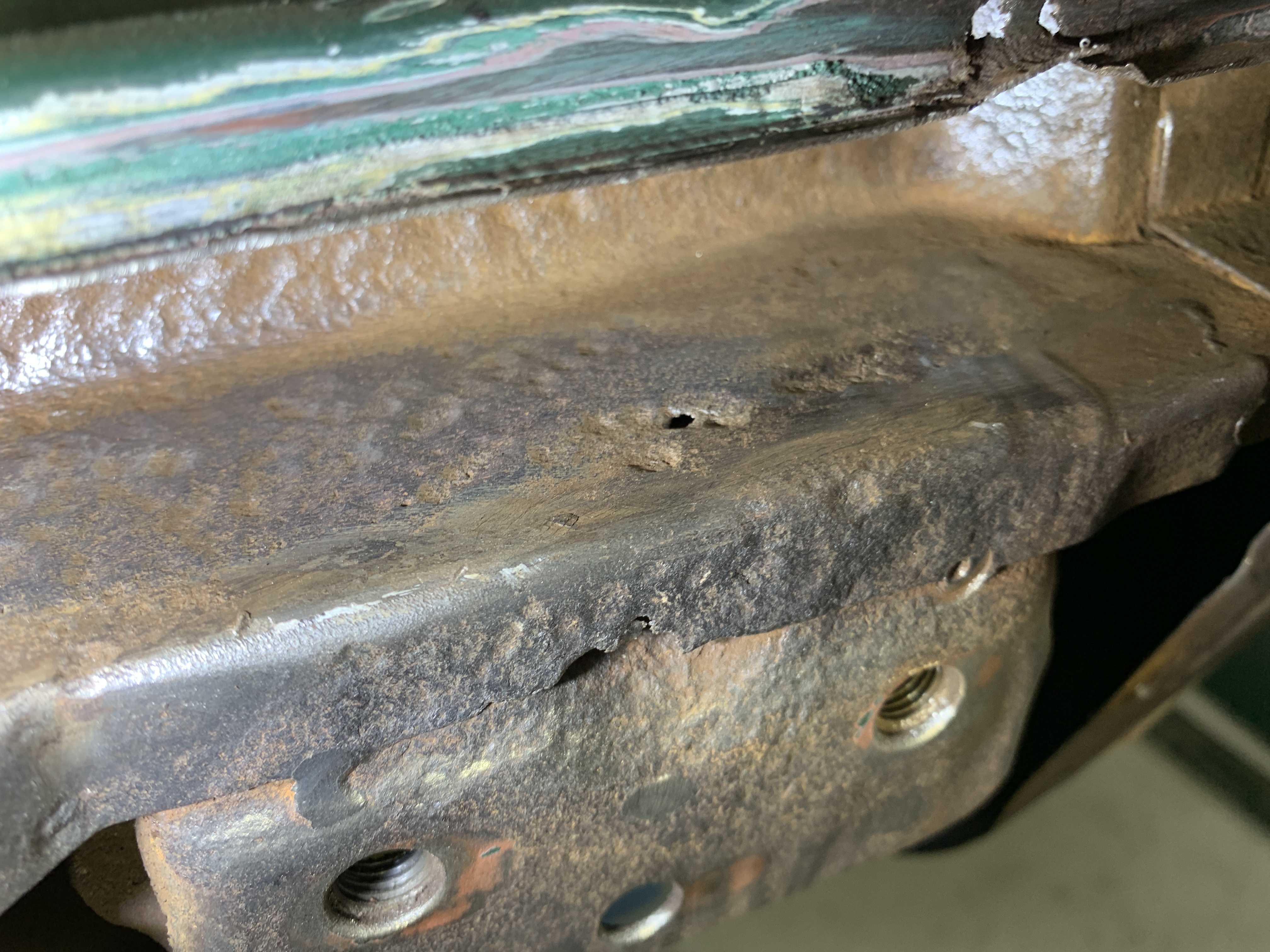

July 26, 20214 yr Author comment_625743 Didn’t get a great deal of time this break, only managed a few precious hours with Sheena. I’ve lost a tonne of sleep lately, tossing and turning in bed scheming and stressing about how I’m going to do this job! Anyone else do that? I’m sure I’m not the only one... I ground down all the proud spot welds and gave the front face and what I could reach a good wire wheeling. I bolted the repair panel in, marked the cut line and made the finaL cut. All the while shitting myself... cut was good with more room for access I went to work cleaning the box section as best I could. Came up ok and revealed many new holes where rust had eaten through. Question. Can I just fill any small holes with the mig? Given I use a rust converter and ensure the welding surface is free of any rust? I was keen to get a coating on the box section but with the rust that needs repairing I figured I would save it for once those were done. I was thinking of trying a spot blaster to further tidy up the unreachable areas in the box section. Has anyone used something like these? I know they’re generally crap but  are they good enough to do some small areas? next time I plan to: - repair rusted through areas on the box section (I think I’ll be lucky to get through this as will be my first time welding in patch panels....wish me luck....) - hopefully get some kbs rustseal in there Link to comment https://www.classiczcars.com/forums/topic/64416-240zbuiltbyme-1971-240z-hs-001063-project-georgia/?&page=19#findComment-625743 Share on other sites More sharing options...
July 26, 20214 yr comment_625748  You can try filling the holes with weld but you'll have to clean the rust from around them first. After removing the rust, you'll probably find you've enlarged the hole out to solid steel and have a dime or quarter size hole to patch. I can assure you that inserting a piece of sheet metal into a clean hole is much easier and satisfying than chasing a hole in rusty sheet metal with a Mig. Link to comment https://www.classiczcars.com/forums/topic/64416-240zbuiltbyme-1971-240z-hs-001063-project-georgia/?&page=19#findComment-625748 Share on other sites More sharing options...
July 26, 20214 yr comment_625753 Also some copper to back the hole Helps close them up too. Mind that the copper gets hot very quickly!! Do you not have a metal shop that can brake a section like that for you? I would consider replacing that or at least the worst sections. By the time its clean there wont be much metal left. Several years ago I would have chased those holes. I have come around to the idea that it's overall just easier to get rid of that rotten metal and the chassis is stiffer for it  Link to comment https://www.classiczcars.com/forums/topic/64416-240zbuiltbyme-1971-240z-hs-001063-project-georgia/?&page=19#findComment-625753 Share on other sites More sharing options...
