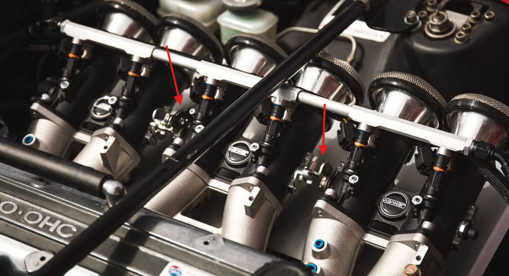

So, down the road, after I’ve gotten things running the way I’d like, I’m thinking of going to ITB’s. But, I’m committed to DBW. I removed the pivot for linkage from the firewall so I’m all in. When I go to ITB’s, how do I control three throttles?
I see a cable linkage that pulls down at the left arrow. And the front two ITBs are connected to the middle two ITBs at the right arrow.
And there is a list of options on their site.
I'm not familiar enough with the Jenvey setup to explain the first two options. The third looks like a throttle-by-wire setup.
I just found another picture that may show the double linkage.
