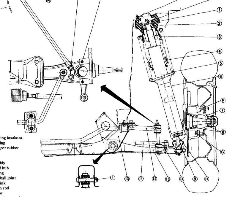

I just measured from here on the shock to a straight edge on the rotor with the measurements I got below it’s a clear indicator of why I have more negative camber on the drivers side. I just am not sure what I should do to fix this buy a new strut assembly?

This should eliminate any other issues with the car other than either the strut is bent or the spindle is bent right?

Can you see any signs of damage where the tube enters the casting?  Maybe someone hit a curb in the past.
I never realized how dependent the hub alignment is on that joint with the tube.

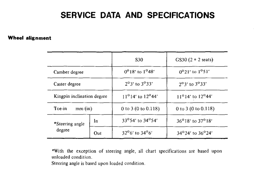

Although now thinking about it I am not sure what side has the correct measurement. I can’t find that measurement in the fsm or what any of the angles should be

This is great info thank you all. I think I need to take it to a good alignment shop to get “SAI” and that will really pinpoint what could be wrong. Still leaning towards something in the bottom of the strut housing with a slight tweak. I will update this as I get numbers back from an alignment
