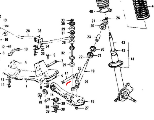

I think I hope I may have it. I was able to duplicate the sound by locking the steering wheel, wheels up, push hard 9/6 one way to "set it" then pull back and pop.
I found the control arm bolt (17mm) less than torqued to spec (I got a socket on one side a wrench on the other) I could turn it pretty easy, not loose mind you but def not uga uga uga tight.
any way tightened it up, check the other side (it was fine) and could no longer duplicate the pop with the car wheels up. Again too late to test drive tonight have to go clean up and call it a day.
I think I intentionally delay testing like this so I can at least think I have if fixed. Will check in the morning and report back. So anyone else forget to tight the control arm bolts and if so do you recall any odd clunking sounds?

Fixed!
so bottom line is if you have worked on the front suspension make sure you torque to spec. I am not sure but the nuts may have nylon locking, perhaps one use only. I will check again to see if anything loosens up.
to recap the situation, the noise would present when I would back up, turn one direction, then reverse steer while going forward after backing up. a noticeable "pop" or "clunk" would be heard in the front of the car with a slight release feel in the steering wheel. I presume I was shifting the control arm bushing ever so slightly. It has the original control arm bush (front control arm).  I have new OE bushings on hand, but since I did not install them I presume I had the arm off and check them and decided not to replace.
