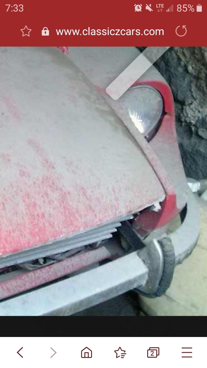

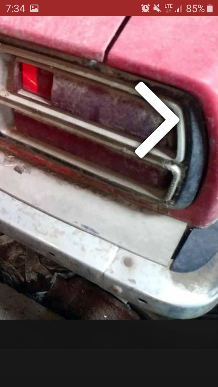

May 22, 20205 yr Author comment_599994 1 hour ago, siteunseen said: If it's been sitting for 15 years don't try and crank it if you haven't already. That's a lot easier said than done. This is good to read over. It's a little heavy handed for me but still great information. Thank you! great info, and yes I´ll be very careful when I pull it out. Right now its almost in"barn find" condition, tons of dust! here are a few pictures. As for its history; I don´t really know much, it was originally sold in Texas, at some point it was imported into Mexico and was registered in a State in the center of the country, the weather is rather dry and hot there and then brought to Mexico City where as I said it has spent most of its latest years stored where you see it here. Like I said before, I don´t think its too rusty, the interior is quite complete (only lacking the rear inner trim, the piece that covers the back of the tail lights), the seats, vinyl and carpet look Ok. It´s got an automatic transmission but apparently no AC (strange for a Texas car I think) Obvioulsy that´s not the original body color, it was probably white? anyway I think I´ll do something about it (or the interior color) since I´m not very much into that red on red combination. You may also notice the wrong rear end. Well it turns out that one of the original tail lights had a broken lens and since 240Z are VERY scarce here in Mexico, the closest my father could find in a junk yard was the rear panels and tail lights from a 260/280 and grafted it figuring it didn´t make much of a difference. Fortunately he kept the old (original) panel pieces and tail lights and refitting them is among my plans in a short term. As for the engine, I believe it was working right but at some point my dad read that webers were a big thing among 240Z enthusiasts and got himself a kit with triple ones. Of course he didn´t have any experince with that particular swap (he ´d been a car collector for many years and came to had a very reasonable little collection of old and special interest cars, a well appointed garage and tools but certainly it was way over his head here) he told me that it actually started but just couldn´t get to properly tune the carbs and at some point the car started to smoke a lot, he realized that modification didn´t really suited him (since he was never into racing or high power tunning anyway), then sold the weber kit ,reinstalled the original SUs and left the car where it sits now, he probably never fired it up again. Edited May 22, 20205 yr by julitoMX_1964 Link to comment https://www.classiczcars.com/forums/topic/64054-greetings-from-mexico/#findComment-599994 Share on other sites More sharing options...

May 23, 20205 yr comment_600001 That looks like a '73's bumpers. Look at the manufacturer date plate on the drivers side door jam. If 9/72 they consider it a '73. The '73s have a slightly beefier bumper mount. The are a little farther out from the body and have heavier duty mounts. Still, a fantastic car. Slightly different from a '72 though so keep that in mind when ordering parts. Cheers! Edited May 23, 20205 yr by siteunseen Link to comment https://www.classiczcars.com/forums/topic/64054-greetings-from-mexico/#findComment-600001 Share on other sites More sharing options...

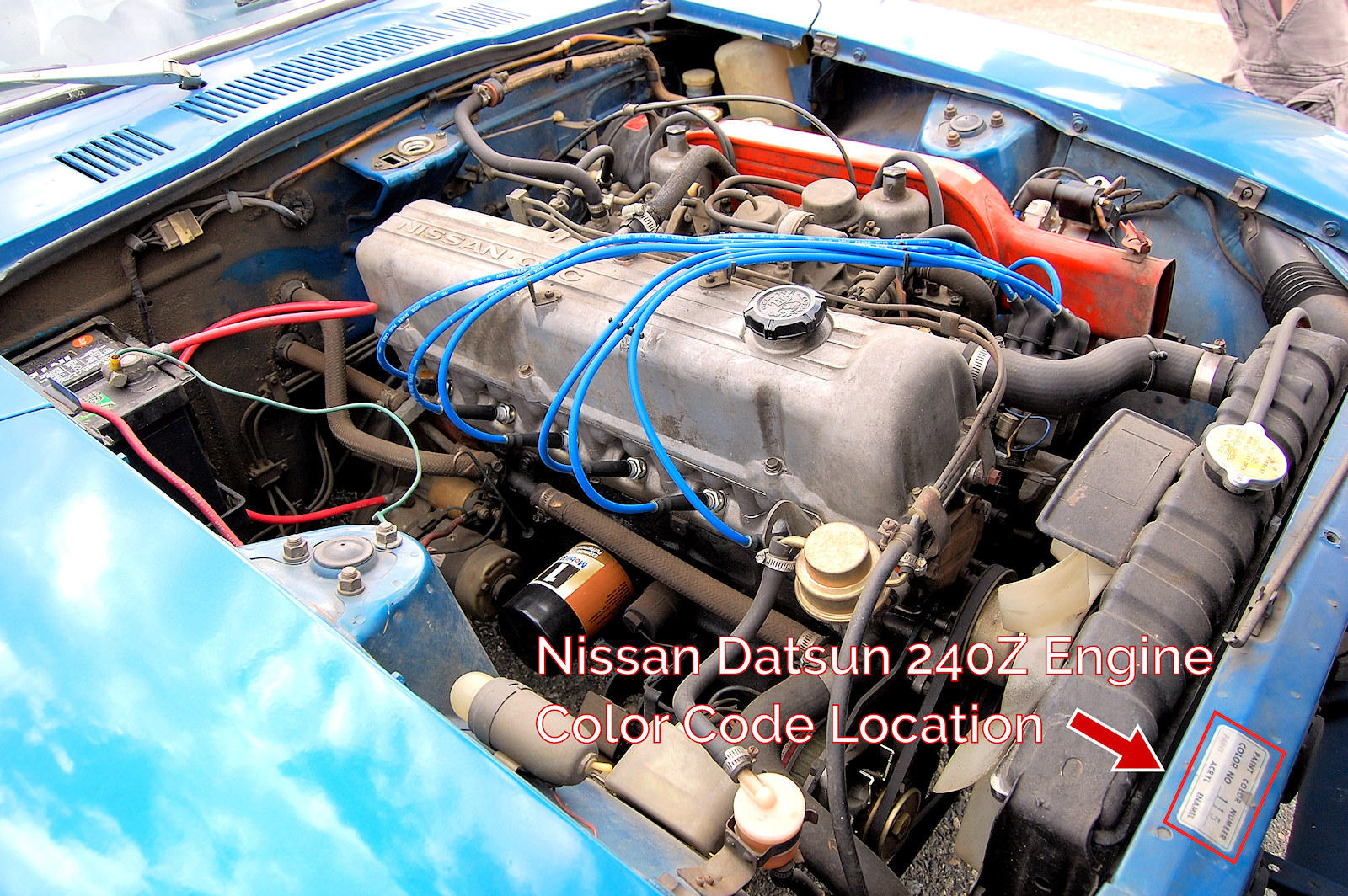

May 23, 20205 yr comment_600003 Could have been silver originally? Those look good like the old Porsches. Look for the color code on the radiator support. Then look it up here... http://zhome.com/History/ZColorGallary/index.html Link to comment https://www.classiczcars.com/forums/topic/64054-greetings-from-mexico/#findComment-600003 Share on other sites More sharing options...
