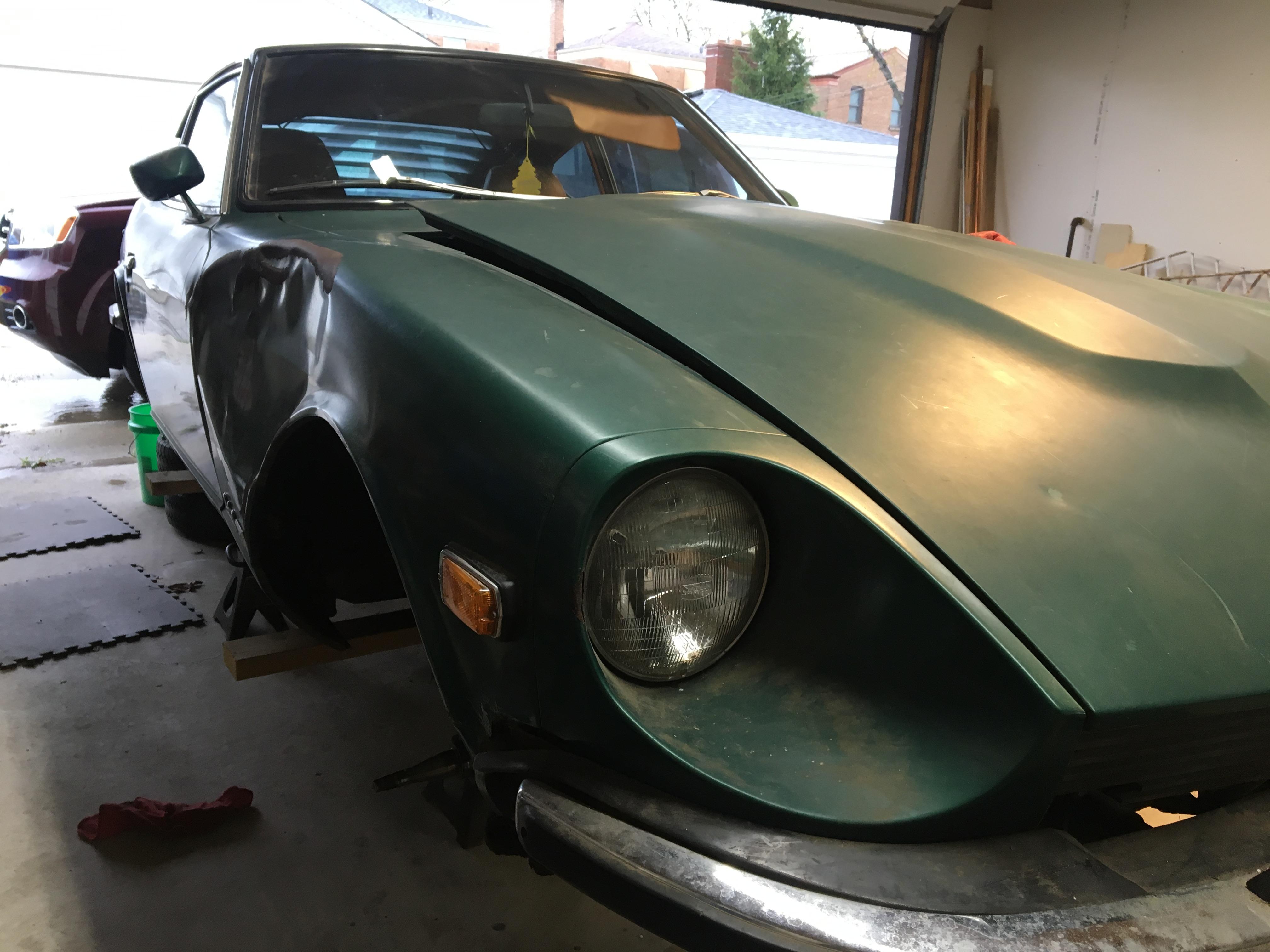

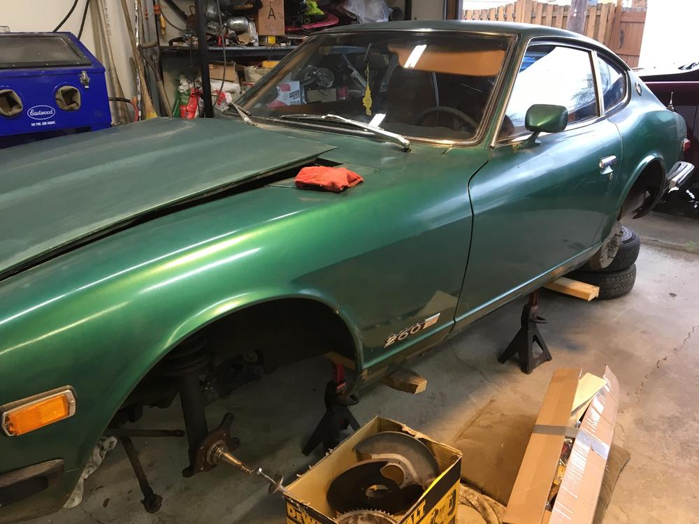

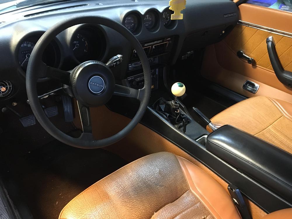

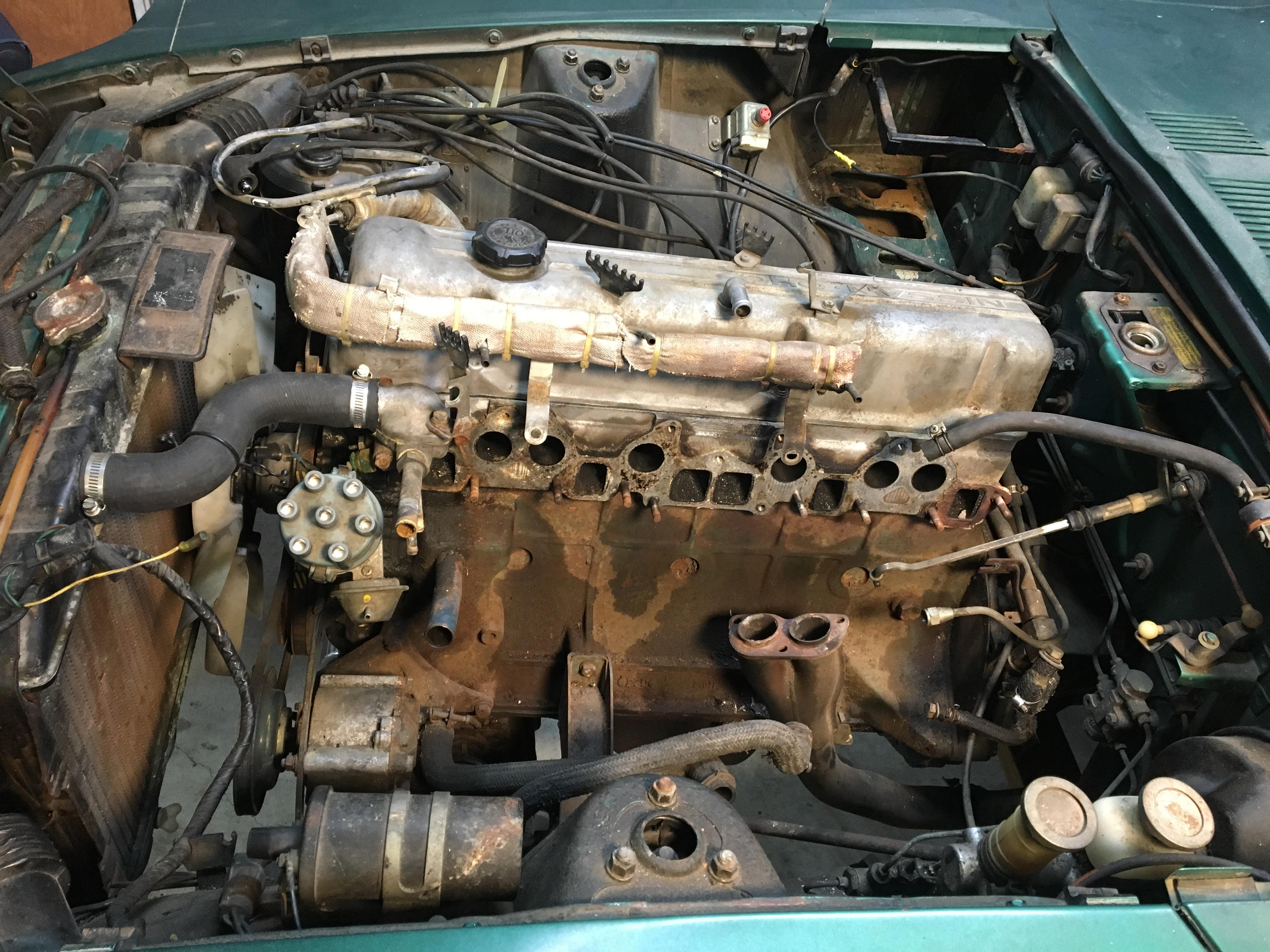

Been away for a minute guys. Thanks for the good info Dave WM. The engine is free and was able to turn over. The gas tank was empty so hopefully this helped with rust issues.(it evaporated or that’s why I couldn’t get it to start a few years back lol) ordered a bunch of stuff from z store and a pair of round top carbs from z therapy. Going to check all brake and fuel lines and replace shoes, pads and bushings and ball joints on front end. Took a few pics and going to get done what I can in my free time. thanks again all
