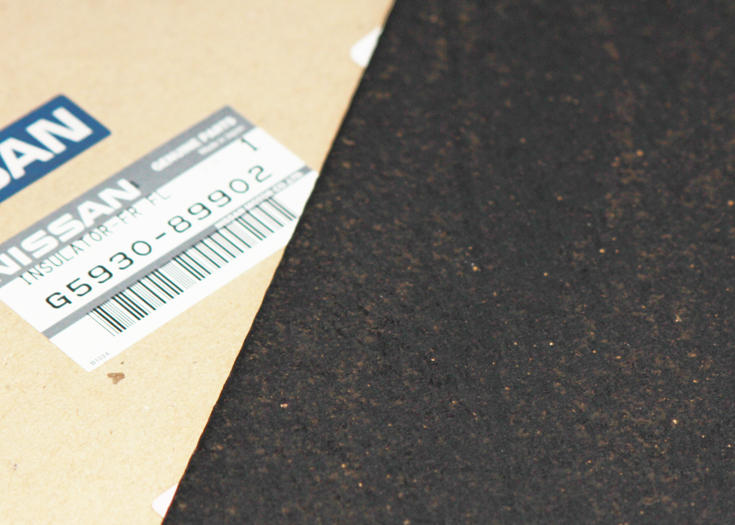

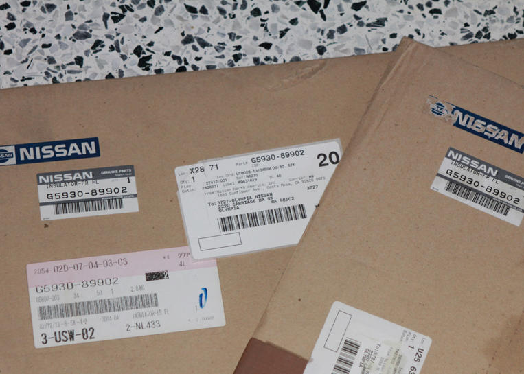

February 18, 20205 yr comment_592717 10 hours ago, zspert said: I finally had a chance to dig through the archives for those sound deadener part numbers. they are, or were, G5930-89904 and G5930-89902. I last bought any 9/07. I can't remember which is thicker (cargo area) 89902 is for the floor and 89904 is for the "package tray". Both still available. Edited February 18, 20205 yr by 26th-Z Link to comment https://www.classiczcars.com/forums/topic/63395-mint-71-240z-more-fun-coming-to-bat/?&page=32#findComment-592717 Share on other sites More sharing options...

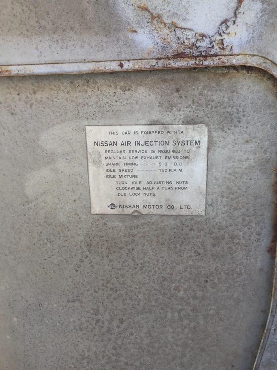

February 18, 20205 yr comment_592718 Agreed that the stickers were factory applied. The market designation was part of the build sheet, no? Link to comment https://www.classiczcars.com/forums/topic/63395-mint-71-240z-more-fun-coming-to-bat/?&page=32#findComment-592718 Share on other sites More sharing options...

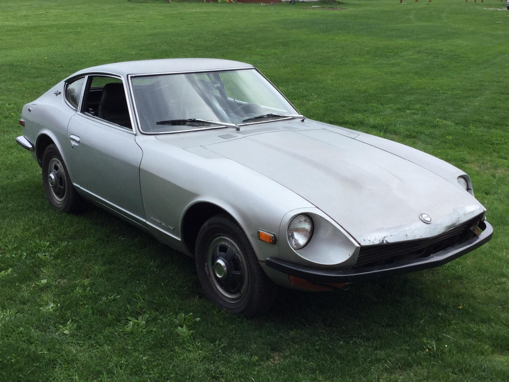

February 18, 20205 yr comment_592720 HLS30-00187 Link to comment https://www.classiczcars.com/forums/topic/63395-mint-71-240z-more-fun-coming-to-bat/?&page=32#findComment-592720 Share on other sites More sharing options...
February 18, 20205 yr comment_592721 1 hour ago, 26th-Z said: 89902 is for the floor and 89904 is for the "package tray". Both still available. Actually, I believe G5930-89902 is discontinued. And though I was able to buy G5930-89904, it appears to be about .060" in thickness, and what I took out of my 1971 from the tunnel (floor "mat" was already gone) is about .090". Package shelf appears to be about .090" as well. It would be nice to confirm original thickness of the pieces for the floor and the tunnel, as well as the rear deck, for US cars that had all three. Going to put this in another thread. Link to comment https://www.classiczcars.com/forums/topic/63395-mint-71-240z-more-fun-coming-to-bat/?&page=32#findComment-592721 Share on other sites More sharing options...
February 18, 20205 yr comment_592723 33 minutes ago, 240260280 said: HLS30-00187 Great, than this is solved! Same as on my #672 is #187 drivable now?? Link to comment https://www.classiczcars.com/forums/topic/63395-mint-71-240z-more-fun-coming-to-bat/?&page=32#findComment-592723 Share on other sites More sharing options...
February 18, 20205 yr comment_592726 187 circa 2017 pulled from the Hoover bag ? Looks nice! Edited February 19, 20205 yr by 240260280 Link to comment https://www.classiczcars.com/forums/topic/63395-mint-71-240z-more-fun-coming-to-bat/?&page=32#findComment-592726 Share on other sites More sharing options...
February 18, 20205 yr comment_592727 1 hour ago, inline6 said: Actually, I believe G5930-89902 is discontinued. And though I was able to buy G5930-89904, it appears to be about .060" in thickness, and what I took out of my 1971 from the tunnel (floor "mat" was already gone) is about .090". Package shelf appears to be about .090" as well. It would be nice to confirm original thickness of the pieces for the floor and the tunnel, as well as the rear deck, for US cars that had all three. Going to put this in another thread. How many of each part number are required for a car. Will 1 box of each be enough? Link to comment https://www.classiczcars.com/forums/topic/63395-mint-71-240z-more-fun-coming-to-bat/?&page=32#findComment-592727 Share on other sites More sharing options...

February 19, 20205 yr comment_592758 8 hours ago, SpeedRoo said: How many of each part number are required for a car. Will 1 box of each be enough? You get two sheets in the box with an order quantity of 1 of part number G5930-89904. Each is about 3 feet square I think. One box is not enough to do the full car, and maybe not even both floors in front and under the seats. And again, it doesn't look to be the right thickness. Link to comment https://www.classiczcars.com/forums/topic/63395-mint-71-240z-more-fun-coming-to-bat/?&page=32#findComment-592758 Share on other sites More sharing options...
February 19, 20205 yr comment_592759 Yes, model, therefore, market is indicated on a build sheet I have. Link to comment https://www.classiczcars.com/forums/topic/63395-mint-71-240z-more-fun-coming-to-bat/?&page=32#findComment-592759 Share on other sites More sharing options...
February 19, 20205 yr comment_592762 13 hours ago, 26th-Z said: Agreed that the stickers were factory applied. The market designation was part of the build sheet, no? Can you post the build sheet? Link to comment https://www.classiczcars.com/forums/topic/63395-mint-71-240z-more-fun-coming-to-bat/?&page=32#findComment-592762 Share on other sites More sharing options...
