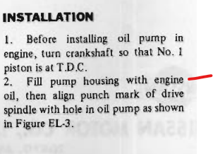

It could be that the oil pick up tube needs to be primed, at any rate pull the pump and have a look at it. If the oil pump was working fine when the car was parked then there is no reason I can see that it isn't working now, they don't just fail, they wear out over a long period of time.

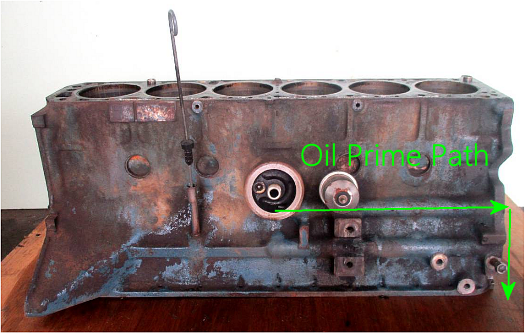

Thanks, Once I pull the oil pump can I prime the pick up tube from there? Goes from pan up and over thru pump first then filter then to cam lobes?
Once you drop the oil pump look up where the pump mates to the block, you'll see 2 holes about a 1/2" in dia, one goes to the filter and the other one goes to the pick up, use a turkey baster to squirt lots of oil in, the filter hole will drain back toward you right away, the other should take the oil, that's the pick up tube.

You can remove the oil filter and push a hose in the galley that goes to the front of the engine above the alternator then pump oil into the hose.

I think I would try priming the system through the oil sender switch port. Removre the oil sender switch and find a fitting that will fit.
Any pump will do to pump some oil in. Even a simple bicycle pump will do. I don't think you need a new pump because it has been sitting for a while. It is just being difficult to prime after sitting so long.
