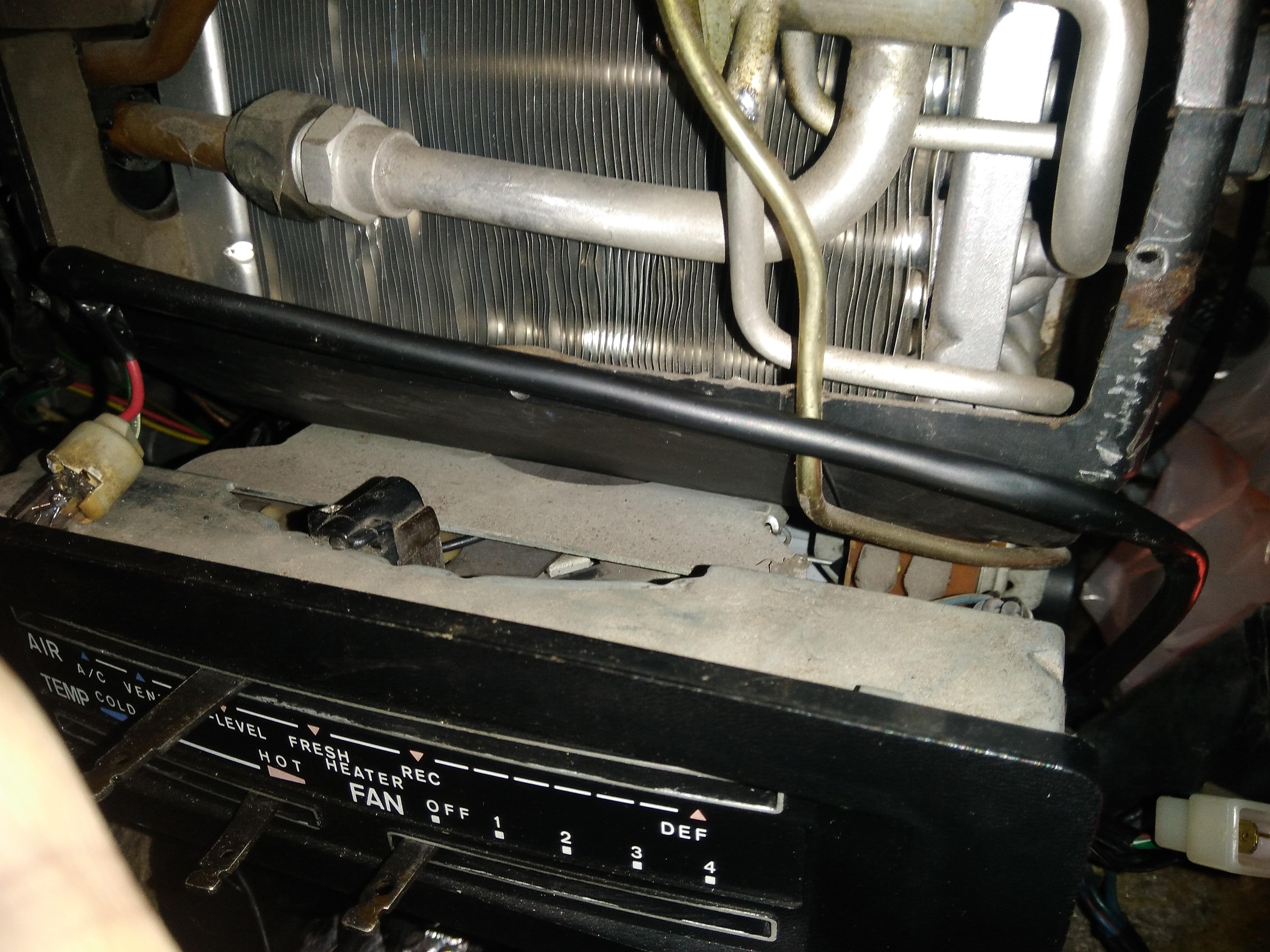

John,  looking for the lamp / cable with T plug for the heater control panel.  The socket is broken on the 280 I'm working on.  Easy to remove, just the 4 screws holding the trim panel on.   Lamp plugs in where the black socket is above "Fresh".     Enjoy your yard adventure ...
Its a complete assembly, a cable with the socket for the bulb on one end and the T connector on the other end.   In the pic you can see the black cable running from the broken socket to the connector on the right.   I think the socket gets brittle and breaks from the heat of the bulb over time.
