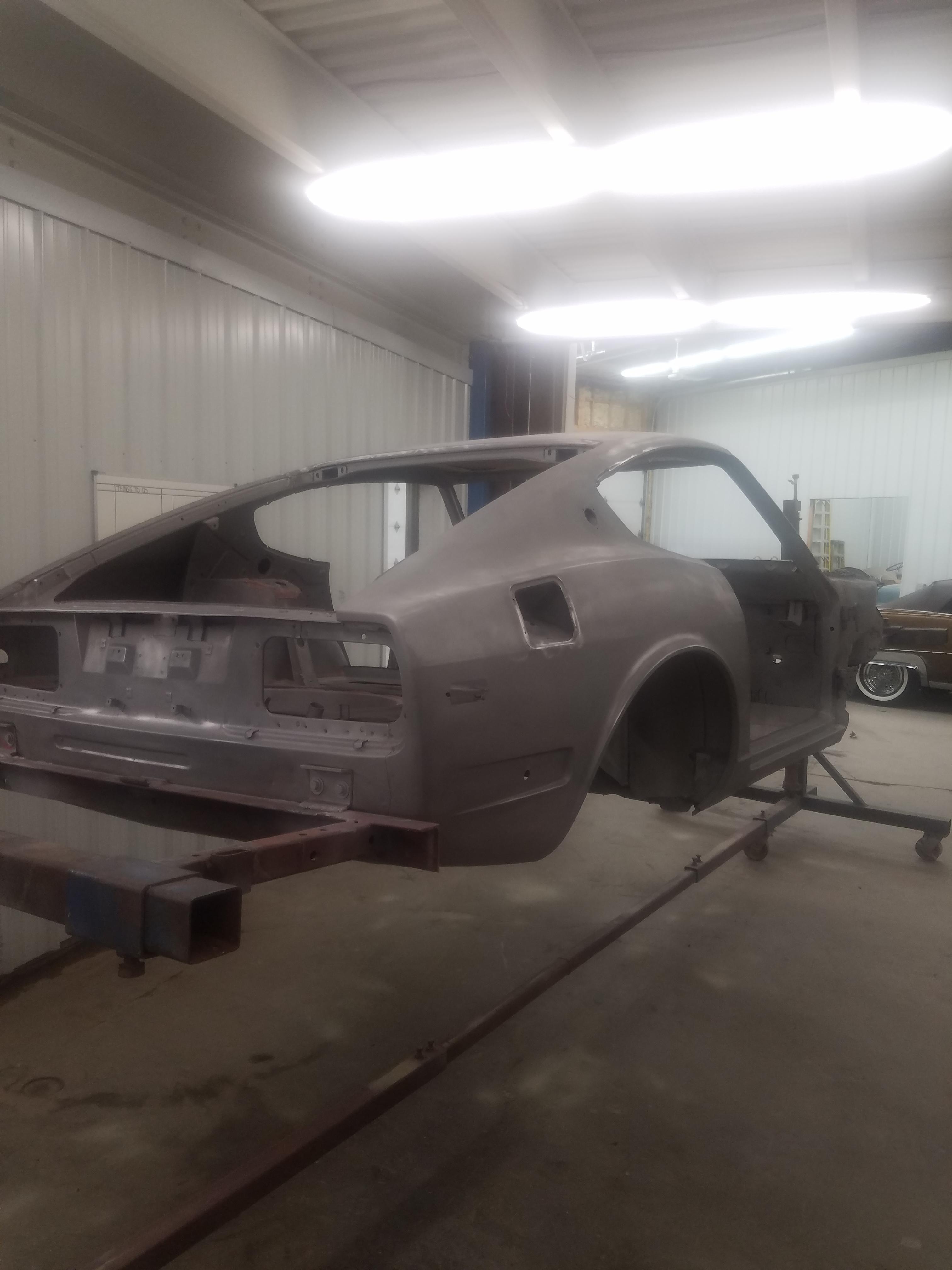

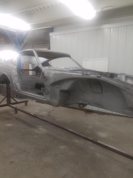

I have the shell of my 240 at the body shop and I need to make a decision on the fenders.  The right side has already been patched on the bottom and has a decent amount of rot and the left side is pretty much junk.  I've been looking at possibly just getting replacement fenders but i'm not sure if anything out there is good.  Z-car depot has fenders listed but they also state that they may not fit right.  Ebay also has fenders but I'm guessing that they are the same as the ones Z-car depot sells.  Z-car source offers "refinished" fenders which appear to be used fenders that they did some work to.  Any thoughts?  Thanks!
Also- (poor quality) progress pics!
