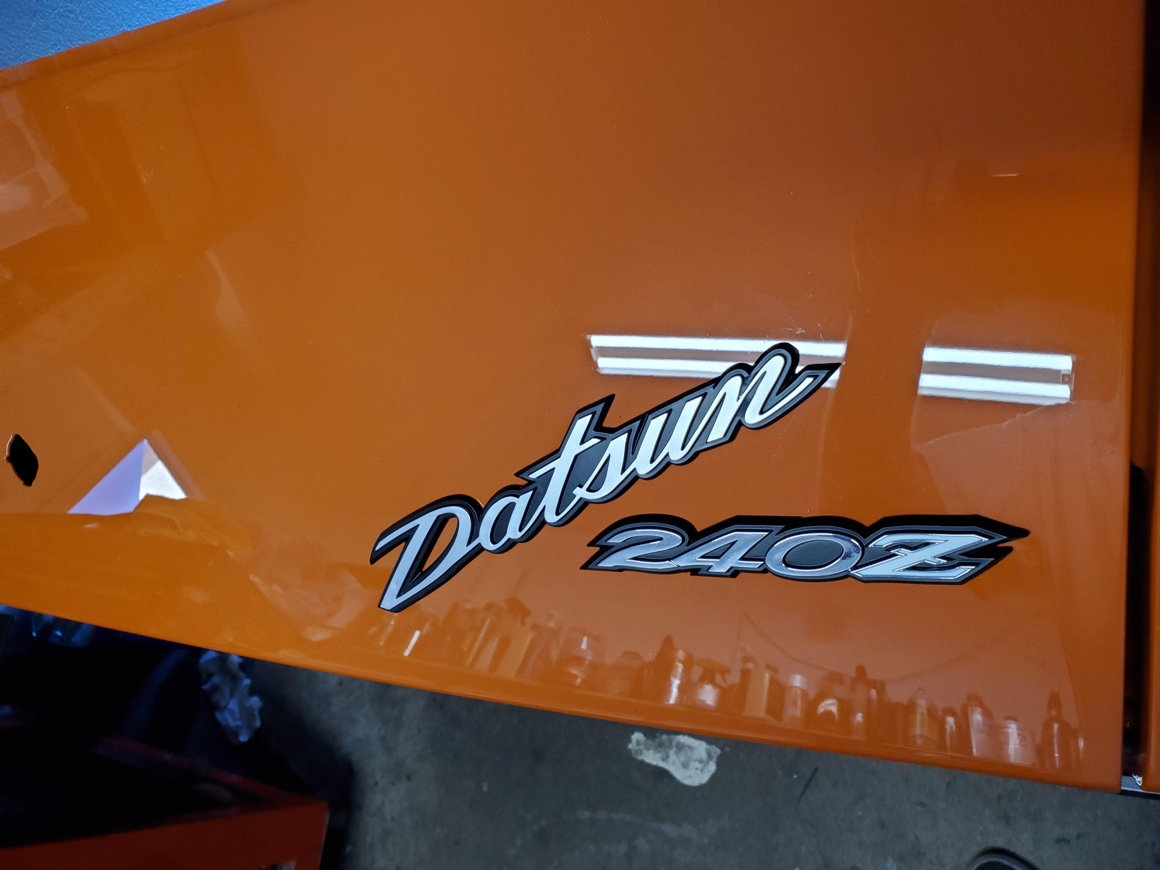

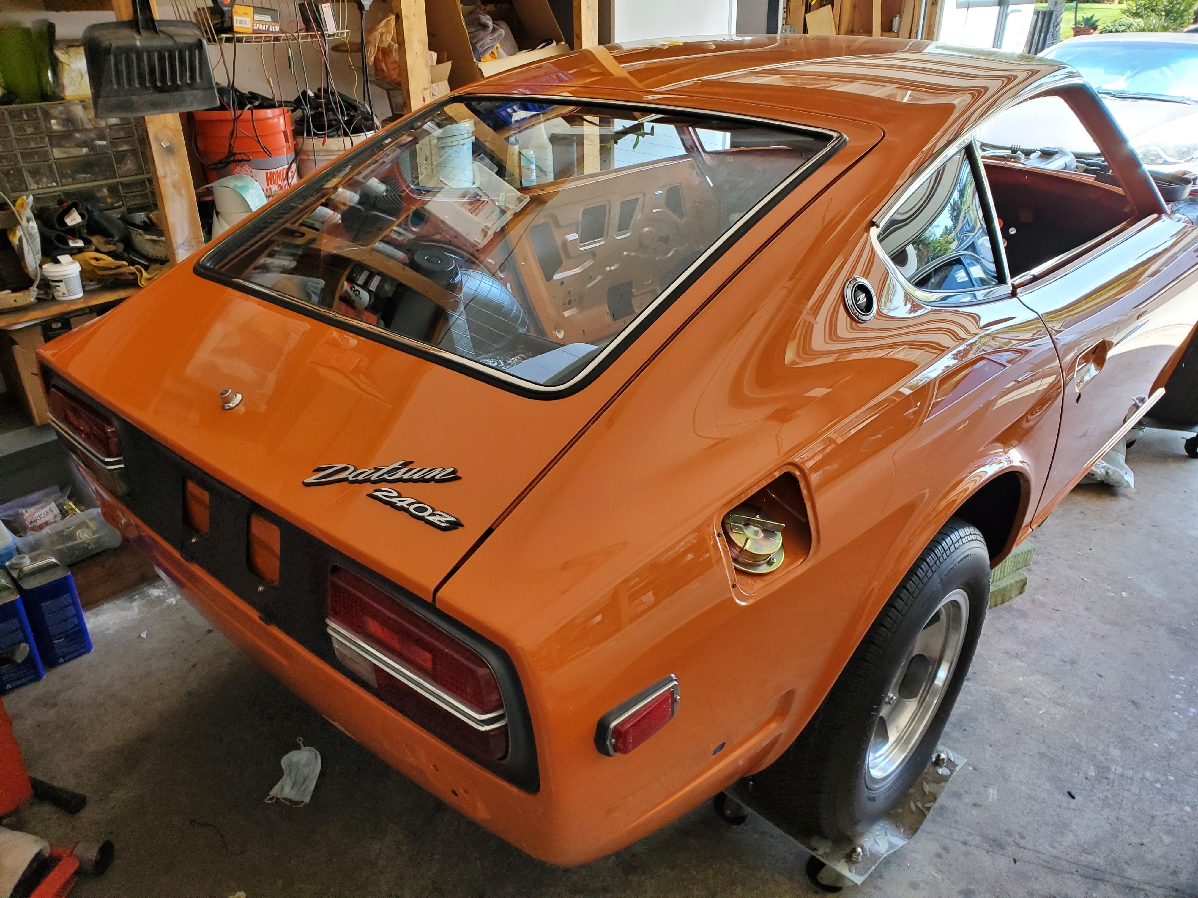

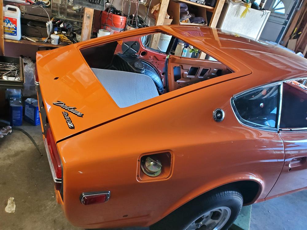

On 8/3/2020 at 9:59 AM, motorman7 said:
She's Orange!  Nice to have the paint done.  Will dry and then get color sand.  This might be at my place in a couple weeks.  I am so ready.
Looks fantastic.
What paint was used? Acrylic enamel, like original? More modern base coat clear coat?
10 hours ago, Racer X said:
Looks fantastic.
Paint is modern base and clear coat from PPG, 918 Orange

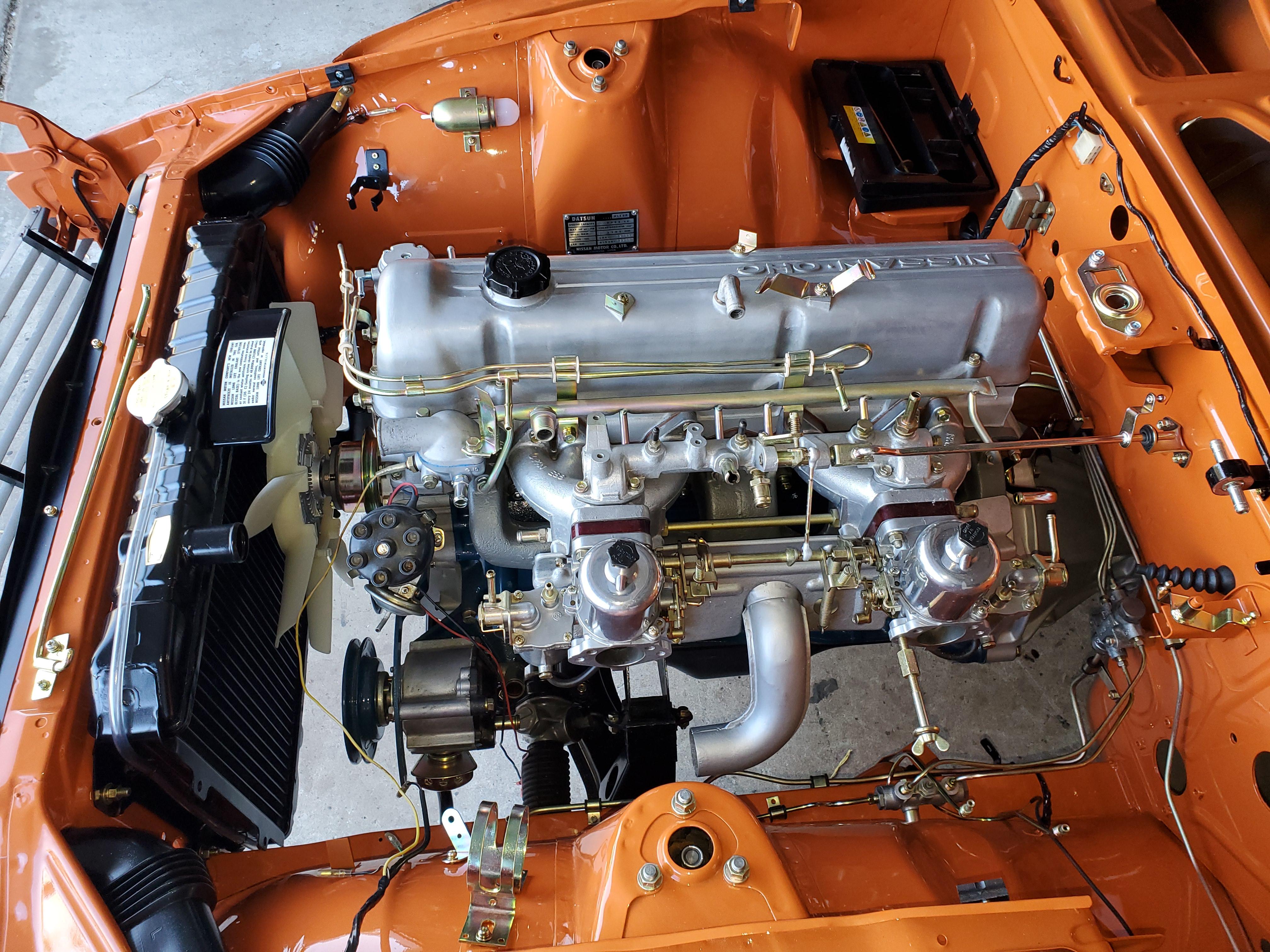

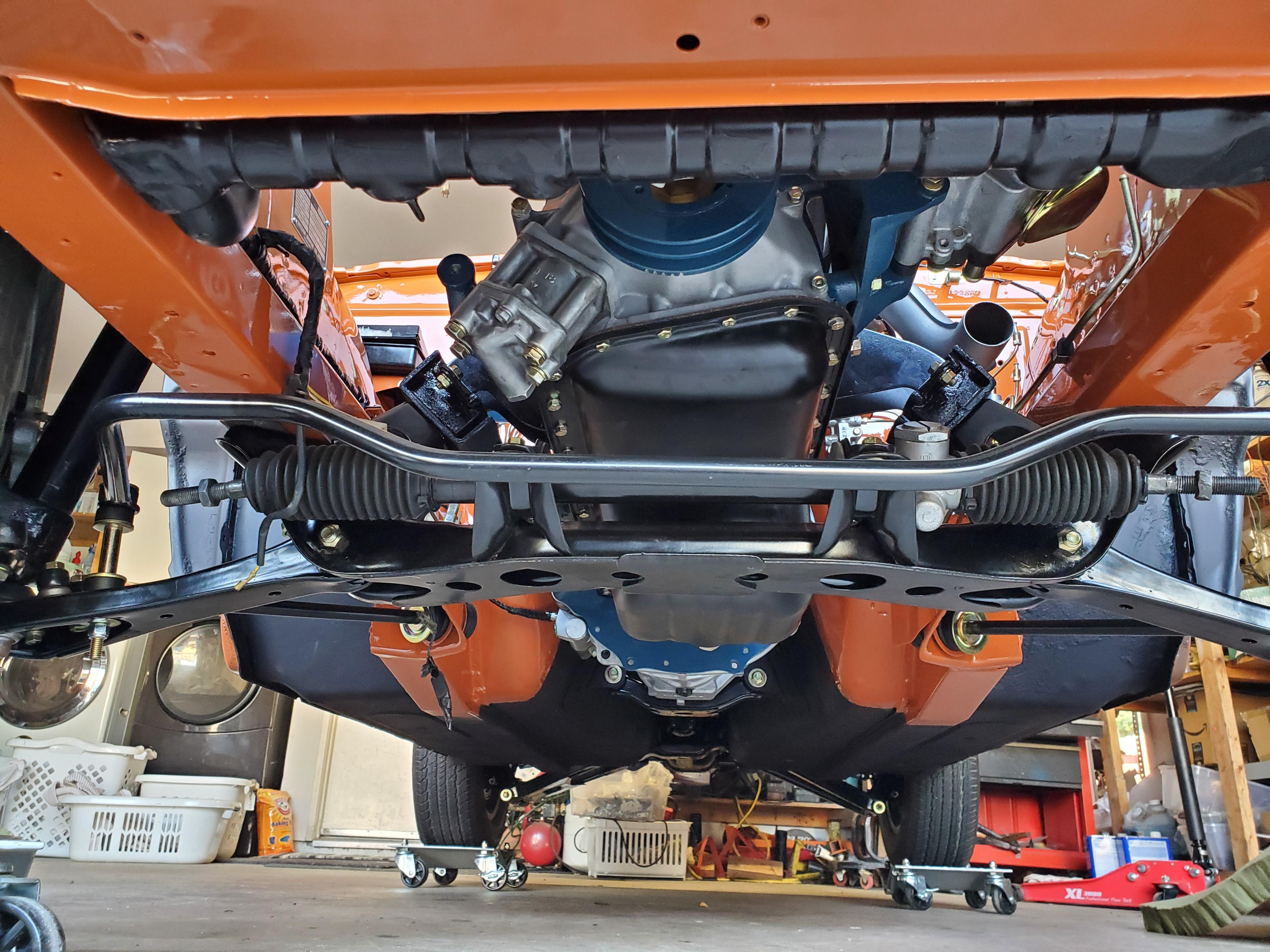

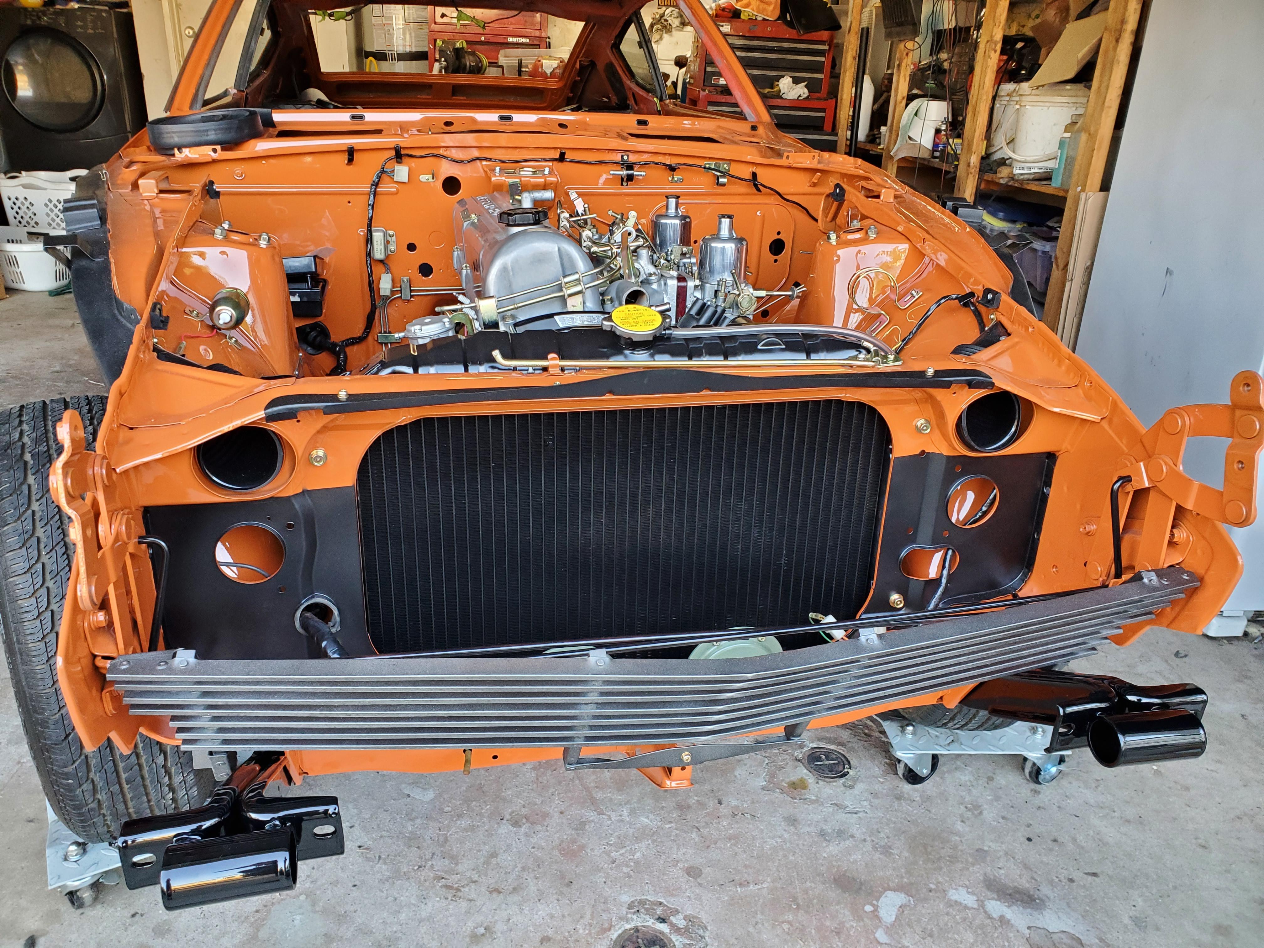

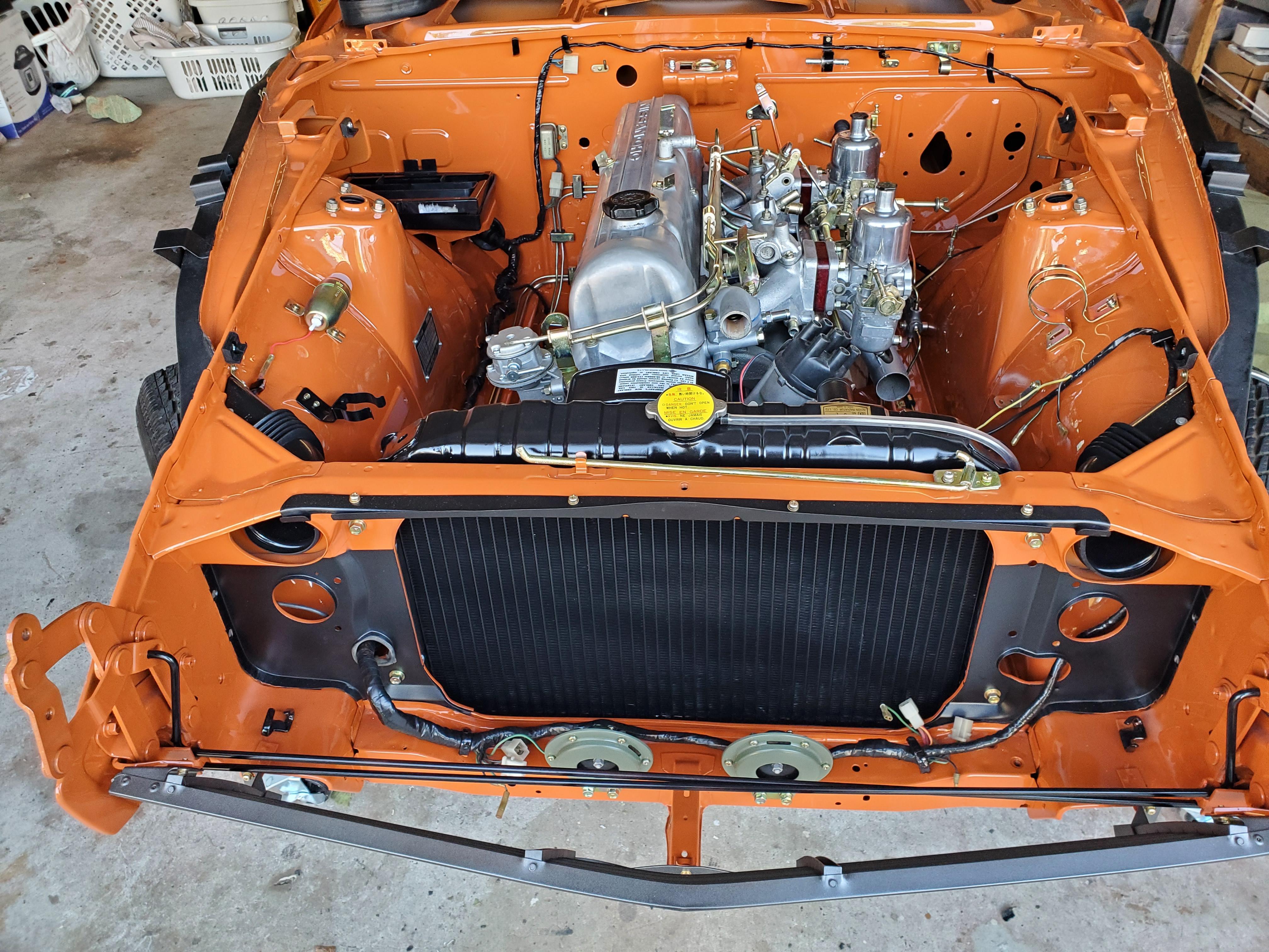

More progress.  Got the drivetrain completely installed along with the E-brake and rear hatch.  Also installed the manifolds and carbs along with radiator and fan.

What’s your rules for silver vs yellow plating? Looks like everything suspension/steering/drivetrain and engine bay gets yellow and silver for everything else?
also how did you finish your halfshafts? Is it clear over aluminum paint? Looks quite striking, only ever seen black used.
Do you just wire wheel and clear coat the gearbox case?
Ryan
Ryan
For plating, I try to keep everything as factory stock original as possible in regard to yellow and silver.  I am sure on some items I may be incorrect, but it is my best attempt to get things right.  I know the earlier Z's had a little more silver items than the later Z's, so not really sure at what times the changes took place.  I did notice at the 2019 ZCON, most judges had no idea what was correct so I wasn't marked off for any plating discrepancies.  However, Jim Fredericks was there and was able to teach me a bit on some items that were not correct, so I try and learn from those instances.
For the half shafts, since most of the original black paint is usually gone, I typically just strip and clear coat.  Sometimes the metal is stained so I paint with flat aluminum and clear or plain aluminum and matte clear.  I know they are supposed to be black, but it gets kind of boring under there with everything being black.  So, I do take a bit of artistic license on the half shaft, as well as the back of the differential which should also be black.
For the trans case, I hit it with the fiber wheel and clear coat.  Wire wheels usually scratch too much.  Again, if the housing is pretty stained I will paint with flat aluminum then clear coat.

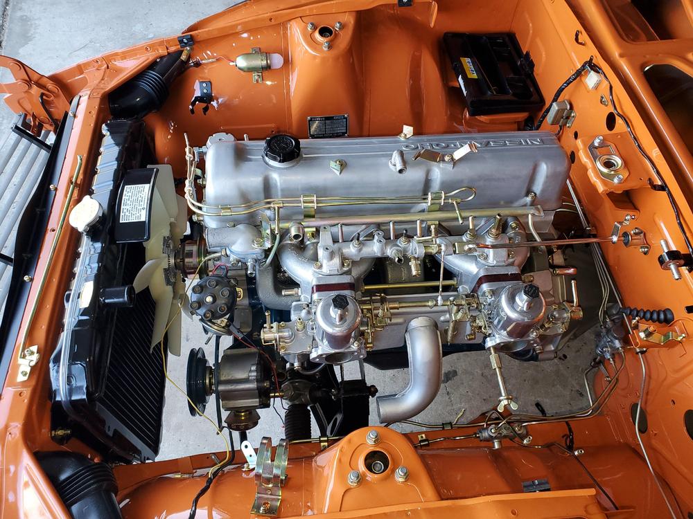

Also, for the valve cover, I now just clean with steel wool and phosphoric acid (wear gloves and goggles).  After the cleaning, I use a little Maguires aluminum polish just as a preservative.  I prefer the light bead blast look, but got dinged for that at ZCON.  Ideally, I should probably look into vapor blasting for the cover.
Rich
Rich

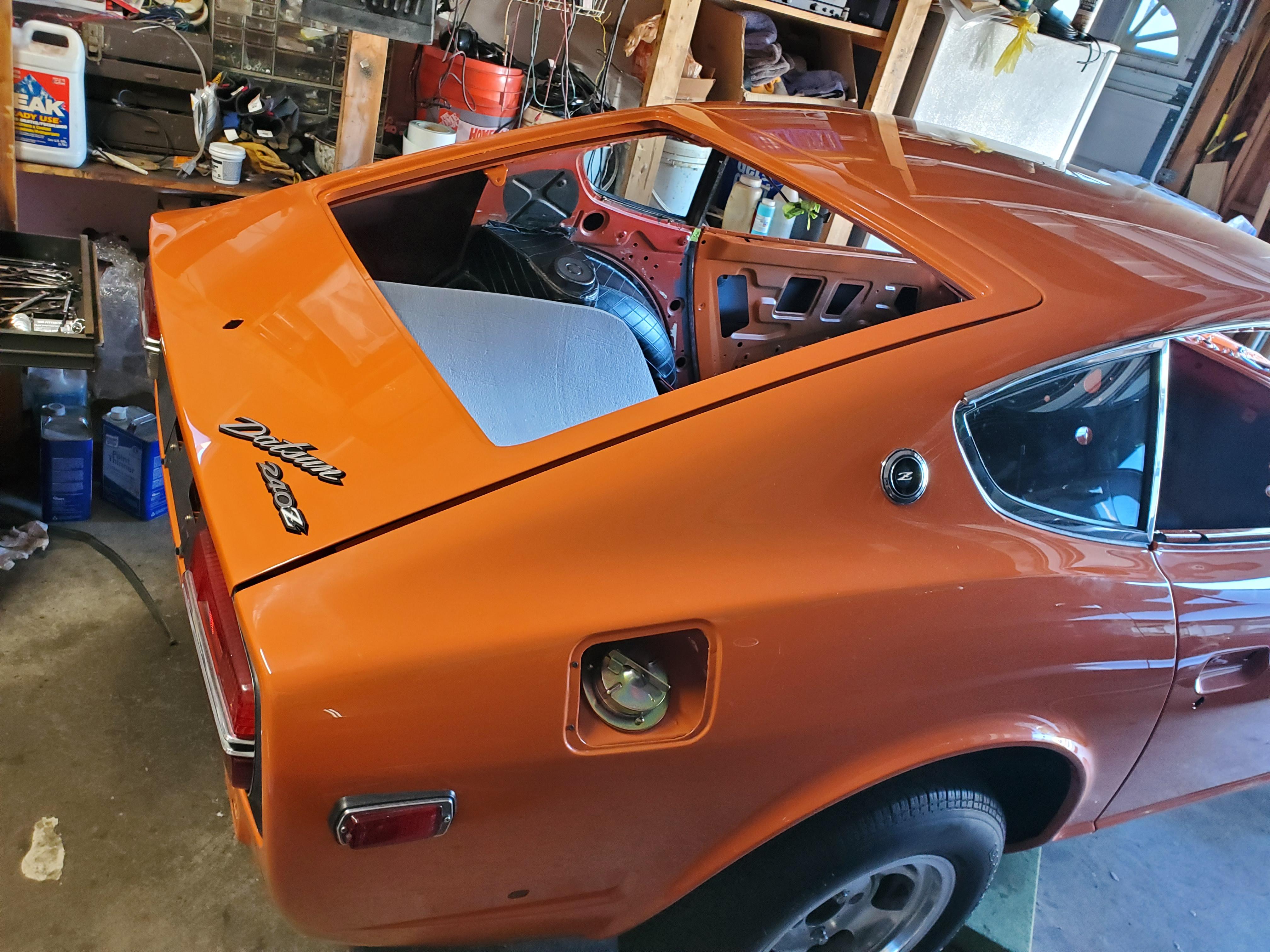

Got the rear hatch glass installed.  It was quite a challenge as it was a bit older gasket (customer provided) and somewhat stiff.  Had to  stretch it around the glass as the fit was tight. And, had to have my wife help me on the install, where  usually I can install the rear glass in about 10 minutes (Precision brand) all by myself.  On the flip side, the older gasket was a better fit and covers the corners better.  Also, it had some waxy substance on it to preserve it (I think) which made it a bit messy on the install.  I am thinking it was a factory gasket due to the nice fit for both the corners and the metal trim.

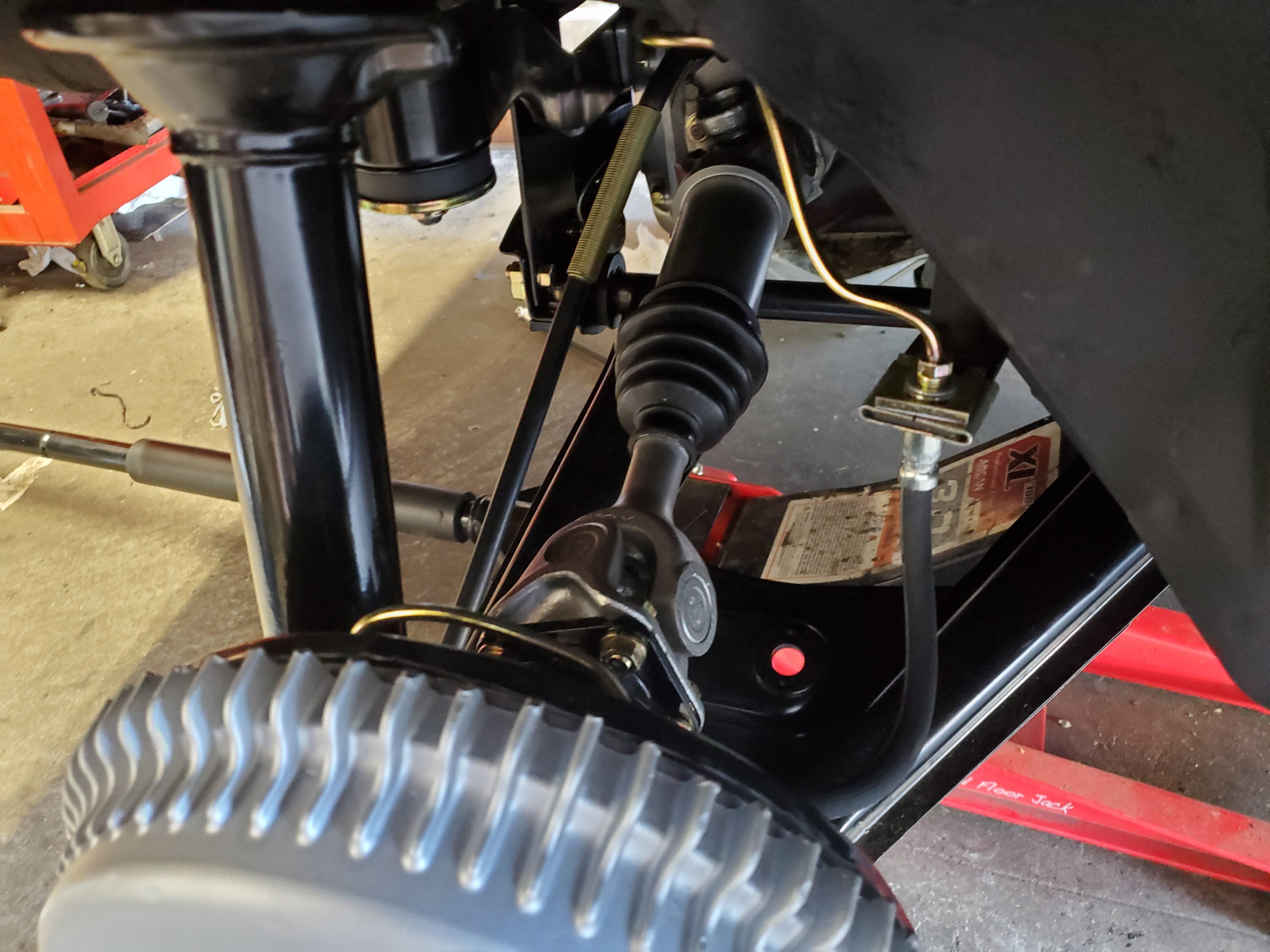

Also installed the front and rear brake flex lines and front bumper supports. The gloss black powder coat on the bumper supports looks beautiful....very shiny.
