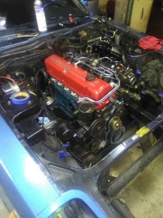

I've just gotten my engine installed in the car, and am pretty close to firing it up.
It's an F54/P79 out of an '82. It ran well when it was in the donor car. About 155k miles if I remember.
I kept the block as is, in other words, I didn't rebuild it. Just re sealed it. I did run hot compression checks in it when it was still in the rust pile it came out of. It was even across in the high 170's. I got lucky.
Anyway, I had the head shaved .080 as per the Z car garage write up. I gave the machine shop the parts and he installed them for me. It cost me about $350 after parts and labor.
It's kind of a budget modified build. Family comes first.
If you want the parts I used, I'll list them for you. When I get it running, I'll let you know how it goes.

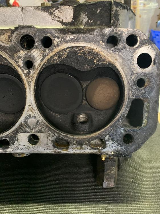

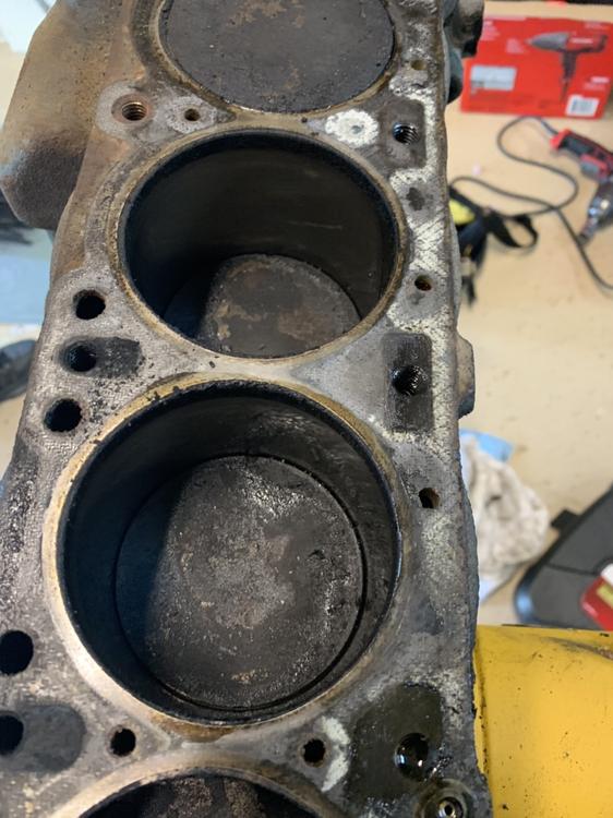

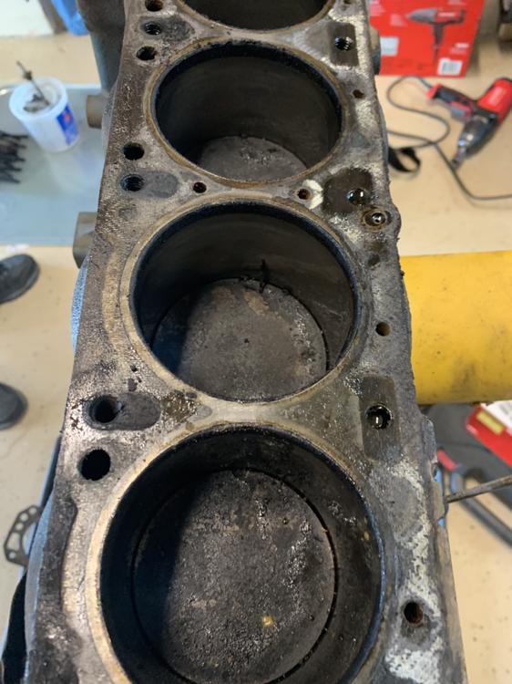

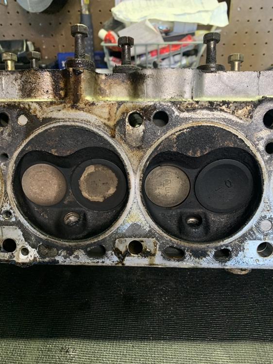

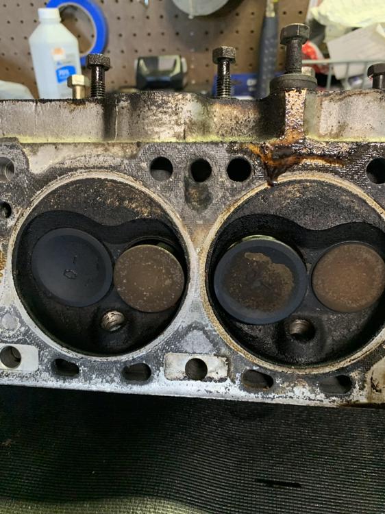

Okay, made some progress this AM. Had to invest in a 1/2 impact wrench to get the crank bolt off. Worked like a charm.
Head is off, no broken bolts. Lots of carbon build up but seems reasonable for 164k miles.
Oil pan is a disaster, dents everywhere and there was this extra metal strip on one end between bolts and pan . Looks like someone added it but maybe this is stock. See pics below I took. See anything that concerns anyone??
f6a4200e6fca6661832b86bae69a0dcb.jpgeae20a9b5df45f0bf82b57c2e3cc527d.jpg8c63fb922ed67492f7dc634da073806d.jpg4d4d2727fcddc3cb3507b60f6afc6a7f.jpg
f0c7640eeaf7d8af4b9b64912f1ce0ee.jpg0ec696d2b6788ad20eea8a486d22e0c0.jpg90cfdef736d1deb50a777a5142aac688.jpg086823089110f5b3328f5bfcbe256879.jpg27fef1d0949eab44fdc92d428e5bca9d.jpga76b2575d16273058099c88769a314f6.jpg8ca6405f12cd10e9fe8a5a4c42bc2a89.jpg
The oil pan flats are 2 piece.  Remember the oil pan bolts are different lengths.  The short ones go in the block holes that are exposed looking from the top.
Hold on!  I may be wrong on those bolts.  Seems to make more sense the longer ones would go through the flat pieces.  Count the holes of the flats vs # of long bolts.  I had a hell of a time with my oil pan leaking while it was still on the engine stand.  I over tightened them once at least.  Get a loaner inch pound torque wrench from a chain store.
