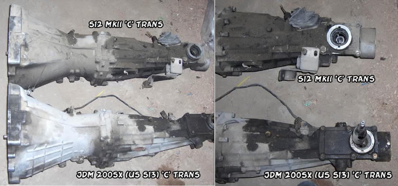

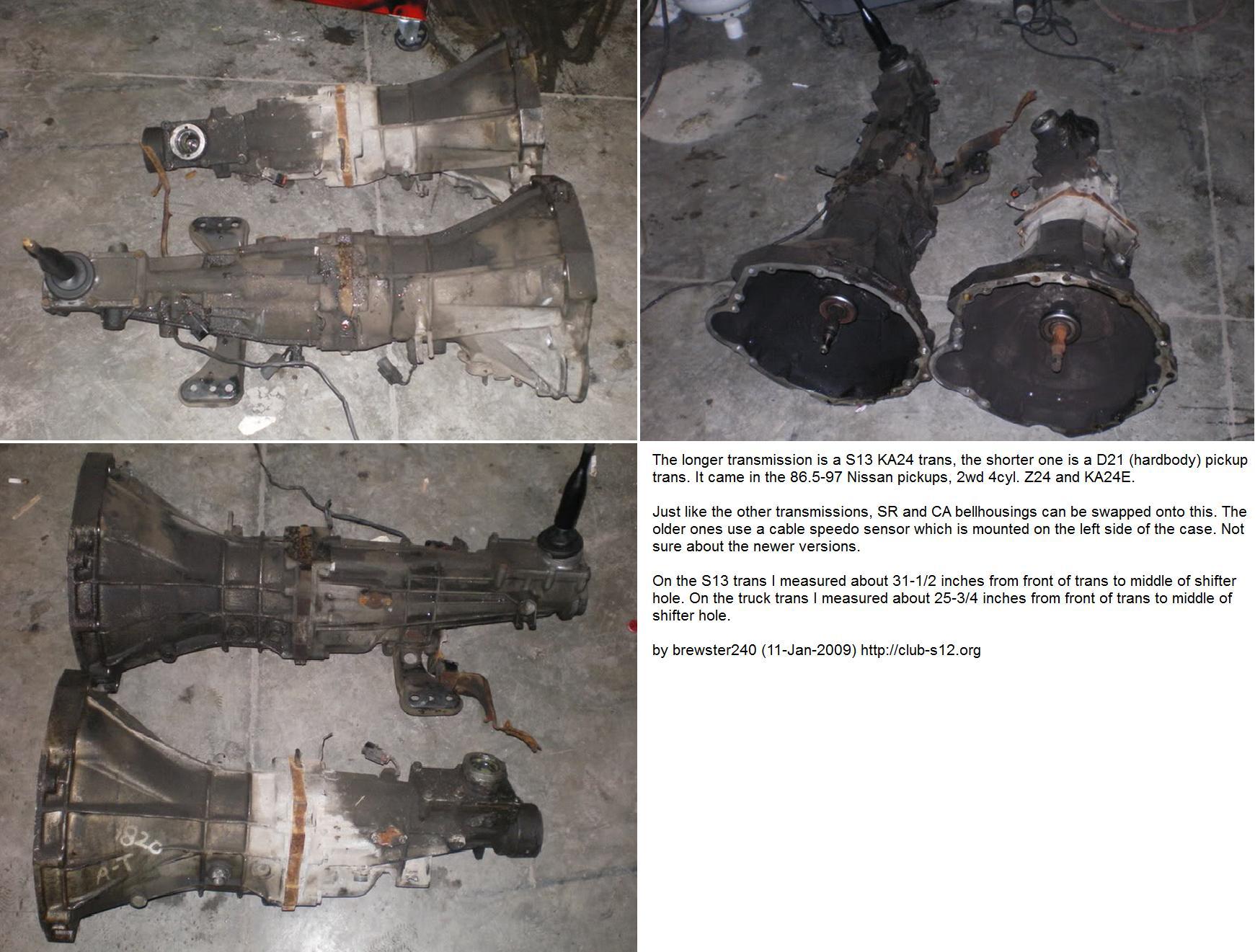

The problem with the 71C transmission is there are so many variants. I have heard up to 12, and that is not the ratios. I have two and they are different lengths.

I had a thread over on Hybridz about the variations and there are a bunch, with reverse synchro and double synchros on some gears, along with the different ratios and wider gears .  And they're not all called 71C, they go all the way up to 71H.  The truck variations might have the wider gears, outside of where the 240SX was sold.
