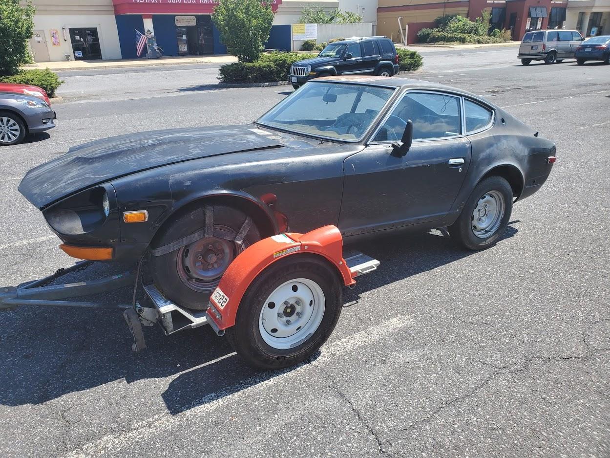

Well after purchasing a 71 240Z off Copart and basically receiving a polished turd due to all the internal frame rust issues, I did some searching and found a local early model 260 I will be able to start my 302 project swap on. Someone started this and made an attempt at patching the floor and sealed some things up, but I'm thinking it might be best to just replace the whole floor than to trust the segments of lap welds. The project is influence by @Home Built by Jeff and RWB Jeff, as well as many others and I can't wait to dive both feet into it. More to come as I get the old car out of the garage and the new one in, but I guess at least I have a parts car now ?

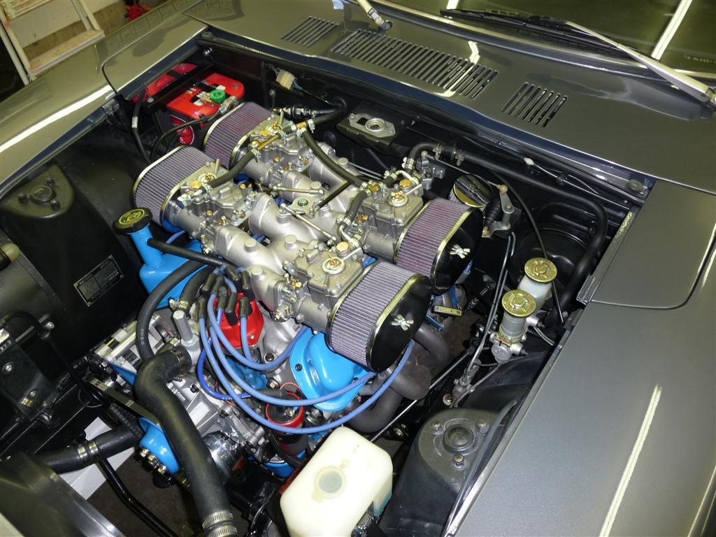

@grannyknot the Laine family page has is also a go to for me to setup the engine and transmission, that is such a gorgeous build. Planning on using the Apex Engineered suspension setup as well as I LOVE the look of the cantilever rear shocks in the back. I think that paired with the AGI roll cage (at least a copy of one made Stateside so I don't pay shipping from AUS) is going to be a kill combo. BUT I get ahead of myself, still have a lot of disassembly and some rust repair to start with :)

Here is a little inspiration, https://www.lainefamily.com/240Z_V8_Conversion.htm
I think that is a beautiful engine. Now imagine Jenvey ITBs instead of DCOE's!B)

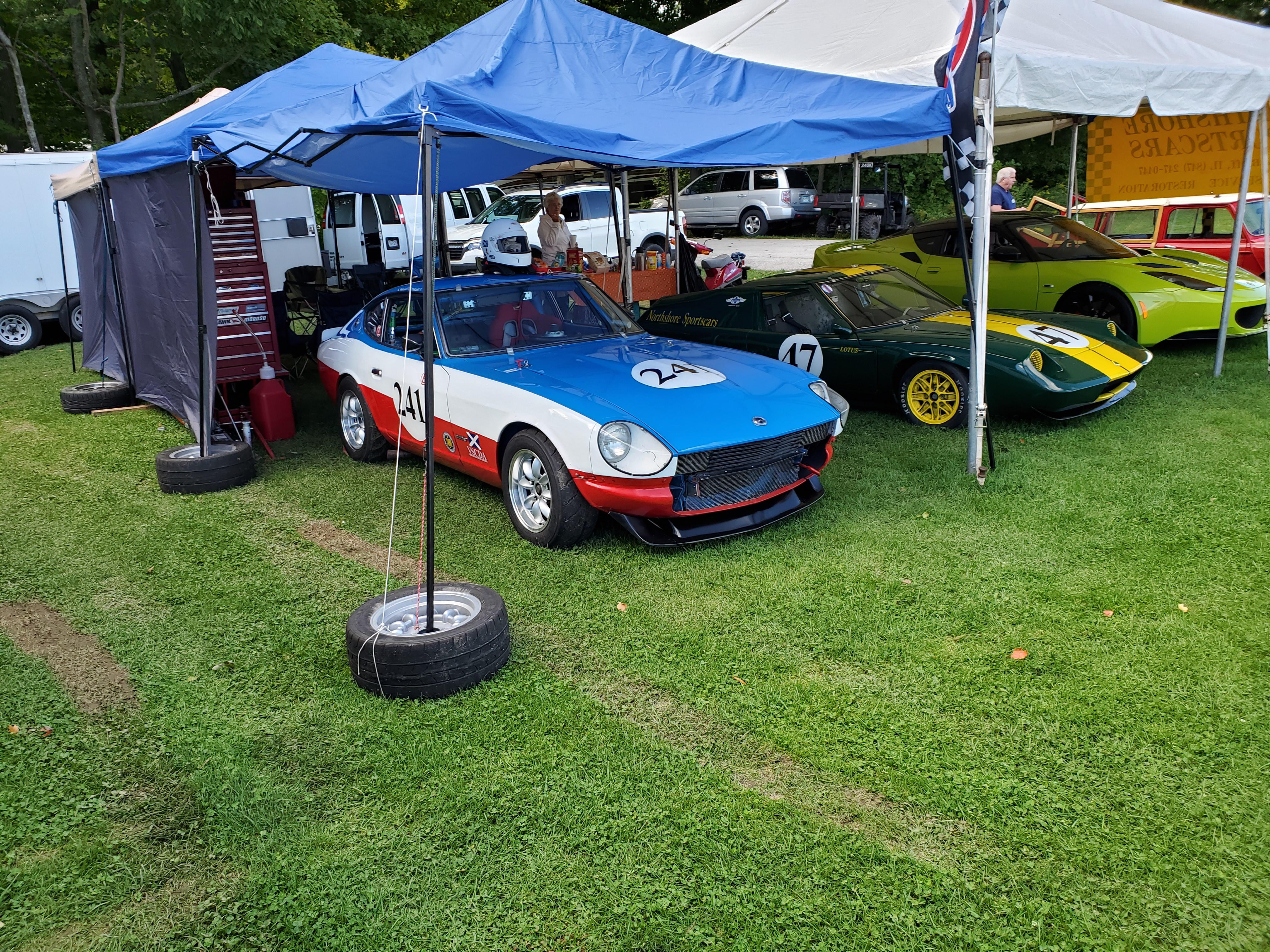

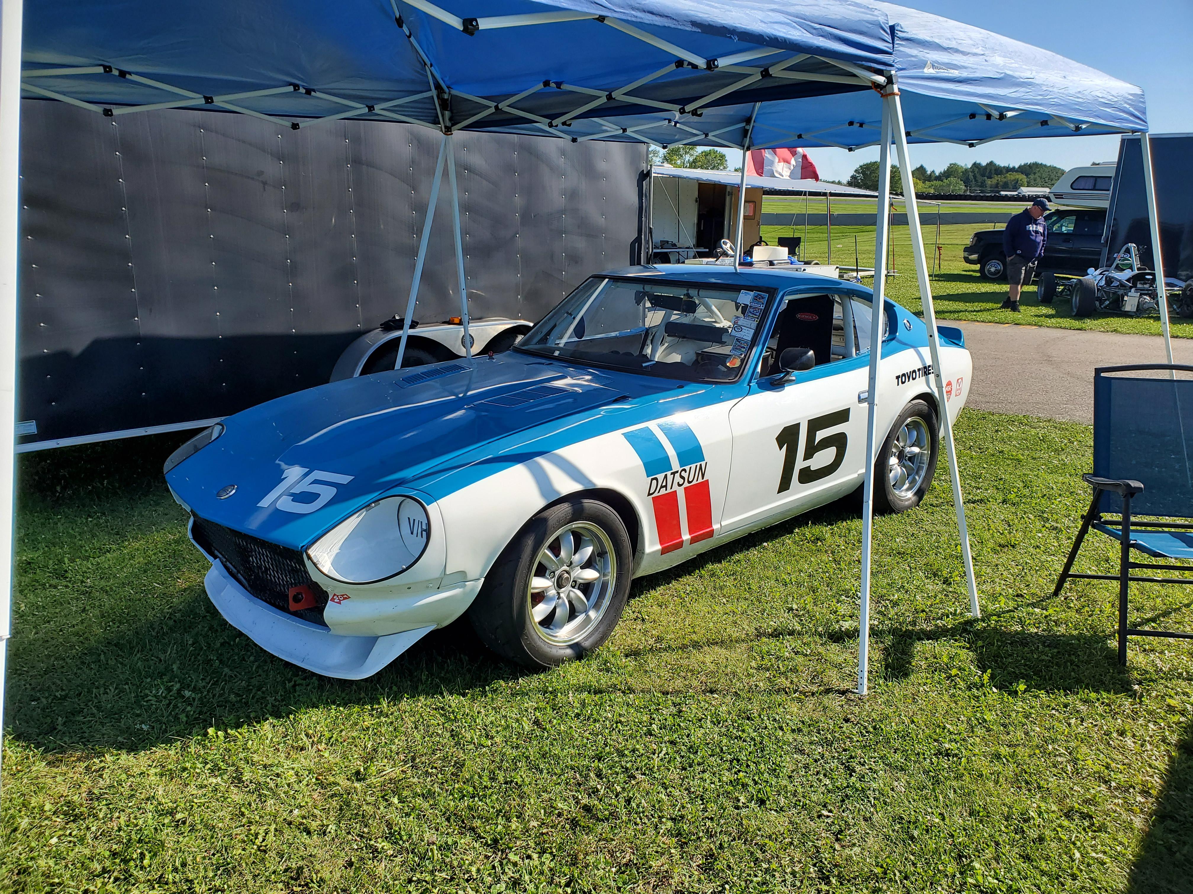

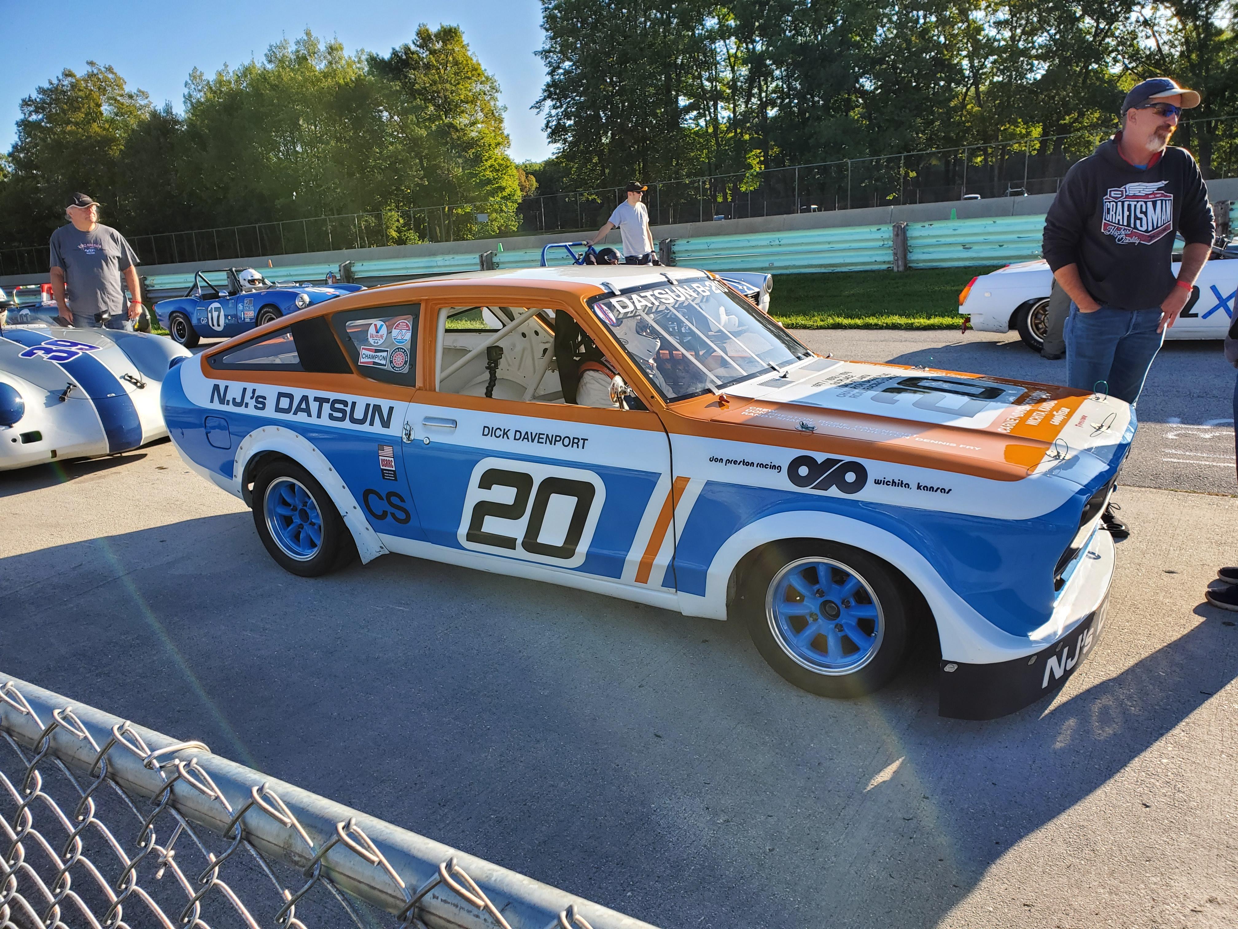

Well inspiration will be abound as I head up to Road America for the weekend to check out the Vintage races. Then back with project updates and some race pictures next week.
Lots of good info from the VSCDA race up at Road America this past weekend. Now time to to get back to the Z this week. This is just a few there were A LOT of Z cars out there this past weekend.
