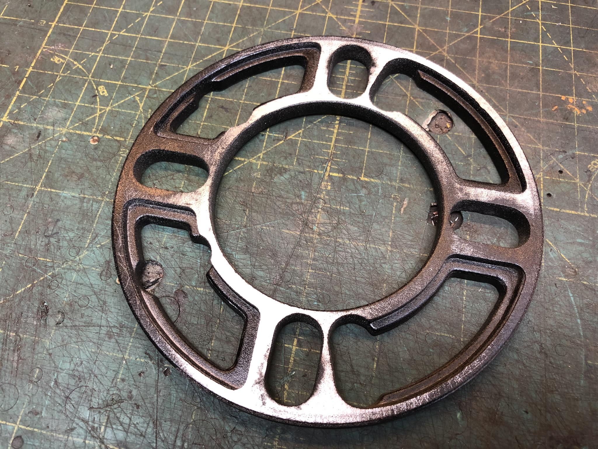

These cast aluminum or unknown pot metal something's are absolutely pieces of you-know-what. I have been battling wheel shimmy for months, and never dreamed it would be these things.
They are only 0.015 inch variance in thickness, but that amount, magnified out to the wheel/tire diameter made the wheels run out by 0.050 inches, which is nearly 1/16".

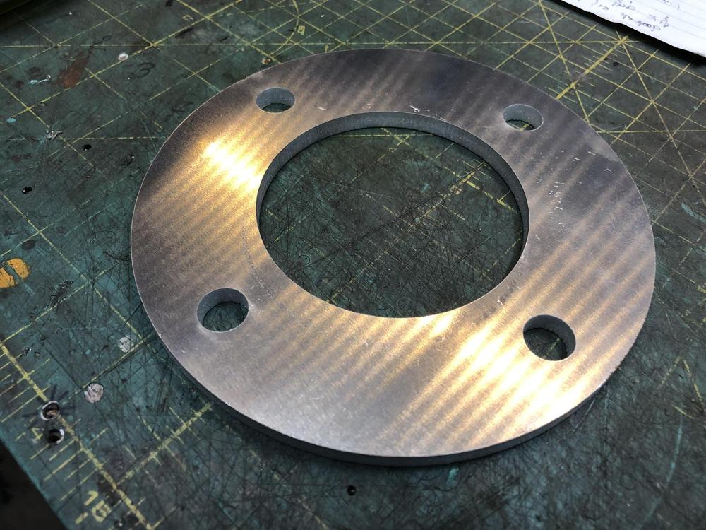

Replaced them with these. Had a local metal shop laser cut these in 15 min. 5.75 diameter, 3" center hole, 1/2 diameter bolt holes at 4.5 bolt spacing.  1/4" 6061
TOTALLY REMOVED ANY AND ALL STEERING WHEEL VIBRATION I HAD, and it was not insignificant. Almost made it unpleasant to drive. Reminded me of this

Another way to see just how anti-flat these are. I sprayed them lightly with black and gave them a quick surface sanding on my reference flat abrasive platten (3/4" MDF with glued on sand paper).
