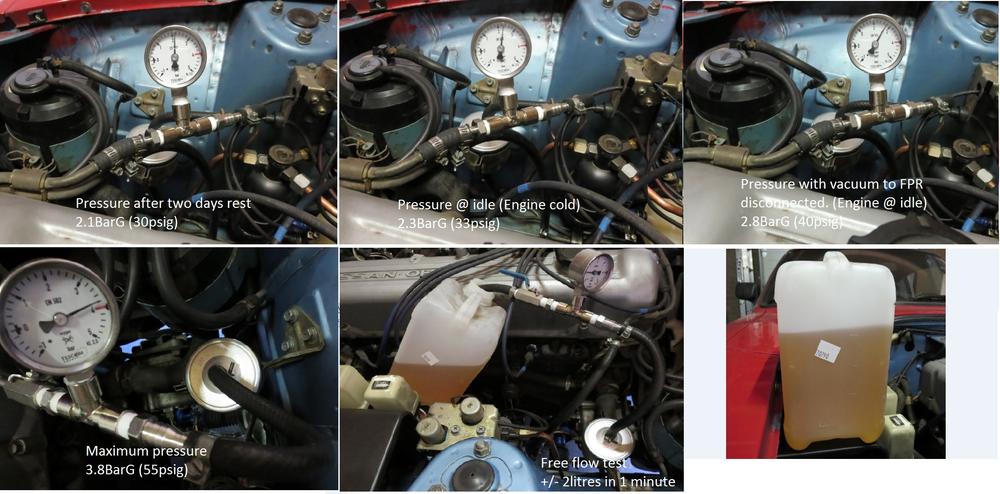

You can make your own gauge for $20 and put it after the fuel filter similar to @EuroDat's.

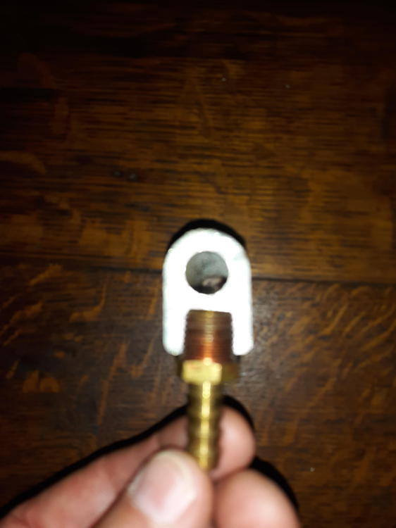

Been doing my research on this great website, even though I am an admitted and verifiable computer dummy, was not able to connect to some of the suggested links, the aluminum fuel rail seems to be an improved choice over the complex spaghetti bend tubing of the original.  Drilling and tapping are in my limited machining capabilities and seems like a doable project costing a lot less than the premade aluminum rails. Sounds like a fun challenge.  Just a couple of questions?  How is the new rail attached to the intake?  Are the barbed fittings tapped with NPT sizes or O-ring thread?  Do the threaded end of the fittings need to be flush with the interior base of the rail?  I could not seem to get the link with the measurements required but thought using the original rail as the template could also be a correct procedure.  Thanks for any additional experienced help and advice.  The aluminum fuel rail sure looks nicer, neater, cleaner than the spaghetti bend original fuel rail and sounds like it may also improve driveability and performance.  Thanks again, John, Lugoff, SC.

The injectors hold mine up nice and firm.  You'll need to get a '78 FPR and I used high heat threadlocker I believe from Permatex.  Tried teflon tape but it leaked.  That stuff dissolves in gas.  Just saw your post above, Slow Hand typer.  You buy it by the foot but it's actually shorter.  I'll measure mine and get the total length asap.  I have some photos on my laptop you need to see.  Run a "T" out the back, one to the FPR and the other side to the CSV.
And the threads on the barbs won't reach into the main line of the rail.
