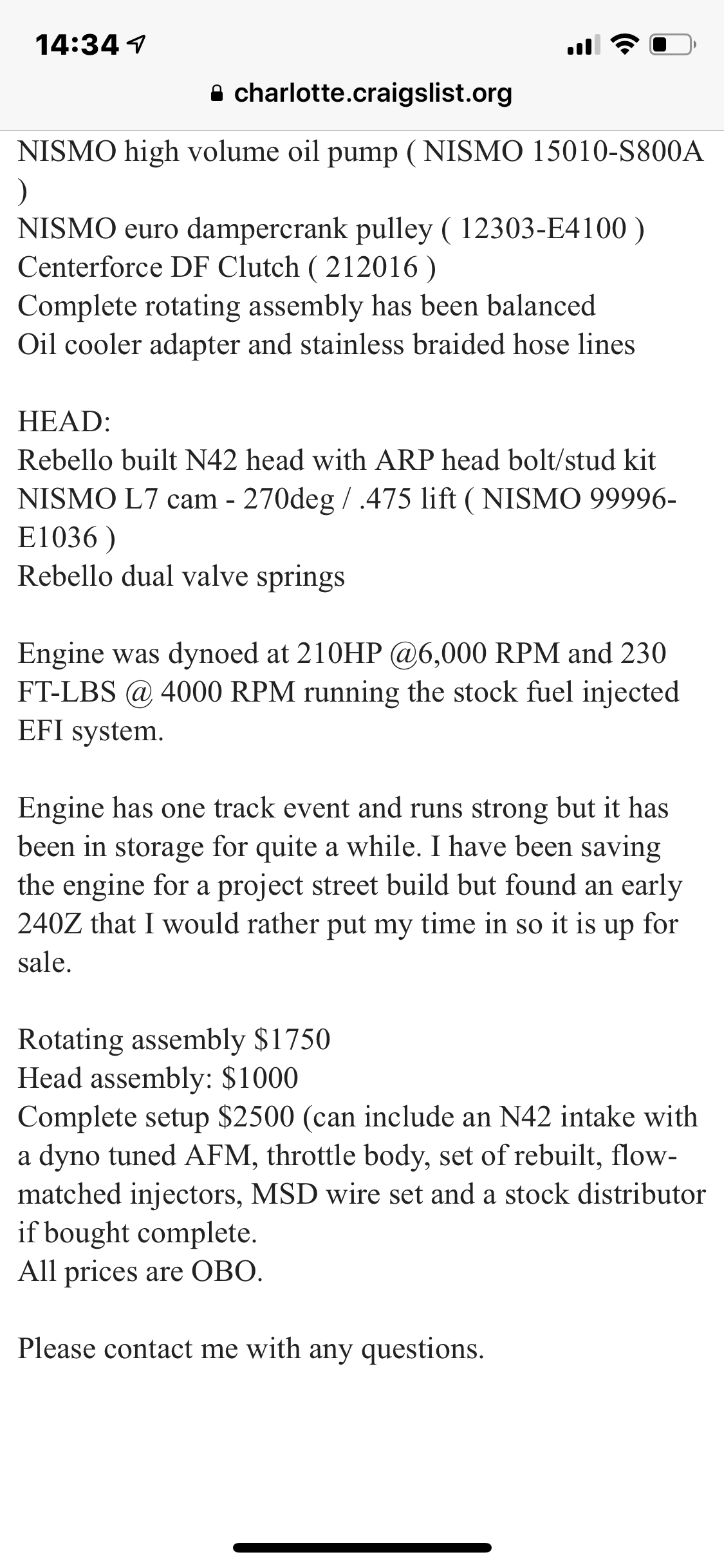

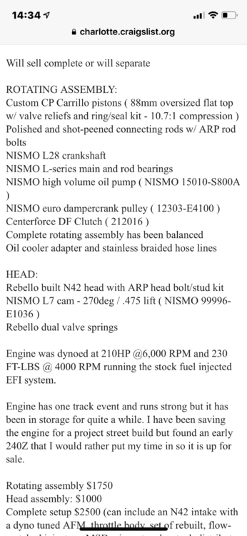

Fast forward, was on CL today and ran across this engine for $2500.  Says is a performance L-28 with all the specs.  When I look at $1500 total to buy and build a stock engine is it a better deal to just buy one like on the listing.  No engine labor and it might be a good buy.  I’m not sure because I don’t know what all this crap mean he’s listing in the add it what it means.  I’m not building a race car.

The head alone would cost you $2,500 or more to duplicate. It was probably a really good deal .That's why it's already gone...
10.7:1 compression with a .475 cam using stock efi.
Seems awful close to a ill running car.  Buuuut slap a pair of SUs on there...
