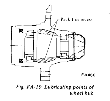

this maybe the same question but does the front edge of the seal sit up against the inner bearing or is there a slight gap between the bearing back and the front lip of the seal? Inner hub has a lip above the bearing race and seal stops at this point. With the seal at this point the inner bearing can still wobble. Is this correct?
The seal has a seat in the rotor.  The inner bearing will be pressed against the outer bearing race after installation so there will be no wobble.  It will be wobbly while it's off the spindle but not once it's installed.
Here are some pictures from the FSM.  There's a gap.
