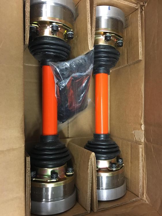

June 7, 20196 yr Author comment_577065 Well here they are.......... Doesn’t look too difficult. I’ll take some pics of the installation.....maybe the Stroker motor won’t hurt these babies! Link to comment https://www.classiczcars.com/forums/topic/62266-futofab-cv-axles/#findComment-577065 Share on other sites More sharing options...
June 7, 20196 yr comment_577078 I might be wrong - but get ready for some clunking in the rear. There seems to be excessive radial movement in the joint - slop. Supposedly these axles were engineered more specifically for 4wd vehicles. I’m not going to pretend I’m an engineer , but there are some unhappy folks with these. Now I’ve put them thru some serious stress testing , but my HP isn’t to your level. Just today I was under the car cleaning and inspecting and couldn’t find see anything wrong . Initially when I bought these the instructions were okay, but had the wrong torque value on the Allen bolts and I stripped one. After a phone call I got it straightened out. Safety wiring is a bitch . Link to comment https://www.classiczcars.com/forums/topic/62266-futofab-cv-axles/#findComment-577078 Share on other sites More sharing options...
June 7, 20196 yr Author comment_577087 Thanks Madkaw.....I feel much better LOL. I’ll keep everyone posted with how they perform. I have a friend that installed these in a 510. He loved em. Link to comment https://www.classiczcars.com/forums/topic/62266-futofab-cv-axles/#findComment-577087 Share on other sites More sharing options...

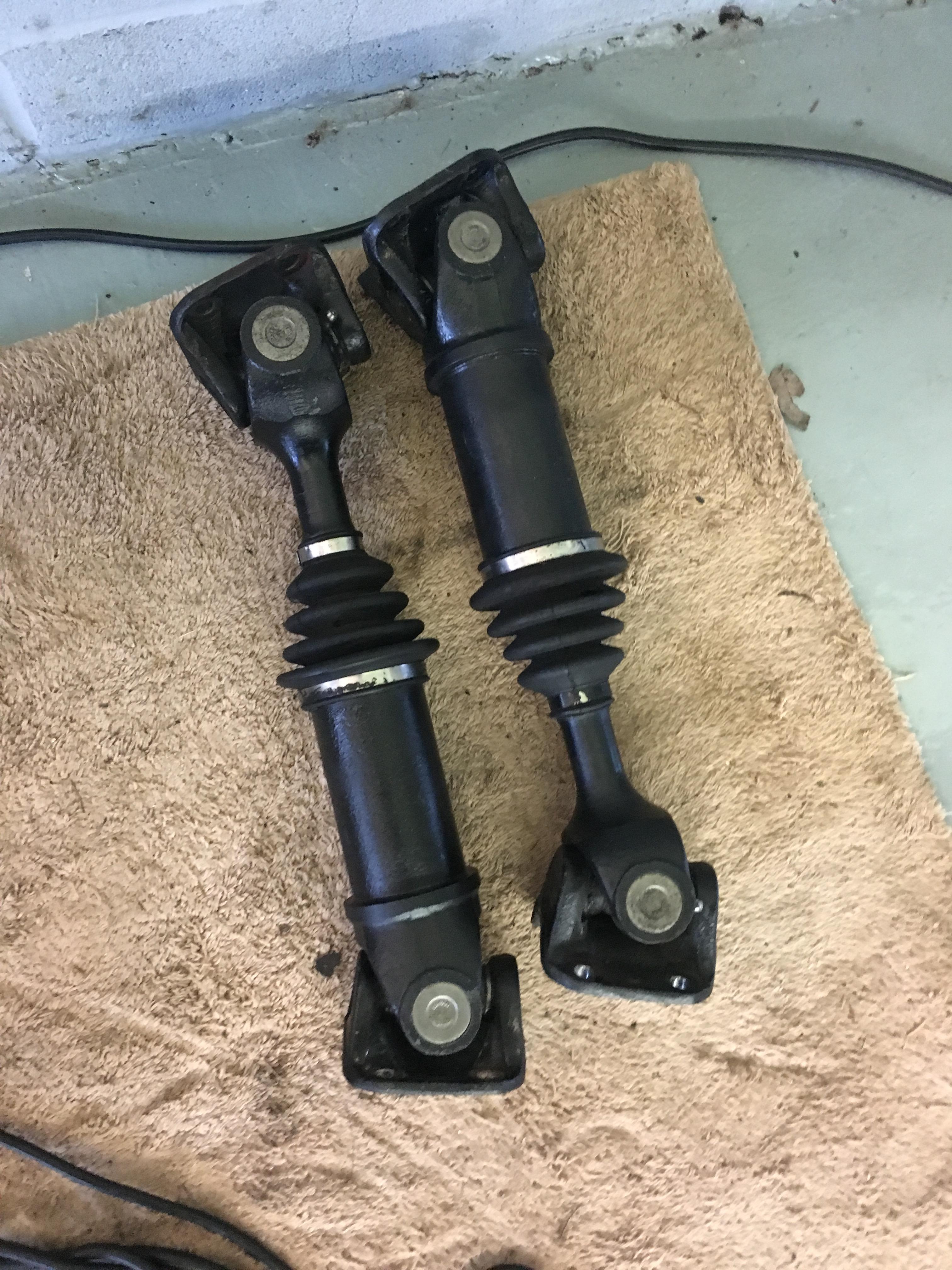

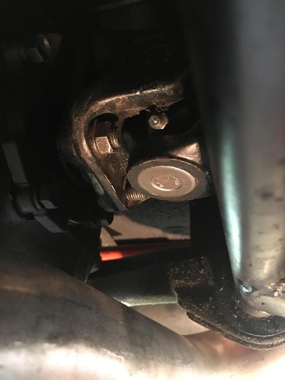

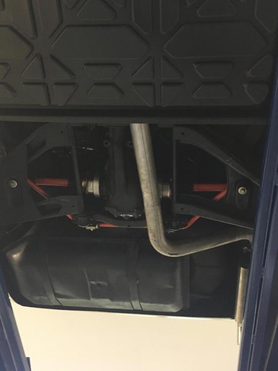

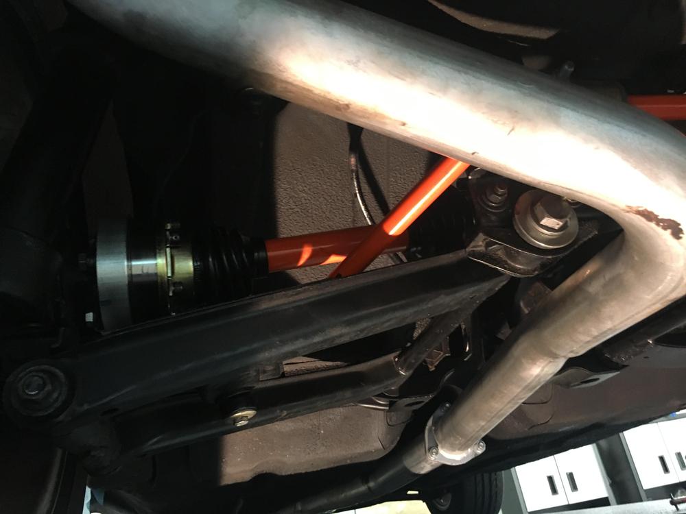

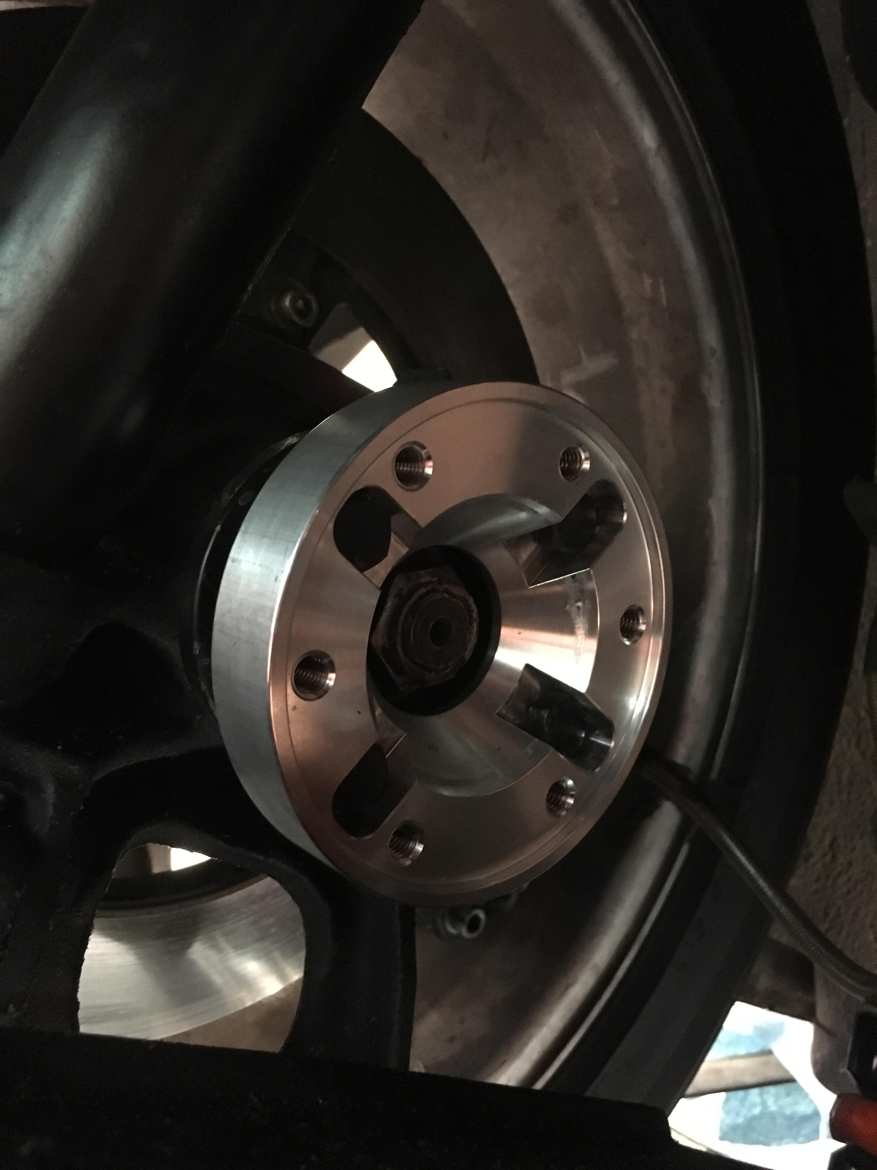

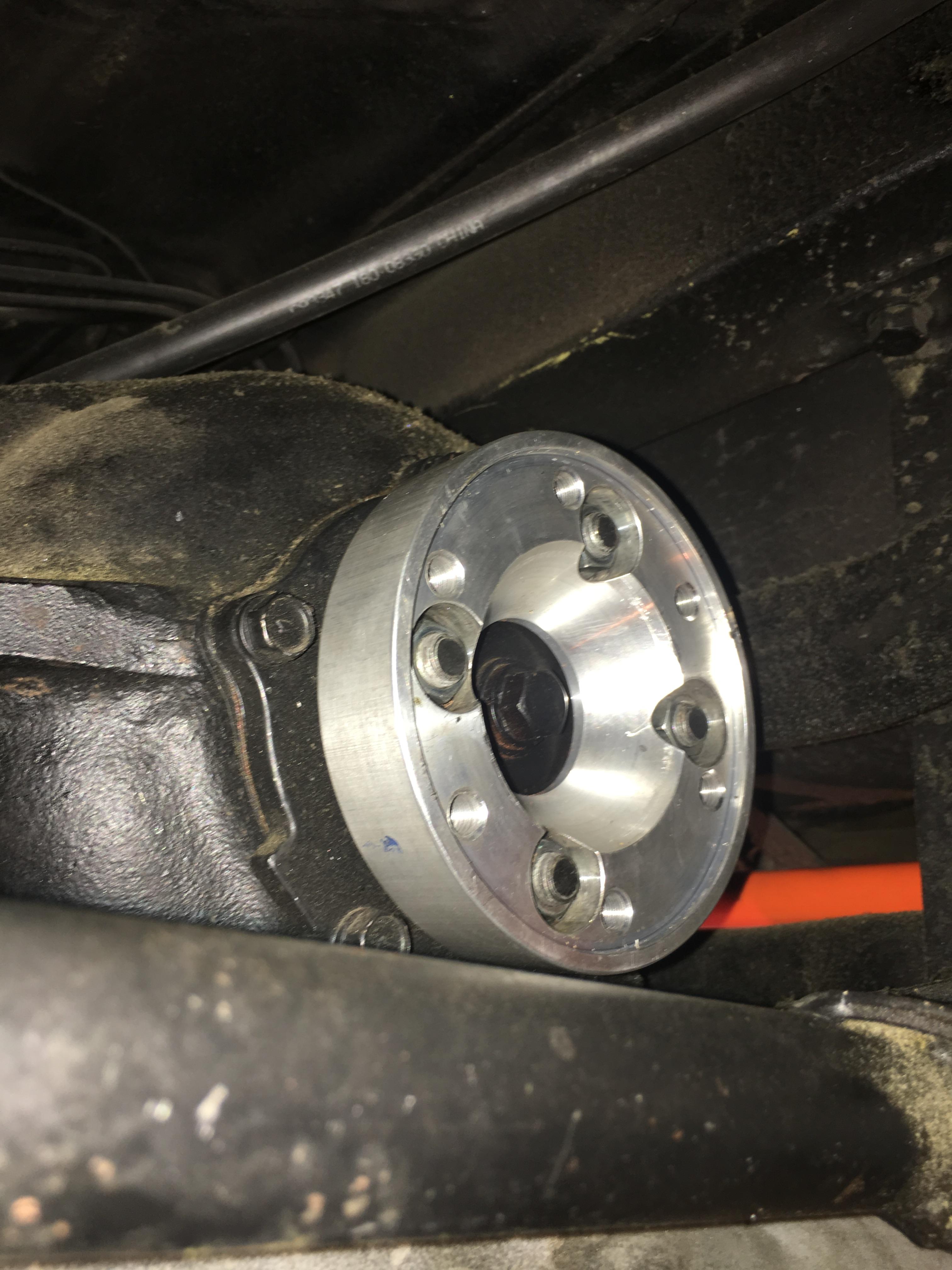

June 8, 20196 yr Author comment_577189 Out with the old.....in with the new. Link to comment https://www.classiczcars.com/forums/topic/62266-futofab-cv-axles/#findComment-577189 Share on other sites More sharing options...

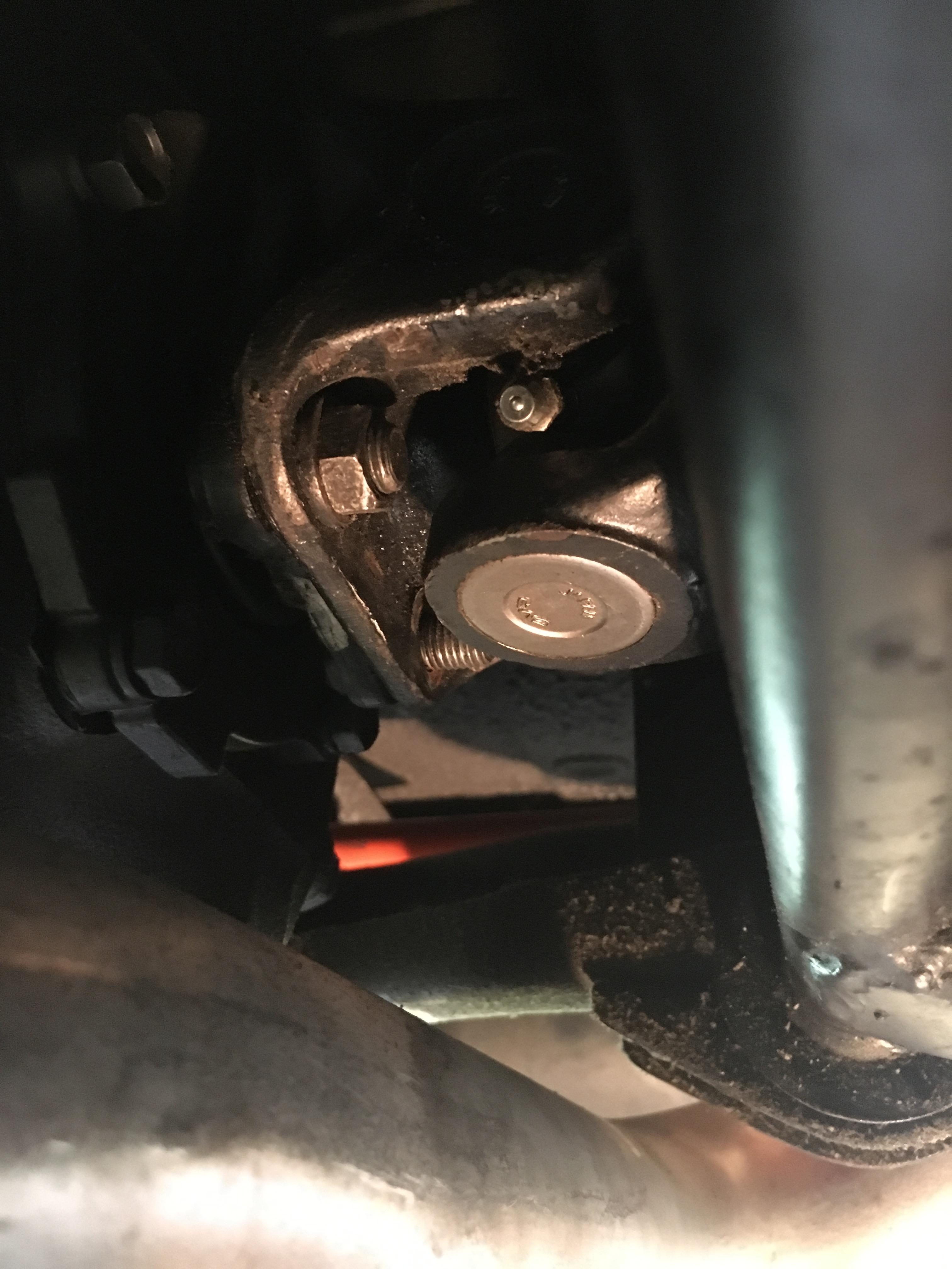

June 8, 20196 yr comment_577195 Guy, your original halfshafts appear to be in really good condition. Were they exhibiting any symptoms? Link to comment https://www.classiczcars.com/forums/topic/62266-futofab-cv-axles/#findComment-577195 Share on other sites More sharing options...
June 8, 20196 yr Author comment_577197 Yes Charles, there was excessive play in the driver side half shaft outside u joint. Edited June 8, 20196 yr by Diseazd Link to comment https://www.classiczcars.com/forums/topic/62266-futofab-cv-axles/#findComment-577197 Share on other sites More sharing options...

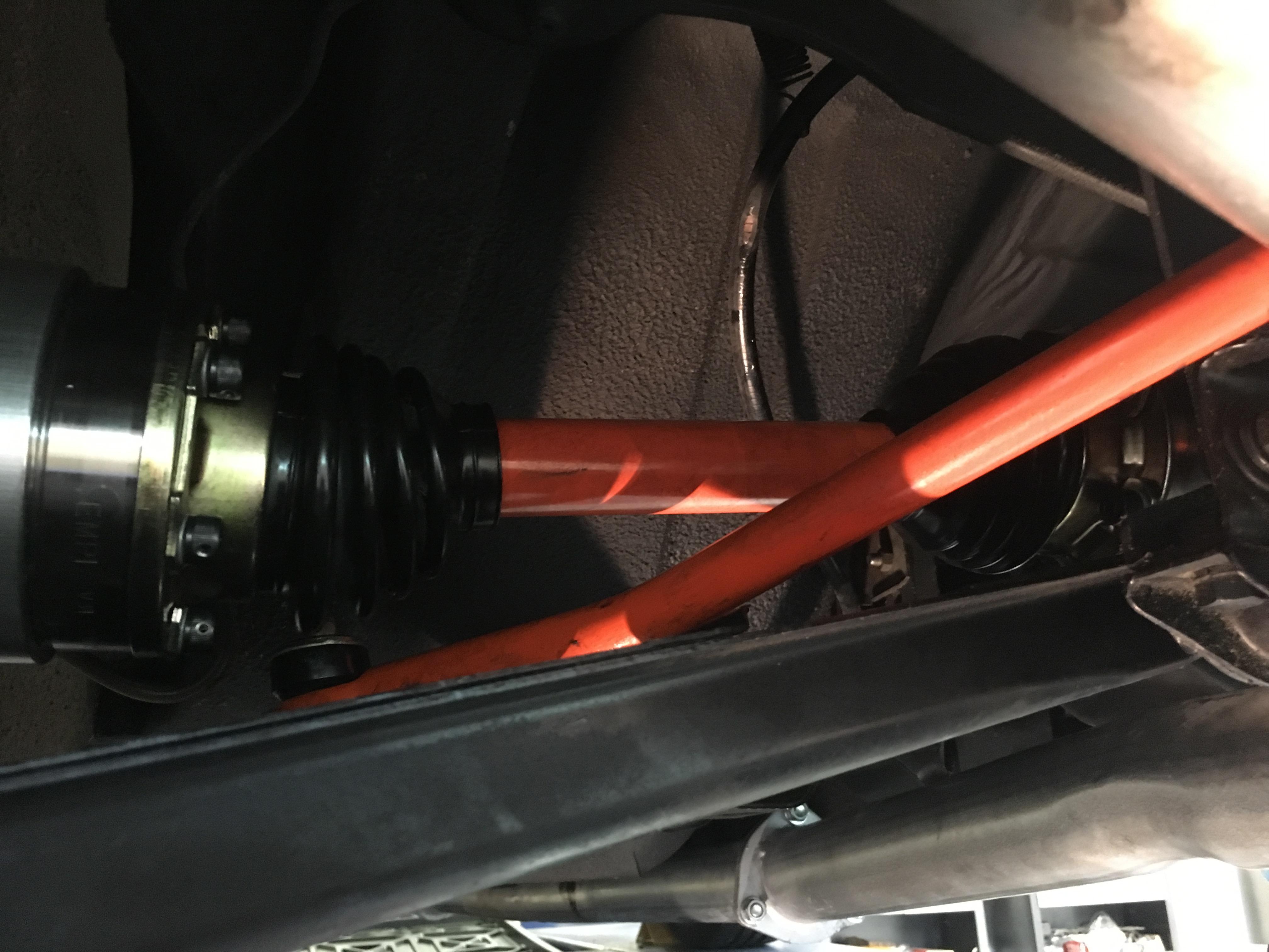

June 8, 20196 yr Author comment_577213 All finished. Took it for a test drive and it works perfect. No noise, no slack.....solid. Even when I let off and nail it, no play......I’m happy with Futofab CV shafts! Edited June 8, 20196 yr by Diseazd Link to comment https://www.classiczcars.com/forums/topic/62266-futofab-cv-axles/#findComment-577213 Share on other sites More sharing options...
