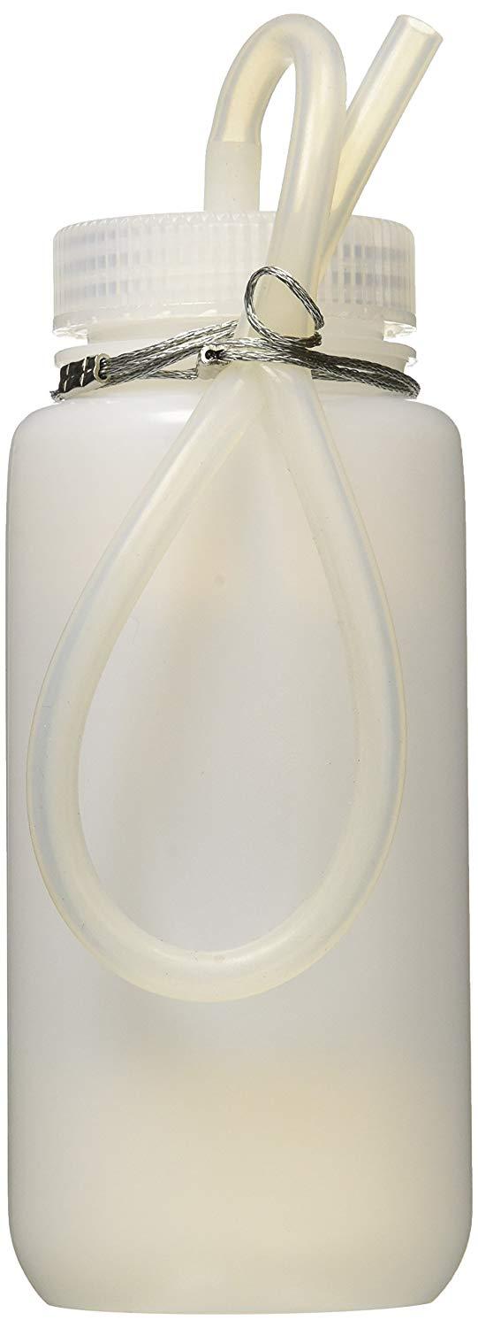

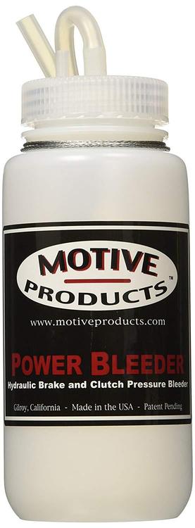

I finally got my speed bleeders and installed both fronts and rears.  After bleeding the brakes, I couldn't imagine doing this again without the speed bleeder.  This little upgrade makes it SO MUCH EASIER to bleed your brakes on your own.  I also suggest buying a small plastic container that you can install on each brake when you're bleeding it.  From there you simply need to loosen the speed bleeder and start pumping your brakes.  Keeping an eye on the fluid in the master cylinder, keep pumping until the old fluid (and bubbles) are worked out of the system.  Simple and no mess.
Here's a pic of the Motive Products 1810 Bottle I purchased to capture the old fluid during the bleeding process.  https://www.amazon.com/Motive-Products-1810-Bottle/dp/B008C8O026/ref=sr_1_7?keywords=brake+bleeding+motive&qid=1559495213&s=gateway&sr=8-7

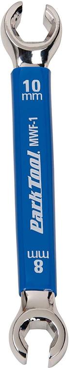

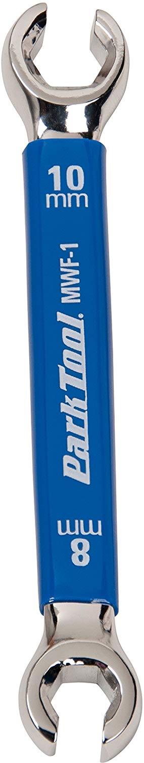

Oh, I also wanted to mention the front speed bleeders did not come with a metric size for the outer nut.  I had to switch to a 7/16 wrench for adjustments.  The rears took the traditional 10mm wrench.
I think I was able to use an 11mm box end on the fronts. I could have sworn the backs were 8mm
