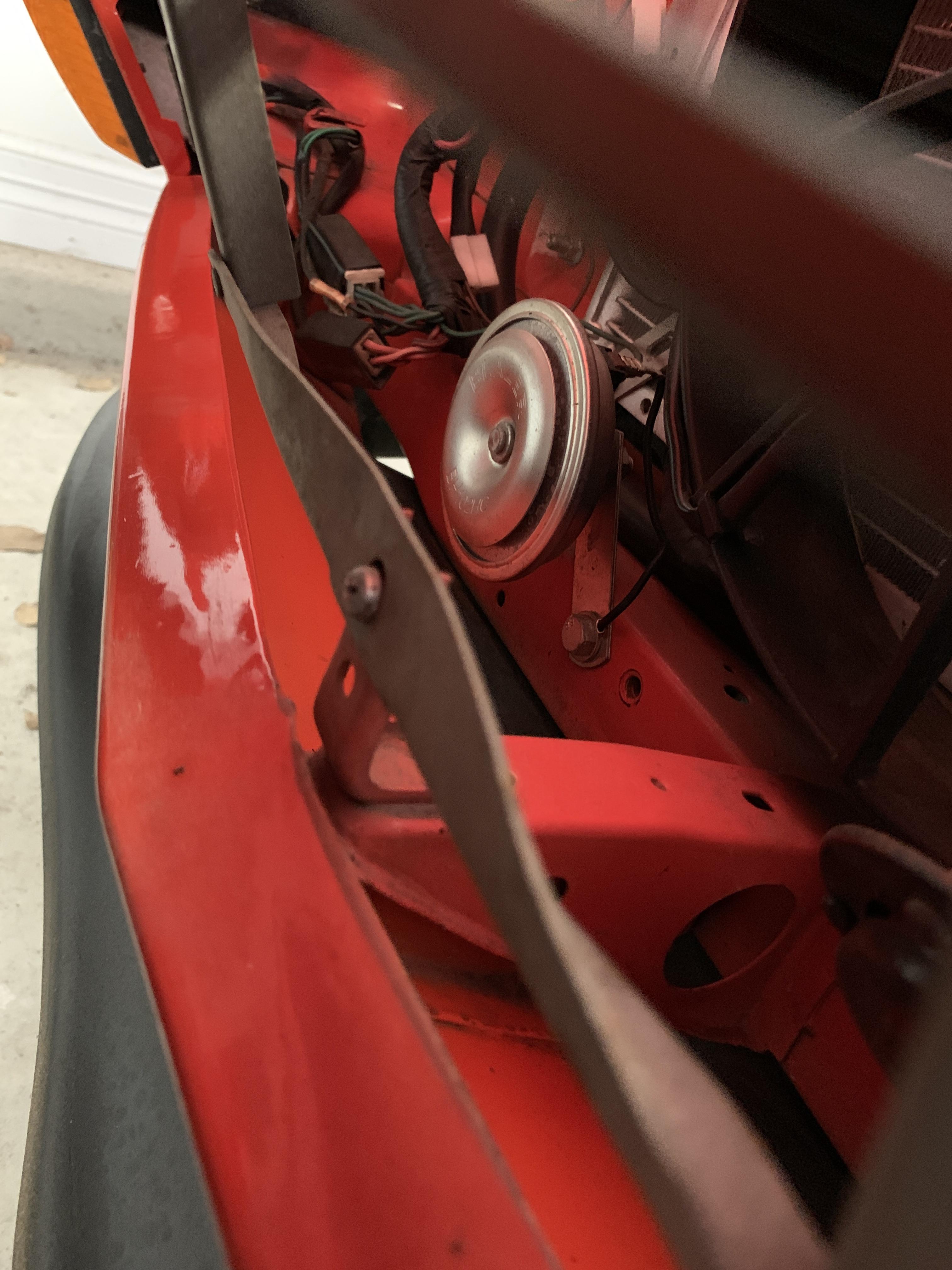

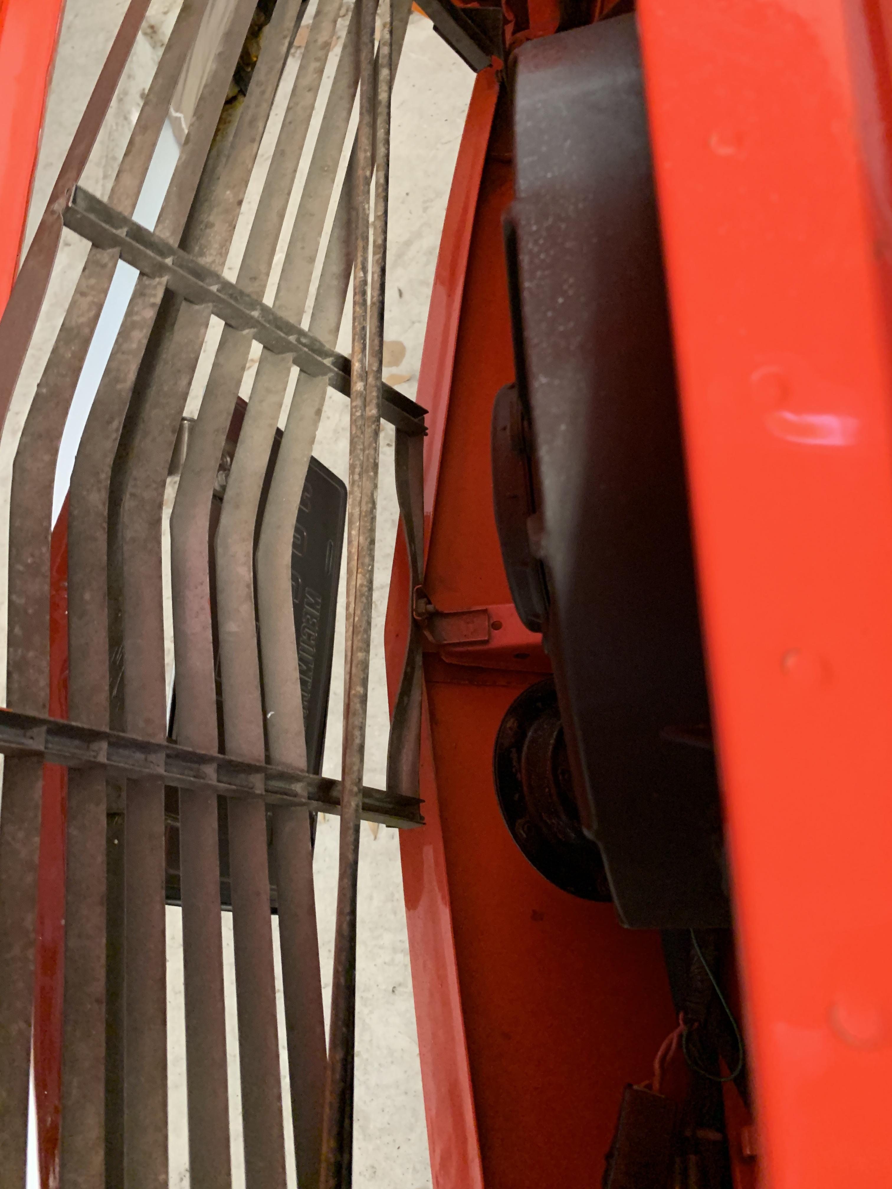

April 26, 20196 yr Author comment_574291 Here are a few shots: Link to comment https://www.classiczcars.com/forums/topic/62036-my-mecum-purchase-1972-240z/?&page=5#findComment-574291 Share on other sites More sharing options...

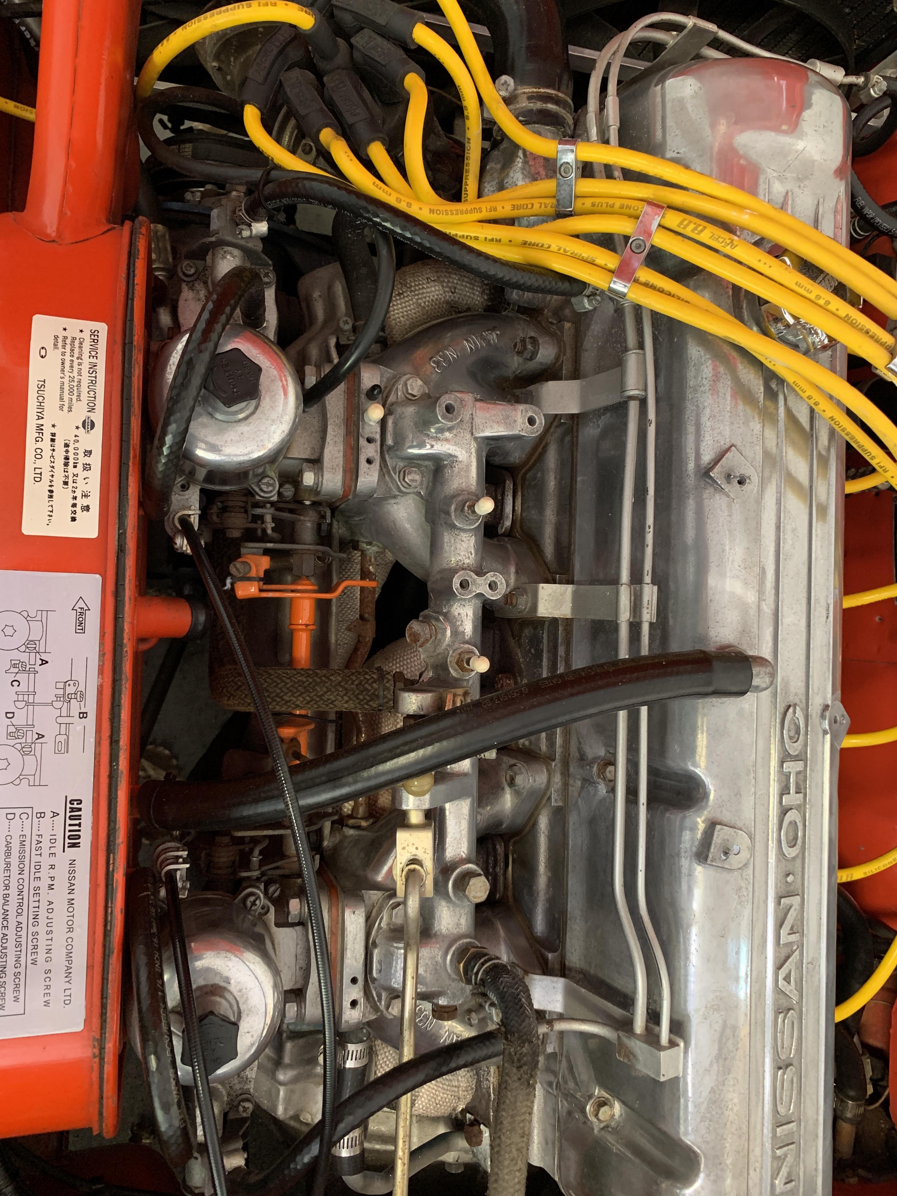

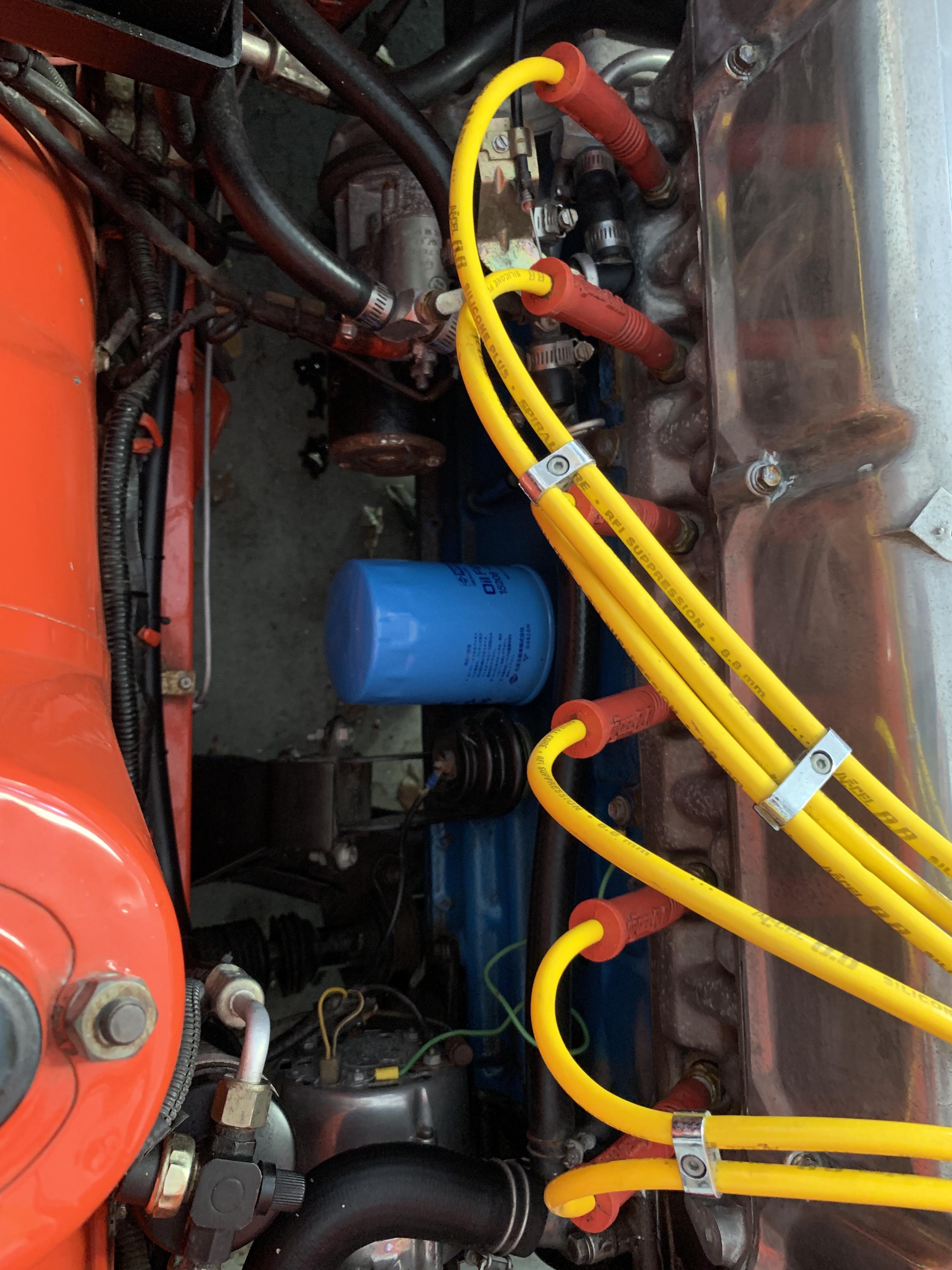

April 26, 20196 yr Author comment_574292 And few gratuitous engine compartment shots:   Link to comment https://www.classiczcars.com/forums/topic/62036-my-mecum-purchase-1972-240z/?&page=5#findComment-574292 Share on other sites More sharing options...
April 27, 20196 yr comment_574297 The bracket looks right but the grill bars should be horizontal Link to comment https://www.classiczcars.com/forums/topic/62036-my-mecum-purchase-1972-240z/?&page=5#findComment-574297 Share on other sites More sharing options...
April 27, 20196 yr Author comment_574298 I’ll play with it. The grill is definitely facing the right way. I think it just needs to be leveled slightly. Link to comment https://www.classiczcars.com/forums/topic/62036-my-mecum-purchase-1972-240z/?&page=5#findComment-574298 Share on other sites More sharing options...

April 27, 20196 yr comment_574302 Nice purchase at a very nice price! Don't know if it will take all of that upward bow out---- try using the lower mounting hole shown in your second grill photo (the one with the horn visible in the photo). Something I noticed, not related to this issue, but look closely at the third photo in the original listing. (The one taken from the passenger side rear quarter looking toward the front of the car) It appears in the photo that the door is misaligned at the lower trailing edge of the door with regards to the top of the rocker. The bottom edge gap of the door should be consistent from front to rear and the rear edge gap should be consistent from bottom to top. It may be perfect, but the photo makes it appear not so. I don't know, just saying. Maybe check it out to be sure? Might need a little tweaking. Link to comment https://www.classiczcars.com/forums/topic/62036-my-mecum-purchase-1972-240z/?&page=5#findComment-574302 Share on other sites More sharing options...

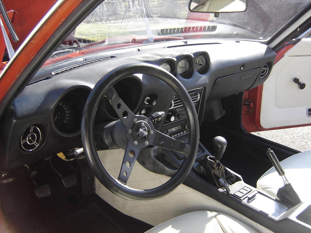

April 27, 20196 yr comment_574313 Here's the best I could find of the cracked dash repair with low sheen elastomeric sealant. I was thinking it was for sealing commercial glass but after googling it i saw where it's for masonry also. The cracks were above the 3 gauges in the middle. Link to comment https://www.classiczcars.com/forums/topic/62036-my-mecum-purchase-1972-240z/?&page=5#findComment-574313 Share on other sites More sharing options...
April 27, 20196 yr Author comment_574316 It looks pretty good. Would you mind taking a photo or sending a link to the product so I don't buy the wrong one? Link to comment https://www.classiczcars.com/forums/topic/62036-my-mecum-purchase-1972-240z/?&page=5#findComment-574316 Share on other sites More sharing options...
April 27, 20196 yr comment_574327 I'm very sorry to say that was done by the guy I bought the car from and he told me about using that stuff. I'm thinking he called it poly butyl for windows but I'm not 100%. Been awhile back, sorry. Maybe someone will chime in that might know. Cliff Link to comment https://www.classiczcars.com/forums/topic/62036-my-mecum-purchase-1972-240z/?&page=5#findComment-574327 Share on other sites More sharing options...
