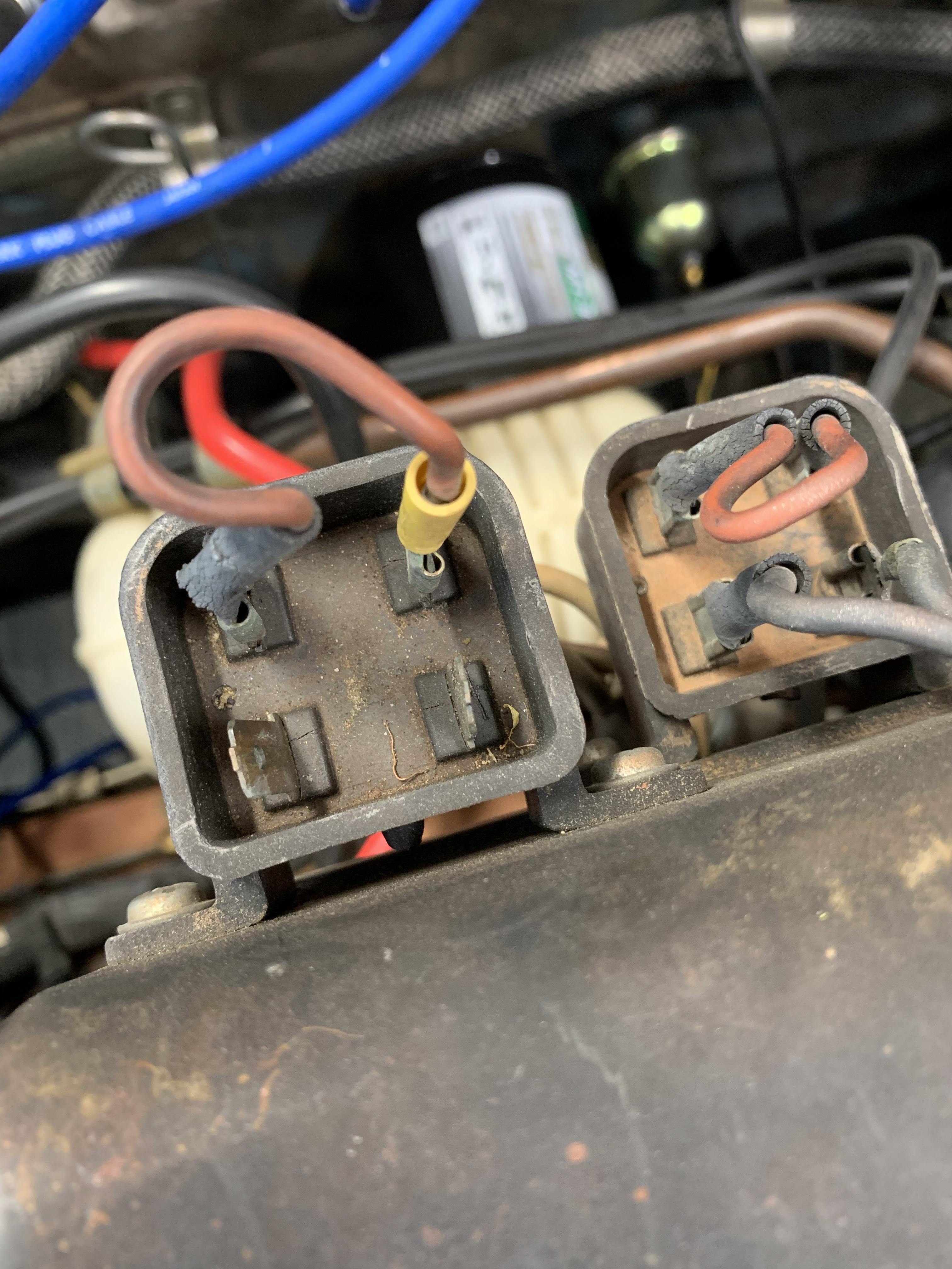

June 25, 20195 yr Author comment_578327 I took the Z out for a two hour cruise and it performed beautifully!  I did note a few issues with the Z: 1. Gas tank leak: there’s a few drops coming from the passenger side of the gas tank. I’m planning on getting it redone because there’s also a bit of rust in the tank as well. 2. Turn signal/headlights not working: I have to look into this issue more. Yesterday I plugged in a fusible link and within seconds, it burned out. Do auto parts stores sell fusible links? 3. Fuel Gauge isn’t working. 4. Suspension is bouncy: I bought kyb shocks and am waiting on Eibach springs. Link to comment https://www.classiczcars.com/forums/topic/61849-picking-up-a-1977-280z-6-hours-away-tips/?&page=13#findComment-578327 Share on other sites More sharing options...
June 25, 20195 yr comment_578336 those fuse links do not look factory. I am not sure but if they supply the head light circuit, then you may have a problem in the head light switch itself, but of course could be a short anywhere in the circuit. You are going to have to review the FSM and look at the section that covers that. Link to comment https://www.classiczcars.com/forums/topic/61849-picking-up-a-1977-280z-6-hours-away-tips/?&page=13#findComment-578336 Share on other sites More sharing options...
June 25, 20195 yr comment_578337 Yep the headlight have a fuse wire, I have the 76 fsm on BE-11 is shows the circuit. I would start by seeing if there is a dead short at the fuse link terminal that leads to the combo switch. Try operating the combo switch (lights on and off repeatedly) and see what effect you have. If no effect disconnect the lead at the combo swich (fsm shows a single red) and see if that clears the short. You are just going to have to work thru it with a multimeter to find the issue. that is IF the circuit is blowing the correct OE fuse link. Link to comment https://www.classiczcars.com/forums/topic/61849-picking-up-a-1977-280z-6-hours-away-tips/?&page=13#findComment-578337 Share on other sites More sharing options...
June 25, 20195 yr comment_578338 you did not say if the fuse link blows instantly regardless of if the head light switch is on or off. that would help. Link to comment https://www.classiczcars.com/forums/topic/61849-picking-up-a-1977-280z-6-hours-away-tips/?&page=13#findComment-578338 Share on other sites More sharing options...
June 25, 20195 yr comment_578344 Several vendors sell the fusible links. MSA does. Below is a link to ZCarDepot. ZCarDepot fusible links They also sell the two plastic covers missing from your photo. Link to comment https://www.classiczcars.com/forums/topic/61849-picking-up-a-1977-280z-6-hours-away-tips/?&page=13#findComment-578344 Share on other sites More sharing options...
June 25, 20195 yr comment_578346 Also be sure they are in the correct locations Link to comment https://www.classiczcars.com/forums/topic/61849-picking-up-a-1977-280z-6-hours-away-tips/?&page=13#findComment-578346 Share on other sites More sharing options...
June 26, 20195 yr Author comment_578412 On 6/25/2019 at 5:29 AM, Dave WM said: you did not say if the fuse link blows instantly regardless of if the head light switch is on or off. that would help. The fuse blew immediately. The combo switch and the turn signals won't work at all and the wipers turn on by themselves. Â Link to comment https://www.classiczcars.com/forums/topic/61849-picking-up-a-1977-280z-6-hours-away-tips/?&page=13#findComment-578412 Share on other sites More sharing options...
June 27, 20195 yr comment_578422 4 hours ago, BayAreaZ650 said: The fuse blew immediately. The combo switch and the turn signals won't work at all and the wipers turn on by themselves.  ok so now the fun begins, get the wiring diagram from the FSM that details the headlights for starters, you should be able to find the power lead, un plug that and see if you can clear the short on the terminal where the fuse wire plugs in. You are going to want to set things up for continuity testing and start working to see when the short goes away. My guess is the combo switch has been futz with, but you will just have to do some circuit tracing. IIRC its a big fat single red lead plug that is part of the combo switch harness. That one supplies power thru the combo switch back to the fuse box that has dual 10amp fuses for each head light. The headlight get the ground thru the dimmer, a big fat Black lead that is part of the combo switch harness. Edited June 27, 20195 yr by Dave WM Link to comment https://www.classiczcars.com/forums/topic/61849-picking-up-a-1977-280z-6-hours-away-tips/?&page=13#findComment-578422 Share on other sites More sharing options...
