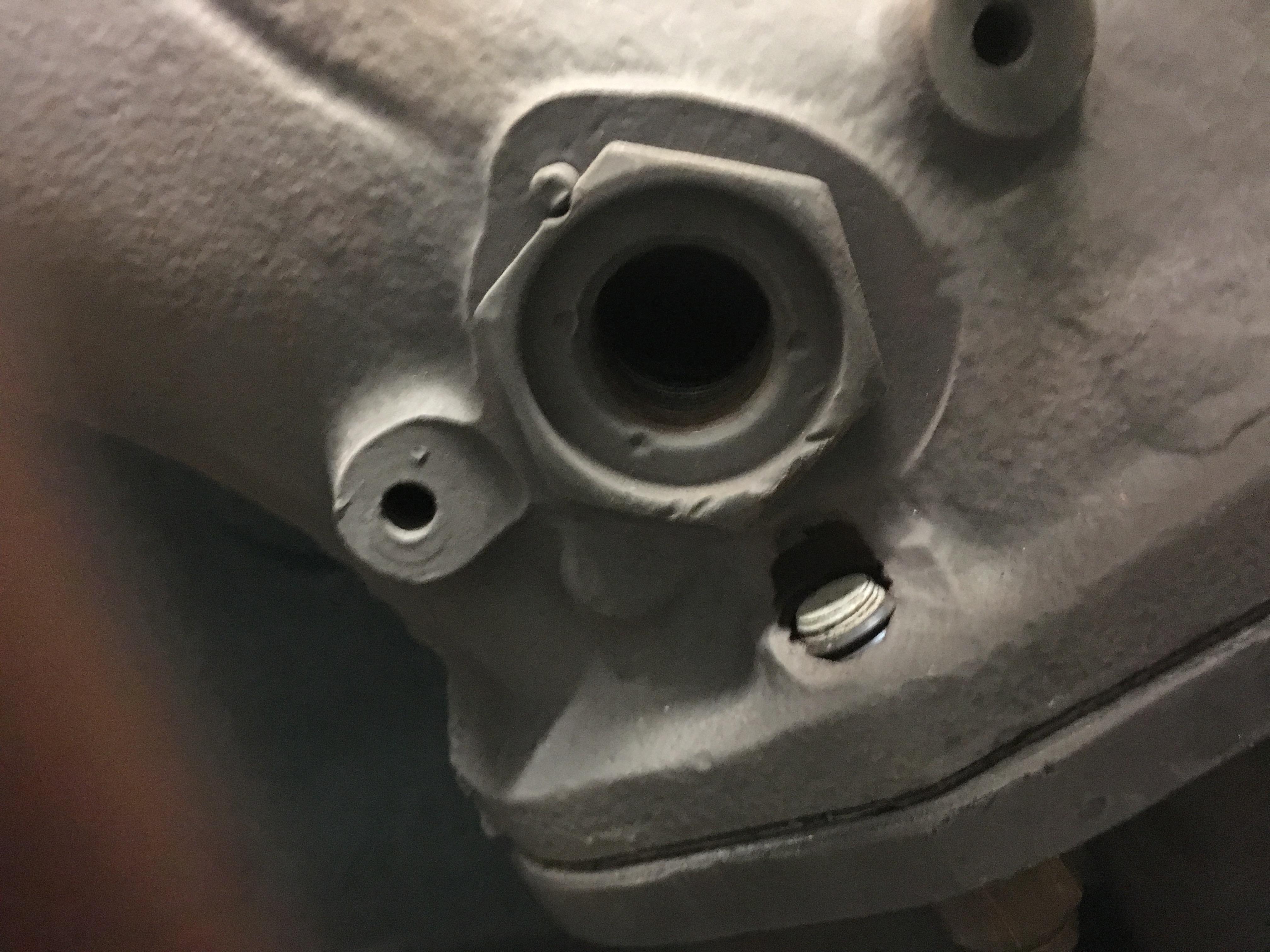

Took the white 70 for some exercise. Developed an exhaust leak (loud). Found the cause....she’s missing a bolt (plug) from her early exhaust manifold. Anyone know the thread size of this item, or better jet do they have one they could spare?

Is that not the narrow band O2 sensor location from a ZX manifold?  Never seen an early manifold with a need for either an EGR fitting or O2 sensor that would explain that hole. Unless it was a later user added "feature"
Anyway if its O2 bung thread, its M18x 1.5.

Right you are Jim. It’s not an early manifold, it’s a manifold from a ZX with no exhaust tubes......W48. I tried 3/8 and 1/2 inch plugs.....one too small and one too large. I just want to plug it. I’ll order an M18x1.5 plug. Thanks so much for your help.....I am always impressed with your knowledge of Z cars.

They will probably have one at your local big box parts store too.
Glad to help.  Speed shops that sell weld in O2 bungs will also have plugs. Some of the bungs I've bought actually came with the plug.
