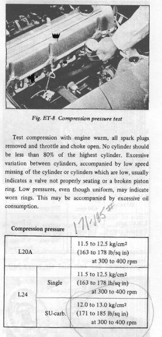

New owner of a 72 240z coupe. Original engine. This weekend measured compression. Wondering what compression should be for a stock motor. Front to rear: 160# 160# 160# 158# 155# 146#  The difference between 160# and 146# is 8.75%

Have you been driving it or has the car been sitting?  The FSM has specs. and procedure.  The gauge can affect the numbers, but the range variation is what's important.
Been driving the car daily for a month. Forgot about the throttle and choke settings during the test. My throttle was closed and the choke was probably fully engaged. Will try it again, thanks!
