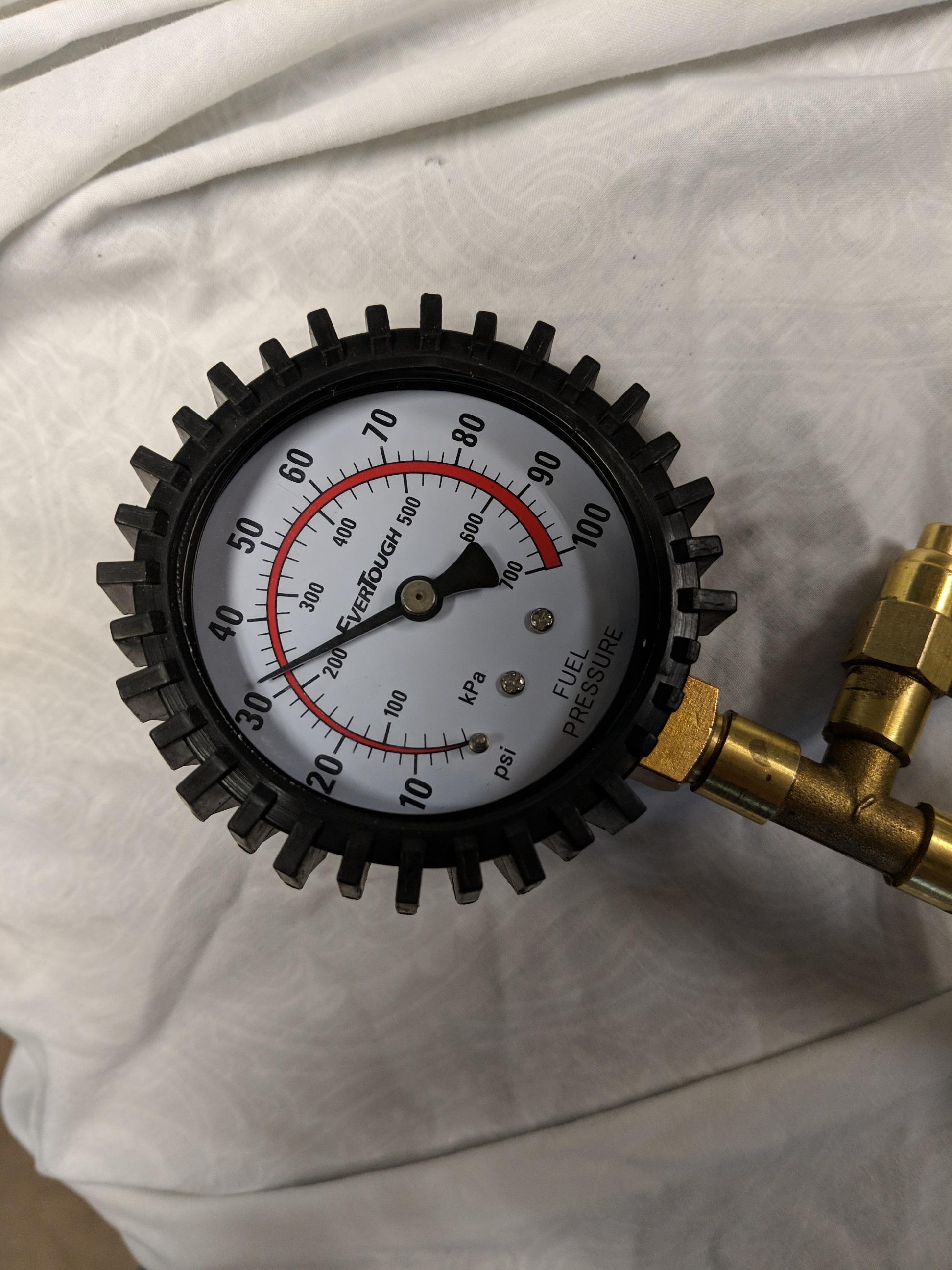

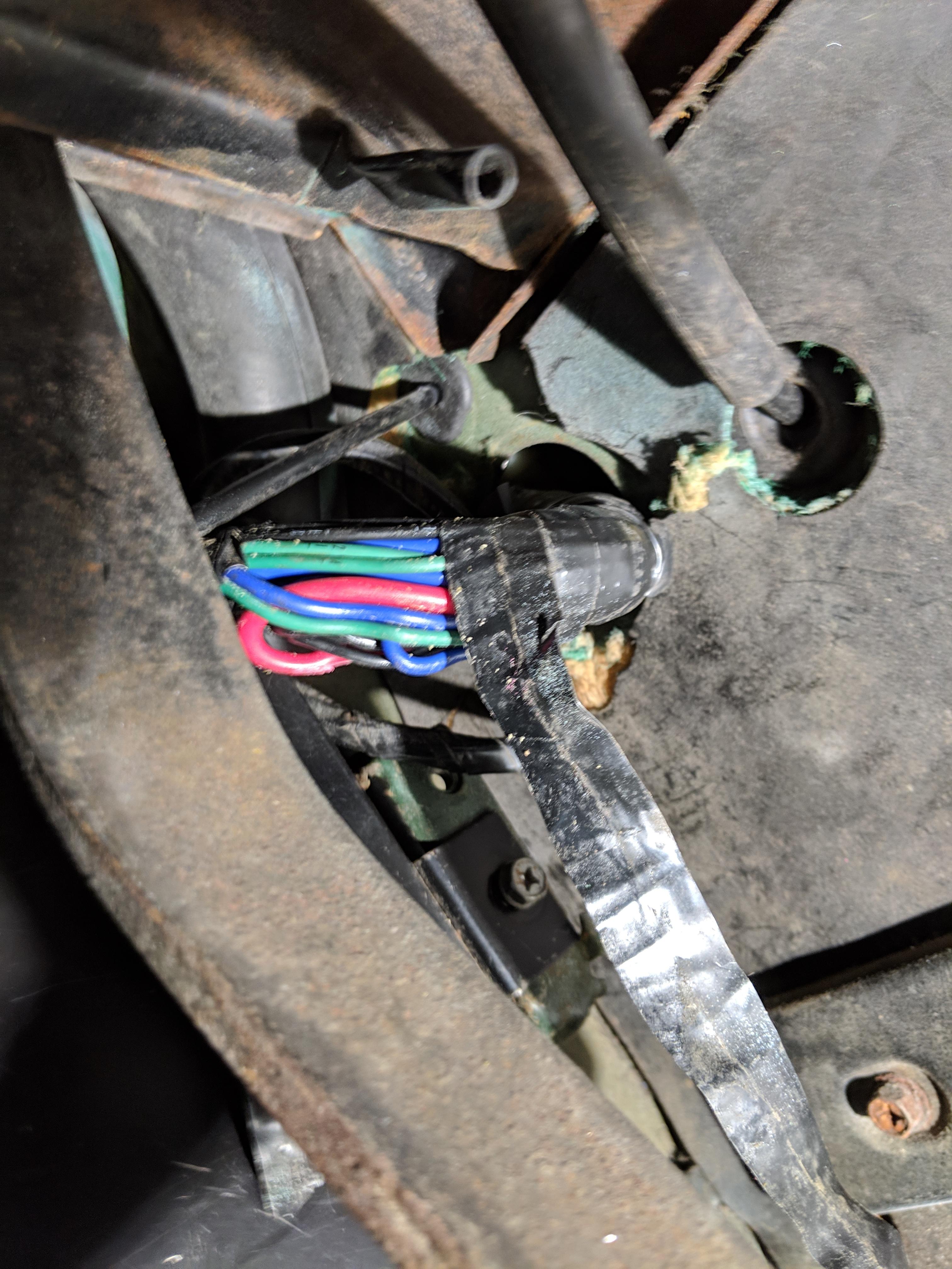

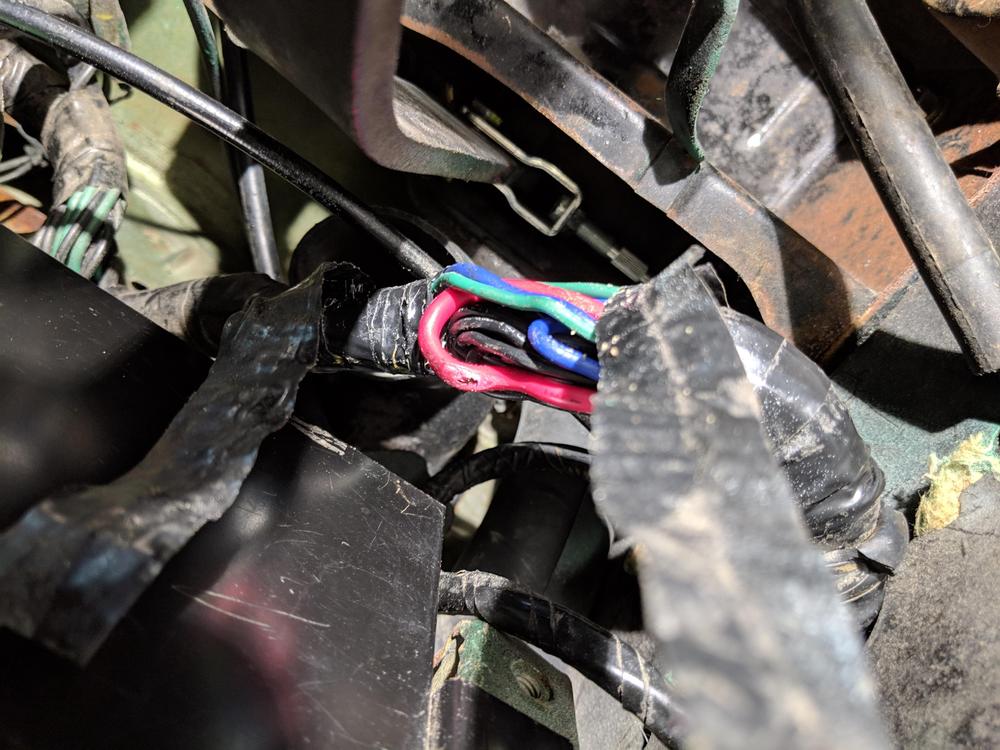

A few months ago I started this thread on this site but had to leave for school and couldn't work on the car. From this point, I have tested a few things and found at least one problem. Previously it was suggested to check the fuel pressure and after the engine dies it is still at 32 psi. Also in the previous post I mentioned the first time the car died like this was on the road after I clutched in, upon looking around the clutch pedal I found this red wire in the ECU loom that was worn away by the pedal. I haven't traced it yet so this could be part of the problem.

I’d do a continuity check with a multi-meter on the wire bundle. If you have one wire that has compromised the insulation there is a good chance you have others that you can’t see. It’s a PITA sometimes to run wire problems because they could have an intermittent connection only manifesting during vibrations or upon heating up. So be patient, try and move the wire bundle while testing and test multiple times and see what you find. Wal280z has a wire diagram he made that’s awesome that your can download that will help you find the end points of each wire you’re chasing.

Looks like you created a short circuit.  Check your fusible links.  Hopefully they did what they're supposed to do.  The wire is still red instead of charred so the odds are good.
Well I cranked it today and it ran for 45 minutes including driving it around my neighborhood. I'm really confused now
