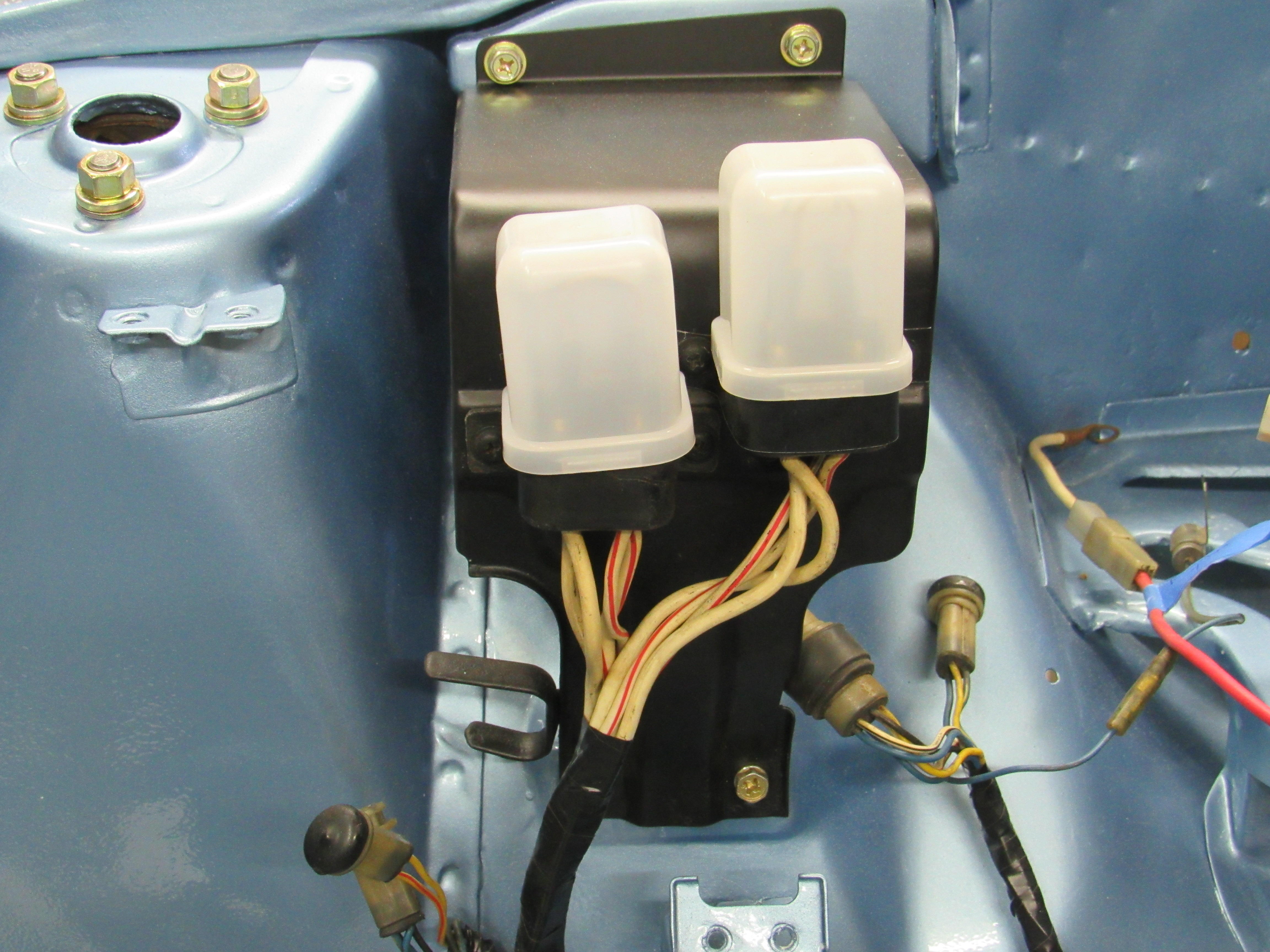

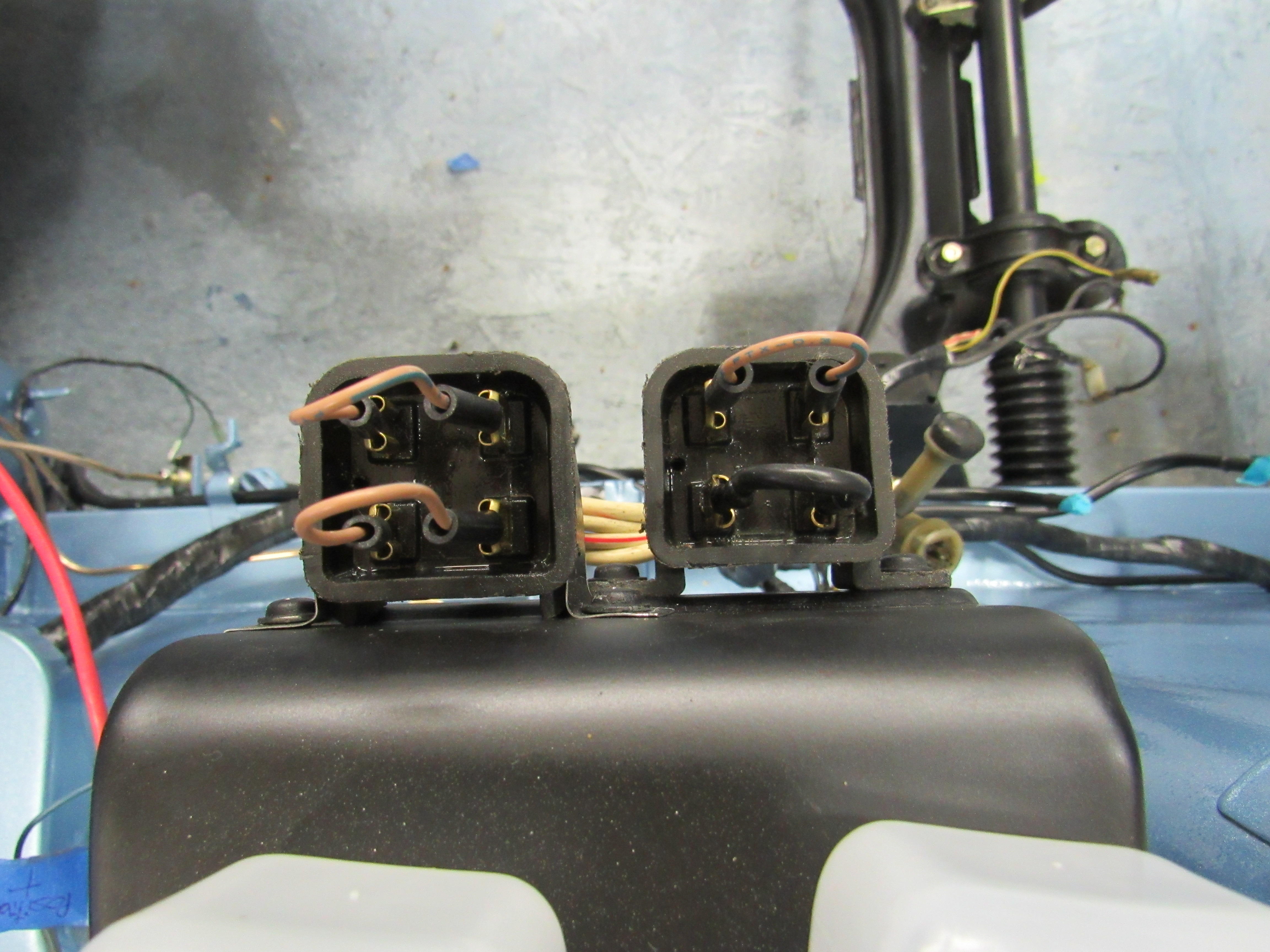

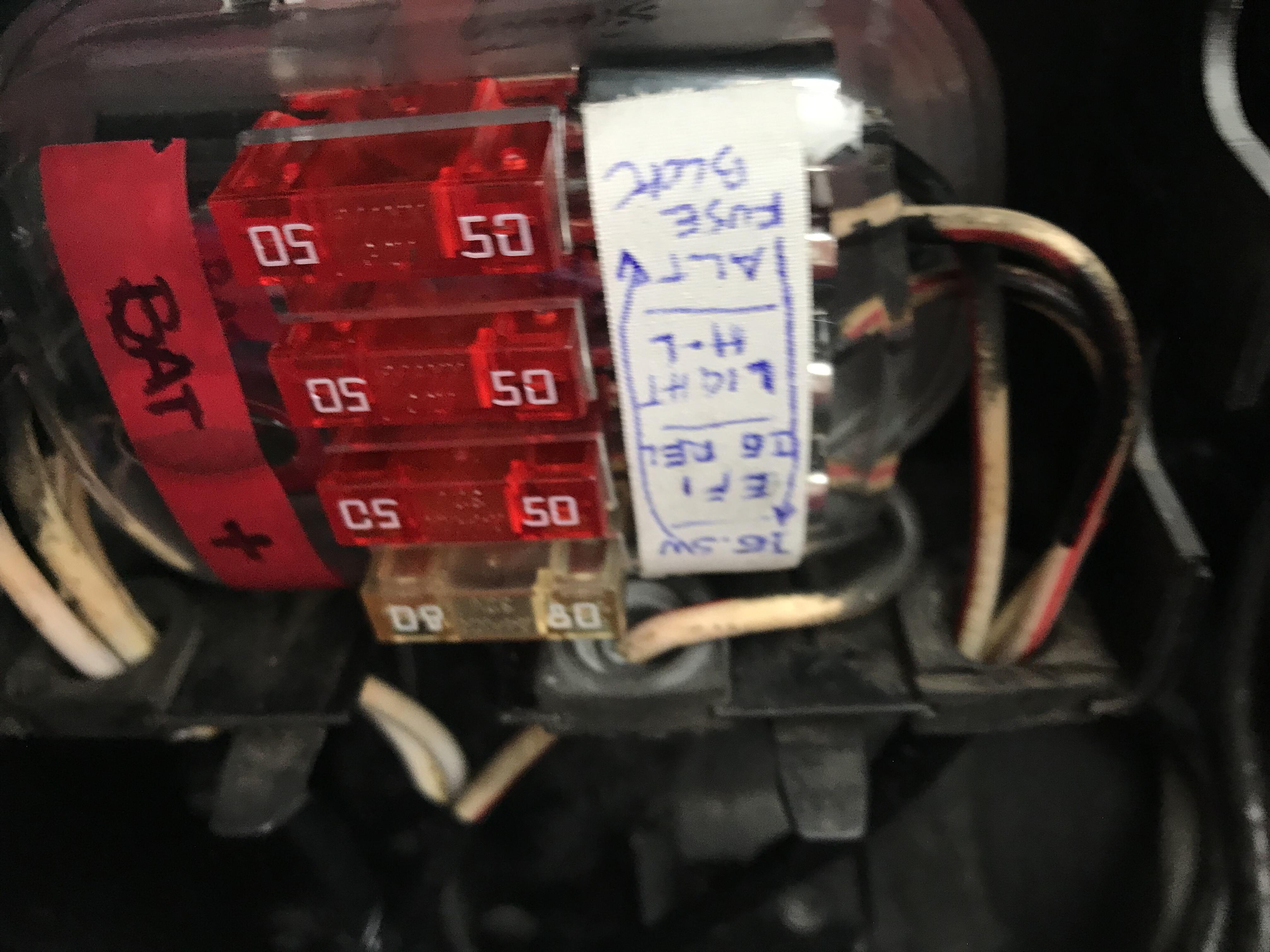

This is an old topic tread I wonder if anybody will still see it. All the info resulted very informative and useful to start the upgrade of the fuse links for amore modern version.
Anyhow, I just have a question. I replaced the fuse links with the Maxi fuse version and respective fuse-bracket. This involved -only- cutting the four supply cables (white) and the lead cables with the power to the different control functions (white-red) and reconnecting them in the bracket. This is the only change I did.
I have voltage signal before and after the new fuses, so all fine. The detail now is that the Amp light in the dashboard does not work and no voltage is measures (also the fuel gauge is dead). The engine cranks but does not start.
in view do the simple replacement I did all the rest should work but now something obviously is not right.
I would appreciate an indication of something that I might not have considered.  See picture of current install.
All worked fine and battery was disconnected. The issues I was trying to solve was faulty contacts for headlights and a stutter (electric failure just above 65mph that will stop after reducing power). All worked fine but these details
Edited by DHA280Z
