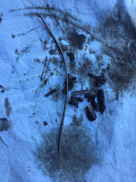

May 8, 20196 yr Author comment_575024 Any ideas what this little gem is. It's made of steel, and was found in my oil pan? Link to comment https://www.classiczcars.com/forums/topic/61554-ive-been-looking-for-a-project/?&page=16#findComment-575024 Share on other sites More sharing options...

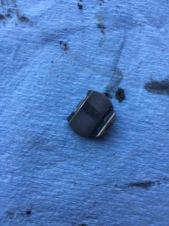

May 8, 20196 yr Author comment_575025 This was also found in my oil pan. Looks like one of the seals? Link to comment https://www.classiczcars.com/forums/topic/61554-ive-been-looking-for-a-project/?&page=16#findComment-575025 Share on other sites More sharing options...

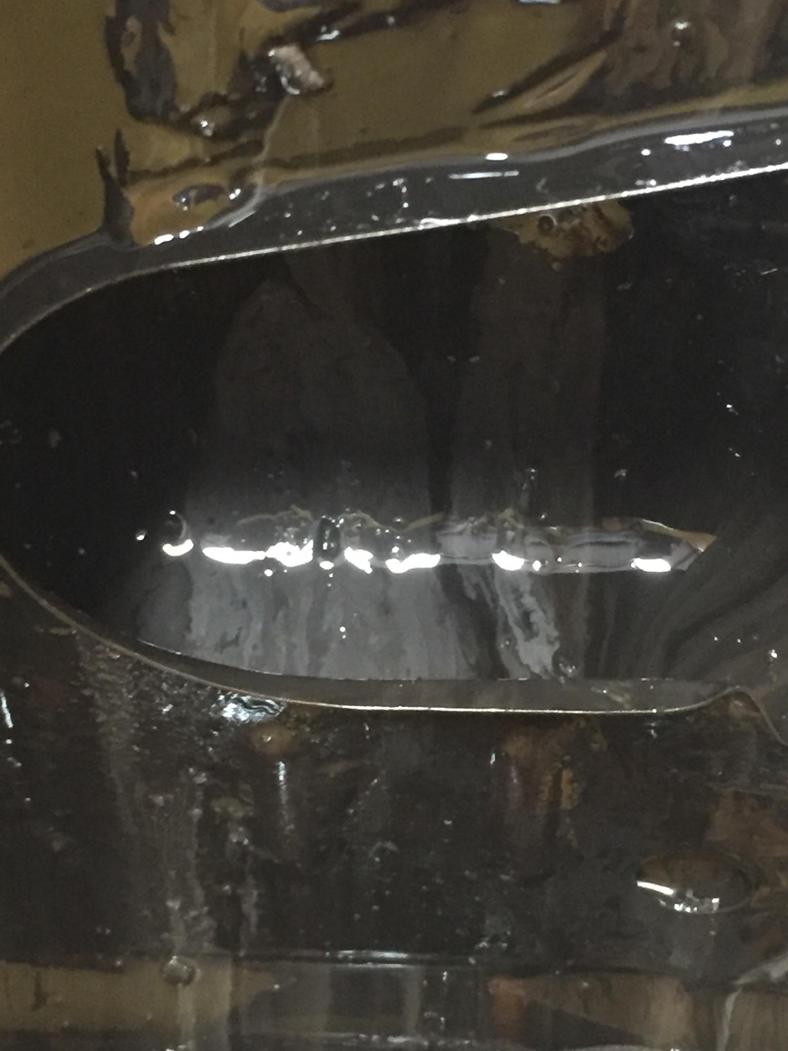

May 8, 20196 yr Author comment_575026 The sludge in the bottom of my oil pan has a silver tint to it, is this an indicator of anything I should be concerned with ? Link to comment https://www.classiczcars.com/forums/topic/61554-ive-been-looking-for-a-project/?&page=16#findComment-575026 Share on other sites More sharing options...
May 8, 20196 yr comment_575027 The first looks like a valve lash cap. Silver is bad!!!! Put a manet in that and see what happens. The last time I had a similar situation, I destroyed a camshaft. Might be bearing material though... Link to comment https://www.classiczcars.com/forums/topic/61554-ive-been-looking-for-a-project/?&page=16#findComment-575027 Share on other sites More sharing options...
May 8, 20196 yr Author comment_575028 5 minutes ago, Patcon said: The first looks like a valve lash cap. Silver is bad!!!! Put a manet in that and see what happens. The last time I had a similar situation, I destroyed a camshaft. Might be bearing material though... I had a magnet in the oil pan. That spring thing from the seal, and that other piece are all it picked up. Link to comment https://www.classiczcars.com/forums/topic/61554-ive-been-looking-for-a-project/?&page=16#findComment-575028 Share on other sites More sharing options...
May 8, 20196 yr comment_575035 Perhaps the PO put some sort of "engine restore" substance in it. I've never used anything of the sort, so I'm not sure what it looks like, except for the types in clear containers sitting on the shelves at auto parts stores. They look to have some metallic qualities. Link to comment https://www.classiczcars.com/forums/topic/61554-ive-been-looking-for-a-project/?&page=16#findComment-575035 Share on other sites More sharing options...
May 8, 20196 yr comment_575036 It looks like ground up aluminum. I bought an old mystery transmission, filled it up with some old fluid and spun it on the back of my garage engine. The fluid looked like that when it came out. Ground up shift fork. With the lash pad, the seal material, and the silver, kind of looks like a camshaft might have damaged itself in the past. The camshaft tower bushing journals are aluminum. The cam rides right on the tower material. Lots of aluminum in other places too that could get rubbed on. Link to comment https://www.classiczcars.com/forums/topic/61554-ive-been-looking-for-a-project/?&page=16#findComment-575036 Share on other sites More sharing options...
May 8, 20196 yr comment_575037 plastic parts look like timing chain guide spring is from a crank seal most likely. Link to comment https://www.classiczcars.com/forums/topic/61554-ive-been-looking-for-a-project/?&page=16#findComment-575037 Share on other sites More sharing options...
May 8, 20196 yr Author comment_575038 1 minute ago, Zed Head said: It looks like ground up aluminum. I bought an old mystery transmission, filled it up with some old fluid and spun it on the back of my garage engine. The fluid looked like that when it came out. Ground up shift fork. With the lash pad, the seal material, and the silver, kind of looks like a camshaft might have damaged itself in the past. The camshaft tower bushing journals are aluminum. The cam rides right on the tower material. Lots of aluminum in other places too that could get rubbed on. Are you sure that's a lash pad? Link to comment https://www.classiczcars.com/forums/topic/61554-ive-been-looking-for-a-project/?&page=16#findComment-575038 Share on other sites More sharing options...
