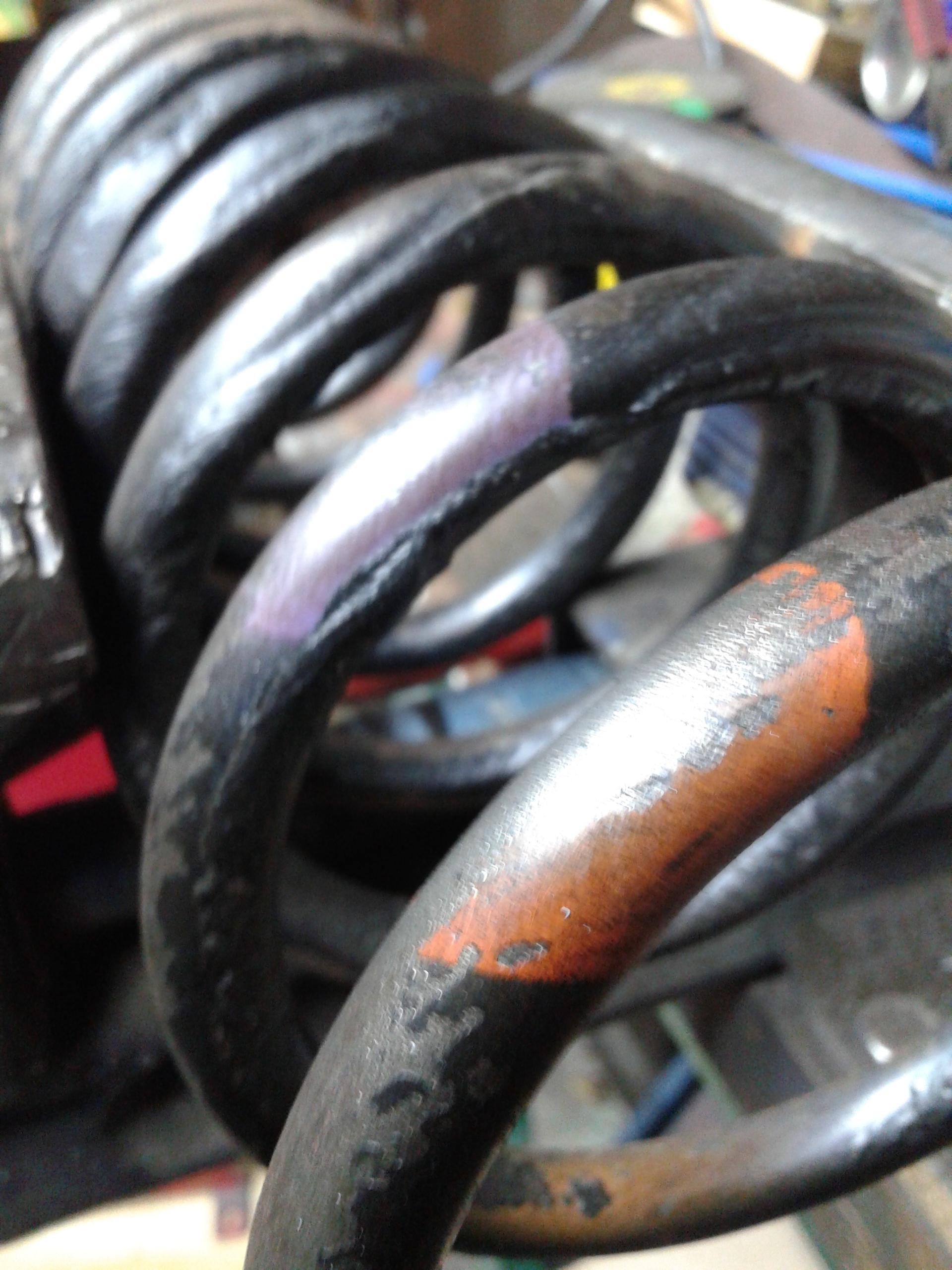

Also a pic from the spring of my 280zx.. it has 2 spots on it, orange and purple.. i guess it's a way to mark how strong they are?

I have no info on your spring pic because it has no KONI connection.  They could be either OE or some aftermarket springs but they are not a KONI spring that I have heard reference to in my 20+ years here.  KONI has dabbled off and on over the decades with selling damper & spring combo packages, more in the USA than in Europe.
