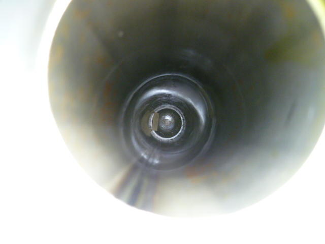

I recently stripped down a pair of strut tubes and I took this pic down the tube. With the right reflected light, you can get a decent look down there. Enough to see the center portion convex outward and the weld bead around the perimeter of the dome:
So any idea how much interference you have? Is it something that you could "workaround" by chamfering the bottom corner of the strut body? Take a little material off the OD at the bottom? Just a little? Maybe? Without creating a weak spot and blowing out the strut on rapid compression?

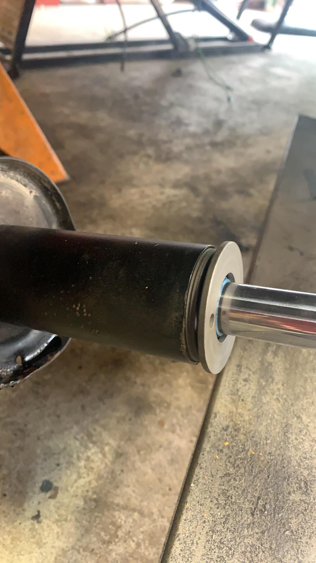

So disappointed that the modified gland nuts do not get the job done . Even modified I only have 1-1/2 turns on the gland nut . Still showing 6mm of nut . They only machined off 2mm when they should have done 4.
Called MSA - and it’s basically my problem . It’s my fault that the strut tube has a factory weld bead at the bottom . I could somehow grind the weld down at the bottom of the tube - yeah . So these modified glands are not a guarantee that these will fit your early Z . My car being a 9/71 isn’t that early - but early enough I guess . Now I get to pay a machinist to modify the modified gland nuts that are supposed to fit my year car - woohoo.
Not much sympathy from MSA , they just sell the shocks .

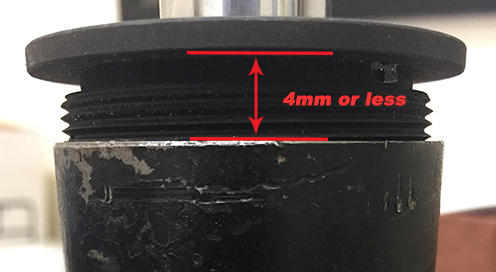

2. Before I (and/or Lee) respond to the rest, I need to confirm that the image you included is torqued down; and using the diagram I included below, you're saying on that strut the same gap is 6mm? It is hard (for me anyway) to tell from your image.
3. Well over 90% of the 240Z's, including many 70-71's, have been within the 4mm gap tolerance with the original gland nut. So far, of the very few single digit numbers of anomalies we've heard of, the modified KONI gland nut has brought the gap back into their prescribed tolerance of 4mm just fine. Yours would be the first to not be solved.
4. Please do not grind anything until I (and/or Lee) get back to you.
Thank you for your patience.

Yes my measurement was 6mm. Looking at the pic you provided is not representative of a properly torqued nut . If it is the same as what I was provided them the diagram is showing a nut with 1 thread engaged. My nut Has only 4.5 threads . To get to 4mm after torquing ,  there would only be about 2 threads at most showing .

Definitely not 4mm in my image. Just made that to be clear and confirm to everybody what the measurement was supposed to be measured from and to. I think Lee may be back but I'm sure is trying to unbury himself. I hope to get some confirmation before the end of the day (I'll try anyway).
