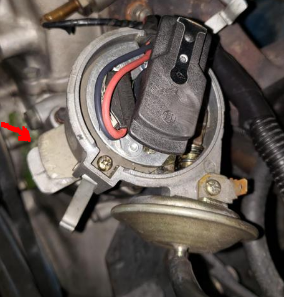

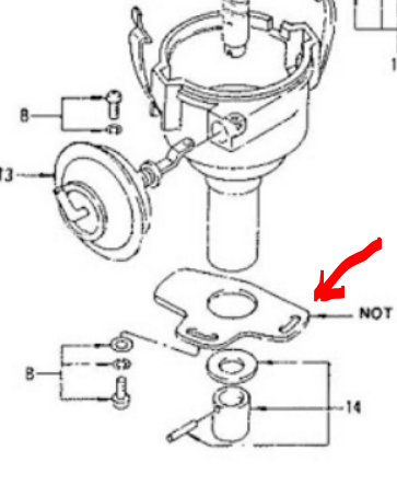

September 16, 20186 yr comment_557637 I have some fun for us all though. I'm not positive but I think that somebody has installed the plate on the bottom of the distributor backwards or sideways. Not even sure how the distributor is clamped down to avoid rotation when the engine is running. Might explain many past problems. Where is the screw? Link to comment https://www.classiczcars.com/forums/topic/60753-tempted-on-removing-cleaning-and-reinstalling-hitachi-original-distributor-on-my-240z/?&page=2#findComment-557637 Share on other sites More sharing options...

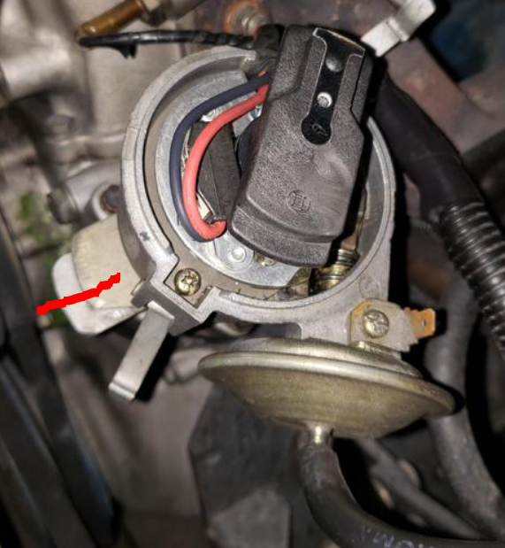

September 16, 20186 yr comment_557644 9 minutes ago, Zed Head said: However you look at it, he does have a new different problem that he should fix. If his distributor is not locked own, his timing is going to walk eventually. I might be wrong about his problem though. In that picture I expected to see the locking screw. Maybe the 240's have it on the other side, and adjustment marks on the side I see. Should be where the red arrow points. Link to comment https://www.classiczcars.com/forums/topic/60753-tempted-on-removing-cleaning-and-reinstalling-hitachi-original-distributor-on-my-240z/?&page=2#findComment-557644 Share on other sites More sharing options...

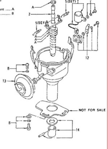

September 16, 20186 yr comment_557645 Here's a 280Z. So, I had it backward. Link to comment https://www.classiczcars.com/forums/topic/60753-tempted-on-removing-cleaning-and-reinstalling-hitachi-original-distributor-on-my-240z/?&page=2#findComment-557645 Share on other sites More sharing options...
September 16, 20186 yr comment_557646 Mark the distributor here, remove the screw on the other side, pull the distributor straight up. Not the screw pointing upward, but the screw you can see from the top. Edited September 16, 20186 yr by Zed Head Link to comment https://www.classiczcars.com/forums/topic/60753-tempted-on-removing-cleaning-and-reinstalling-hitachi-original-distributor-on-my-240z/?&page=2#findComment-557646 Share on other sites More sharing options...
