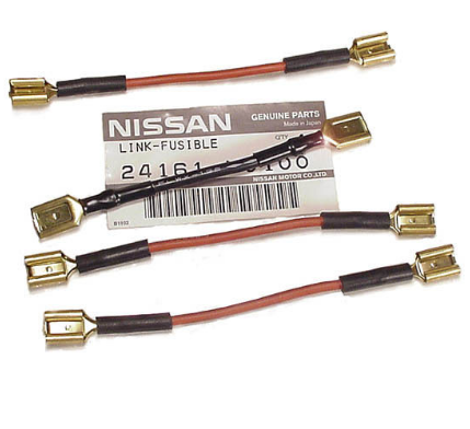

Those are your fusible links, they take a little longer to blow than a standard fuse.
Guys - anyone know if there is an aftermarket replacement and what is the AMP capacity for each?
Thanks.
MSA or zcar depot will have, they are color coded for amperage. the main thing is they do not flame up when the burn out. So you cant really tell if they are bad by looking at them.
the colors maybe on the plastic caps I don't remember. but if not pretty sure the FSM cover the color code as well.
1 hour ago, MH77280Z said:
My car does not have these caps, instead under each there are 4 terminals. Mine are jumped together.
Should have posted a picture of what you're calling "jumped together" on your car, not someone else's fusible link covers.  The fusible links look like jumper wires.  Yours might be fine.
Stole this from an eBay ad...
Correct sir - thanks.
